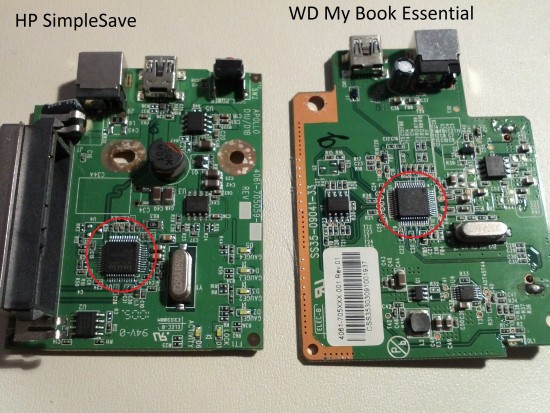

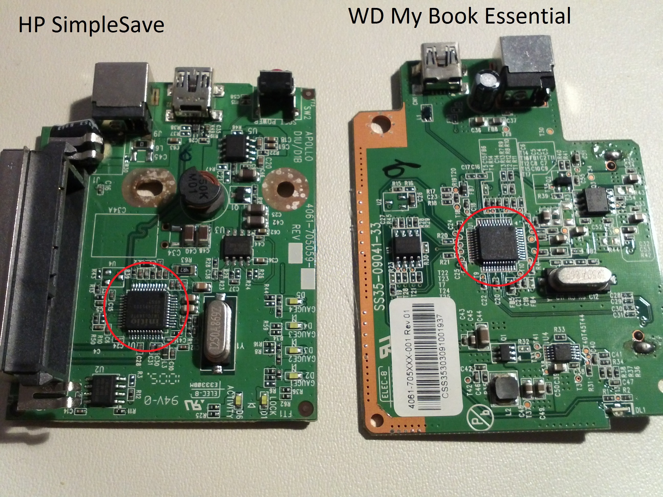

Here's a pic I just took of a bridge board from a WD My Book Essential (left) and a bridge board from a HP SimpleSave (right). The circled ICs are both Initio INIC-1607E.
So, the same applies to the SimpleSave that applies to the My Book, you can't just remove the HDD and connect it up and access the data as it's encrypted, you need to access the drive via the Initio IC.

Ugh, I put the wrong names on the wrong sides in the image. Doesn't matter though, you get the point ;)

There was recent thread where a WD Passport Elements model that used the INIC-1607E chip was not encrypted, so the presence of AES encryption in the bridge chip does not necessarily mean that it is enabled.
Here is a thread where a HP Simplesave owner converted his drive to a WD model:
disk-with-sata-usb-adapter-remove-virtual-rom-t18492-40.html
In that particular case the data were of no consequence, so it is not something that you should do. Nevertheless the exercise shows that the two devices are essentially the same.
If you decide to swap the board, then you may need to transfer the firmware from the original bridge board to your replacement board. On Nick_CT's photo, there appears to be an 8-pin Winbond serial flash memory IC at the left side of the PCB, below the "SS35-09041-33" text.
