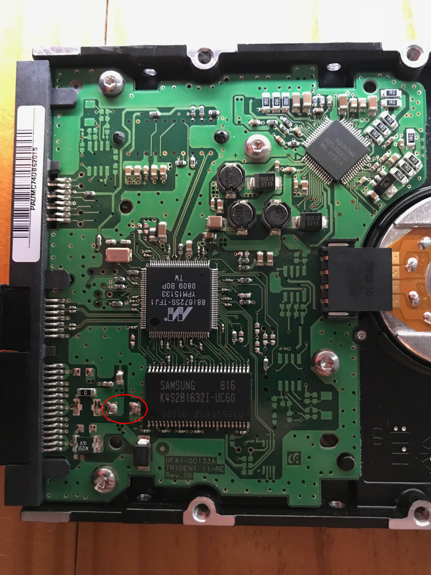

Hi all,
I'm new to this forum and a total noob when it comes to HDD repair, so please assume I have no idea what I'm talking about... :P
I have been attempting to DIY repair the above HDD after it failed due to me swapping the computer's power supply and leaving in place the SATA power cables of the old supply. From what I have been able to establish, this has caused the 12V TVS diode (?) to burn out. I have removed the offending part and was able to partially recover some of the data on the drive.
However, the drive is displaying some weird behaviour, which makes a full recovery of the data on the drive a game of chance:
The drive will come online only after a random amount of time of being connected to the PC. A quick restart will make the drive discoverable and accessible, and I am able to copy some of the data across to a new drive.
But it will drop again after 3 seconds, or 1 minute, or 10 minutes and then sit there and not spin up for another random amount of time.
I suppose I could keep on playing this game until I have a complete set of data, but is there anything that might make this process a little more reliable?
Any suggestions would be very much appreciated.
Cheers.
File comment: Removed Diode

At least the removal of the TVS seems clear.
BattleXer, the picture is of your own board, isn´t it, or is it from another disk ?
In the case you removed the board from the disk to unsolder the TVS diode, did you clean the contacts in the back side ? Inspect that again, and clear them just in case.
Now, are you connecting the disk to an internal SATA port of your computer, or using
an USB adapter ?
You have removed the 5V TVS diode. This is consistent with an overvoltage on the +5V input. Therefore there may be some concern as to the state of the preamp inside the HDA. Perhaps it was stressed?
So the drive spins down during read access?
I agree with @rogfanther -- try to clean up the corrosion at the HDA contacts with a soft white pencil eraser. Don't rub too hard. Also measure the voltage at the TVS diode pad. Is it right on +5V, or is it a little low?
Yeah it's a photo from my own board. I did not remove the PCB when I removed the diode.
So not sure about the condition of the ports on the other side.
I had the drive connected to an internal SATA port and power, which is confirmed good, running another drive without issues.
Yes, the drive would just spin sown randomly as if it lost all power and become unavailable.
