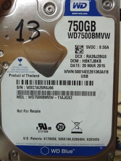

I have the hard drive that I have put in the photo.
I do not know the firmware that it carries nor the family of hard disk that it is.
I have the mrtlab and it does not detect it with a sata card.
I changed the heads and they work well.
Can somebody help me. Thank you.
File comment: Image of HDD

Isolate the pcb, let it come RDY, start the utility in kernel mode and you can see the family. Block SA access. Restate the drive, us a leader. Start utility in normal mode and see if you can get SA access to solve issues.
 Post subject: Re: Problem wd7500bmvw-11ajgs2
PostPosted: July 1st, 2018, 8:37
Posts: 849
It's FBLITE family.
PostPosted: July 1st, 2018, 9:34
Posts: 1742
BGman wrote:
It's FBLITE family.
+1
FBLITE with 4 heads with one isolated head.
@OP: what was the initial problem?

Thank you very much to all for your help, with which I have verified that the family is fblite as you have told me and I have learned a very important thing isolating the motherboard and detecting in kernel mode the family.
I have obtained the following information with the isolated PCB.
Technology mode key : ..........................: OK
RAM:
Read HDD Info : ................................: OK
Heads number : .................................: 1
Head map : .....................................: 7
SA Cyl Count : .................................: 256
Serials Mark : .................................: 0xFE16
Control version : ..............................: A5C0
ROM:
Read Rom Infos : ...............................: OK
ROM Data Size : ................................: 256 Kb
ROM version : ..................................: 16.56H
ROM generation : ...............................: 16.56H
Link table version : ...........................: N0.38
ROM Firmware version : .........................: 00160056
ROM Modules:
Flash ROM dir reading : ........................: OK
Switched off heads : ...........................: Yes
Heads number : .................................: 0x4
Heads number in use : ..........................: 0x3
heads map : ....................................: 0,1,2
The initial problem of the disc was a blow while it worked. The heads are fine, I've tried them on another disk and they work, but the plates are a little marked just outside.
