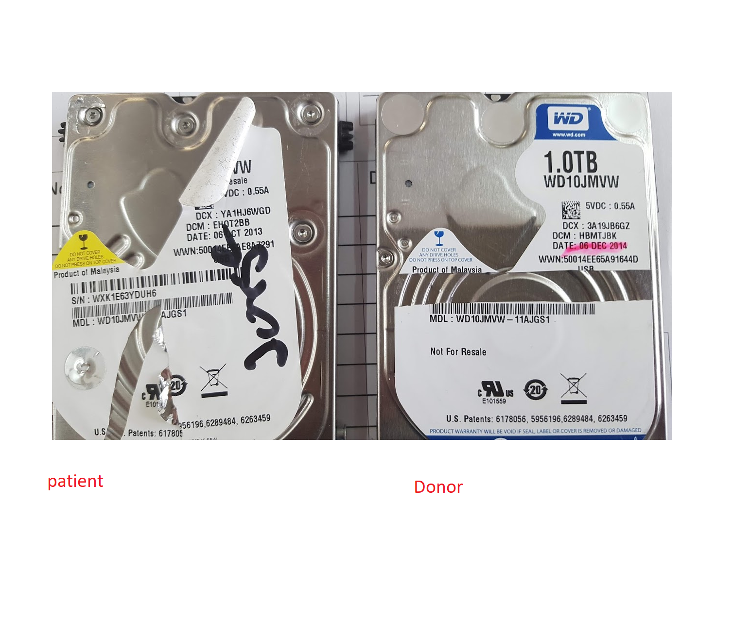

I got a 1TB WD here WD10JMVW-11AJGS1 with DCM EHOT2BB. I ordered a donor and they send me one with full model name match WD10JMVW-11AJGS1 but DCM is way off in my opinion.
damaged drive dcm
EHOT2BB
WD10JMVW-11AJGS1
donor drive dcm
HBMTJBK
WD10JMVW-11AJGS1
They say: DCM T2 amd TJ have same preamp and vendor. Please checkt the preamp and vendor revision. This HDD is 100% compatible for heads to your.
Can somebody confirm they are correct I normally go by model and 4th + 5th match in DCM.

Should be OK
I'm not so sure about that part
or should I say
most likely they are different
 Post subject: Re: WD 1TB Mypassport head replacement
PostPosted: July 9th, 2018, 10:20
Are they from the same country? I've found that different countries may not use the same numbering for preamp vendor and revision. So even if they read out the same in PC-3000 they might not be compatible if one is from Thailand and the other is from Malaysia (for example).

Hello ,
Please Tell me how did they check preamp in patient ,Was it partially initialised and then they checked the preamp ? .

Nope they didn't. I contacted and gave them model number and dcm and other values. They said they have exact match and than they send me this I post a picture in a second

IMHO those are not a match.

+1 match

To cut it short: if you backed up patient ROM then transfer Donor ROM to patient PCB and if the donor identifies and working well then I believe that they are matched.

I have no issues here copying rom over etc... but before I swap heads and it doesn't work they will argue i fucked it up and i cant return it.

Given that it's well over a year off on the manufacture date, and the DCM doesn't match, I'd say it's like a 30% chance it'll work. Unfortunately, spending money on donors that don't work out is all part of this business. I probably ruin three of four drives in a typical week that don't turn out to be compatible. Sometimes it's because the case is an emergency and I've having to try drives that only "might" work, other times they should be compatible and just arent. I alway bill my client for the first donor, but I've averaged the price of a second one into my pricing tiers so I don't lose money if the first one doesn't work out.
This is why you can't do legitimate data recovery work for peanuts. You've got to bill a fair amount or you'll end up losing money.

for WD10JMVW-11AJGS0 & WD10JMVW-11AJGS1 white label drives there is another criteria for head swap apart from DCM, have wasted many donors to rule this out. Now every time head swap on these drives works as a charm.
