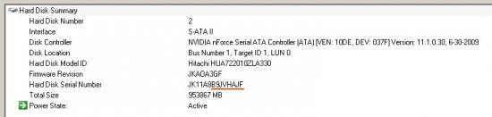

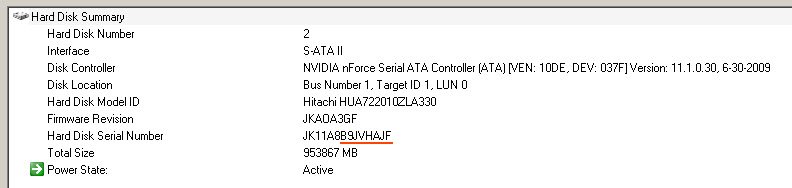

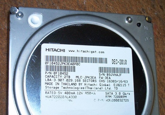

I'm just starting to venture into advanced HDD repair and need to know what has to be done to this drive.
I have a Hitachi 2TB SATA Desktop drive model# HUA722020ALA330 but the test/repair software I use sees it as a 1TB HUA722010ZLA.
Was the disc labeled wrong at the factory or did something happen to the firmware ???
Rookie followup question ... how do I flash proper firmware onto it so it becomes the 2TB drive as labeled ??

"Most likely your tool is misdetecting the drive model." <-- unfortunately, no ... the motherboard sees it as a 1TB drive so the software does too.

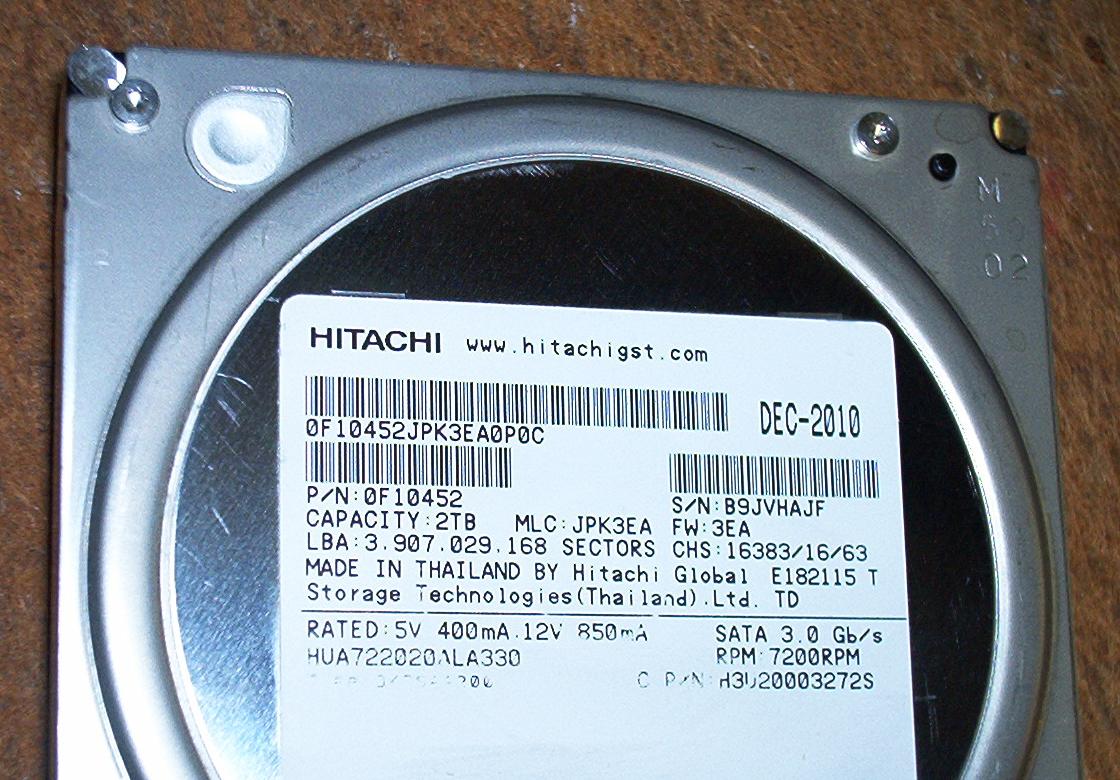

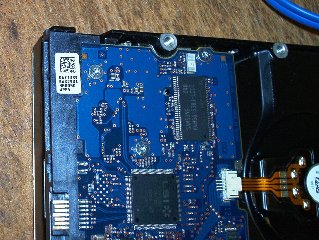

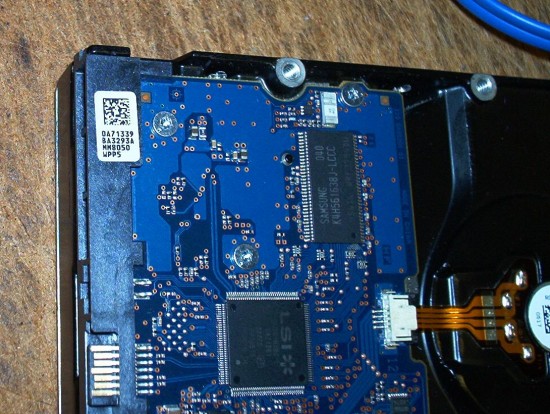

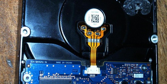

Please post good pics of the labels of the disk and of the pcb.

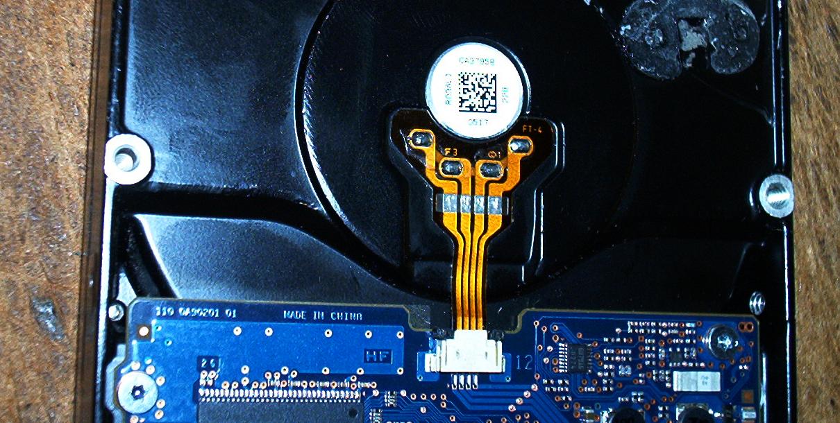

OK rogfanther ... posted 4 pics for you.
software reads correct serial number so it looks like card is the original.
also ... did some quick searching on ebay for similar drive ... all card numbers are correct for a 2TB drive.
one other thing ... when I attempted to do a zero fill, instead of getting something in the neighborhood of 50MB/s all I got was 6MB/s so this drive definitely has issues.
