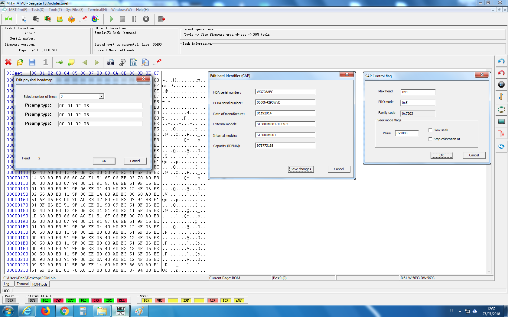

is this just corrupted ROM, Happened, or its sabotaged deliberately ?

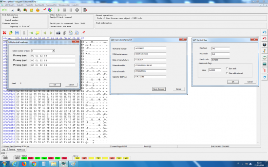

Why do you think is corrupted?
It doesn't seem to be corrupted...
see from 0xD0000 up to 0xD975B

It looks deliberate to me. At least the adaptives appear to be untouched, but who knows?

Does the drive spin up ?
Do you hear any noise ?
Did you check if ROM chip is original or if something different?
Check this old post, it was a deliberate sabotage!
viewtopic.php?f=1&t=29113
thanks
here you've one to compare
ROM2Compare.zip [661.9 KiB]
Downloaded 329 times
Patch the patient ROM and try it?
