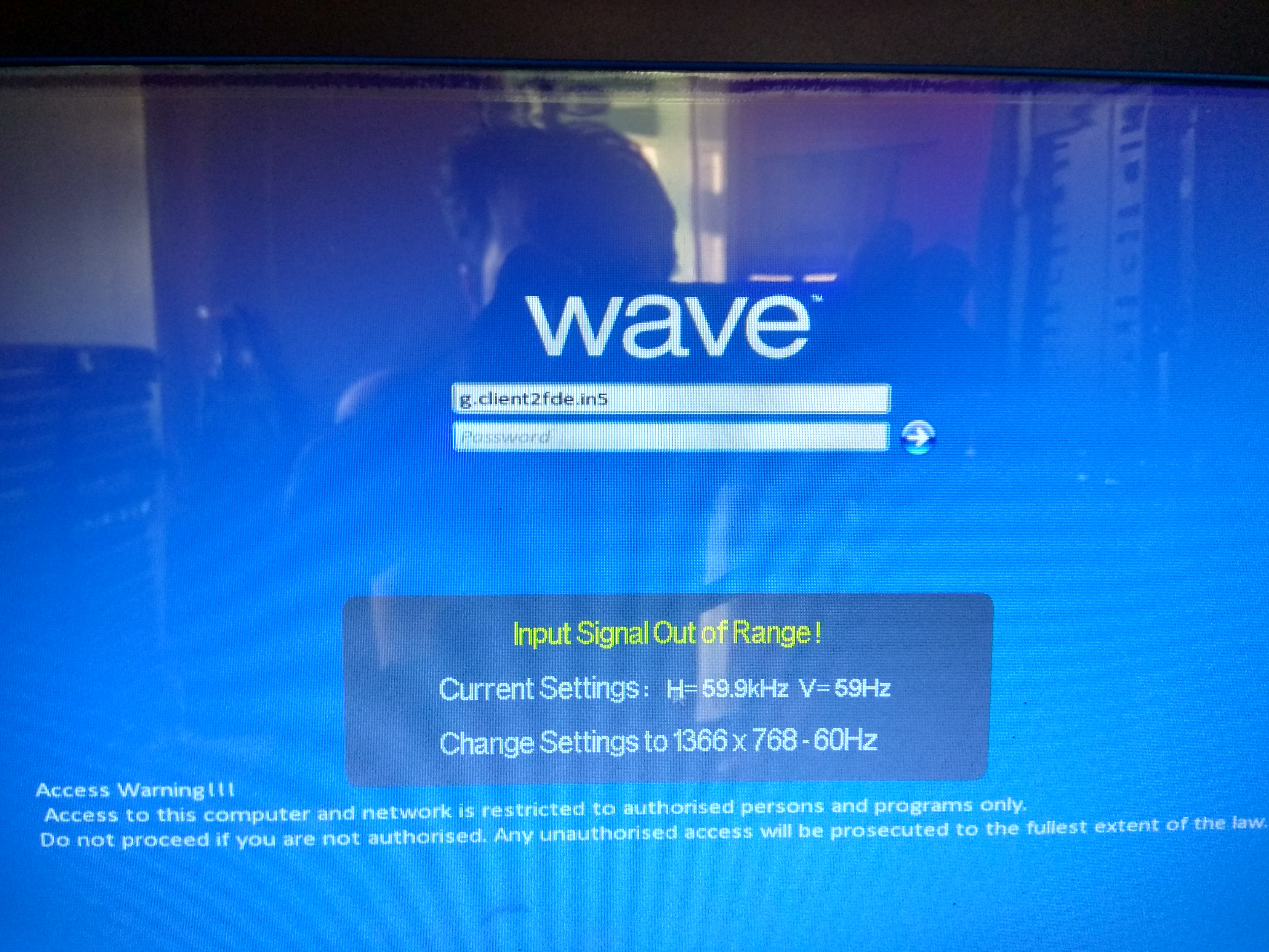

Recently, i came across a seagate Thin 500GB hdd which when connected with mobo shows the attached screen.
Friends, suggest ways to format/reinitialise the hdd for reuse, data not at all relevant.
File comment: Locked screen

i should bot with a secondary drive with xp & mhdd and the 500gb is detected.
please clearly tell what to do next.... i have tried what u said....... but but........ next stepssss..............

""Just boot another windows XP 32 bit with Victoria, let it load. When done plug drive to sata + power, detect with victoria. Does it have ATA password ? If not use security erase or victoria option to write to drive sectors or whatever ...""
Next i used victoria..........
Do not understand which sector to write.......
Can you help?????

I assume the OP searched this forum for similar cases and came up with this thread:
http://forum.hddguru.com/viewtopic.php?f=10&t=29783
I knew I had seen it before, so adding it in case it is helpful (I didn't go read it).
you might be able to troll the wayback machine for wave's help & support pages:
https://web.archive.org/web/20130401061448/http://www.wave.com/support/self-encrypting-drive-tab-missing-access
not sure if this "wave embassy" stuff is the same as what you are dealing with:
http://forum.hddguru.com/viewtopic.php?f=1&t=35407&p=247817&hilit=wave#p247817
I remember some versions of Wave used TPM chip to send encrypted password to SED, but older versions probably not. I would be destroying the drive and forgetting about it, it has to be quite old anyways

why cant he just add the drive to a win10 machine for example, and:
>cmd
>diskpart
>list disk
>sel disk x (whatever the correct disk is)
>clean
> format.. etc etc

The drive is laptop thin hdd 500gb Model st500lm0024 p/n 1rs152-030
