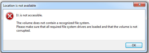

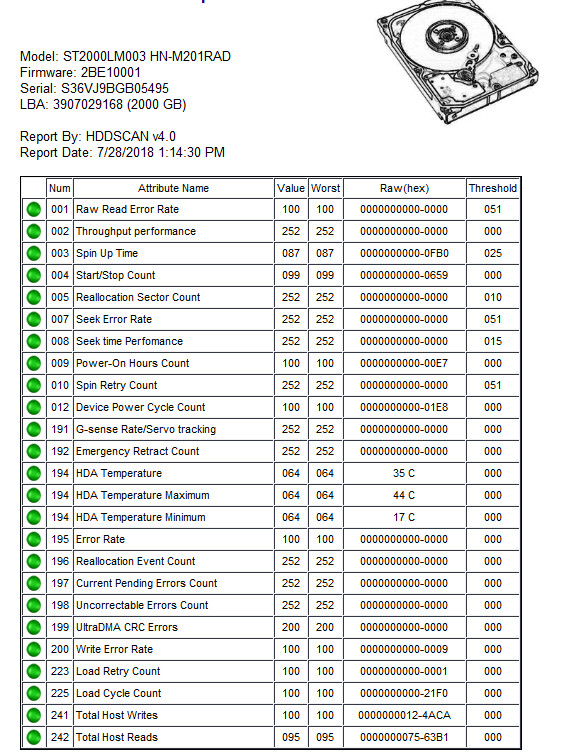

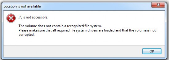

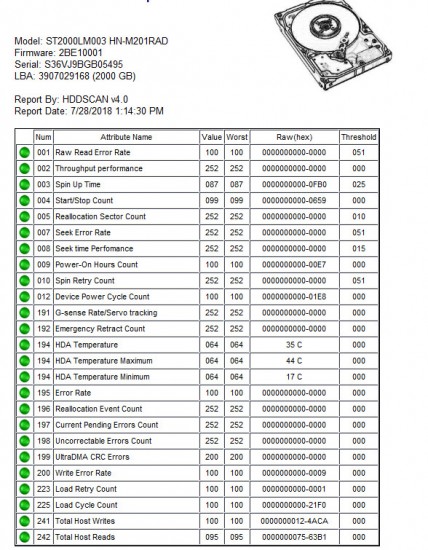

I was trying burn a windows iso file into a flash , I had windows installation files on my HDD and ran the iso burner from HDD
but in the drive choosing Section I forgot to change the target drive from HDD itself to USB! I clicked next and process came up with an error right away.

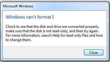

I know it did not format anything cause it gave me an error in splitsecond and now when I connect the HDD it prompts the formatting screen and when I choose format :roll: it says windows can't format Drive and the drive type is now Raw.
my 2TB SiliconPower was almost full (200GB left of it) there were all types of data in it and I really need it.

Spildit wrote:
Take the drive to a reputable data recovery firm ?
If the data was not over-written and if the problem is with just a damaged MBR or partition it should still be possible to safely extract your data ....
Agree!
Unless you tinker with it more, it should be recoverable.
If you want to take DIY route, run DMDE and scan the affected drive with it.

Looks like an easy software corruption judging from the circumstances of the failure. Try recovering with R-Studio, if it doesn't work, ask for the recommendations here for a data recovery center to visit around you.

ISTM that DMDE should find the data within a minute or so.
