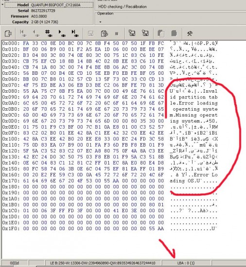

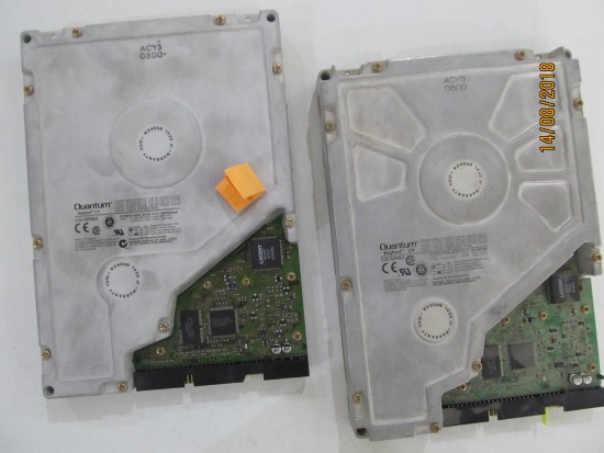

Well this sounds really funny but i really encourage you guys to try it..
Try to connect any of those bigfoot drives to your 3k, ddi, or any other tool you have and try to access sectors
really funny
Image attached, 2 drives here , one of them is mine the other is for my client (both working)
This is real case AM NOT JOKING
give it a shot.

It has been mentioned before that some of the popular hardware imagers (including pc3k, maybe some versions work and some don't) do not work well with old C/H/S drives that do not support LBA. I am guessing from the labels the drives in question do not support LBA. Slight oversight on their part not to include support for the older standard. Hook them up to a computer with the native PATA/IDE port, the computer does not have to be old, and then boot from a Linux Live CD to access the data. If there are bad sectors, recent versions of HDDSuperClone should be able to handle the C/H/S for cloning. It is amazing that some of the high priced hardware tools have a problem with those older drives, but yet they can be accessed from a simple Linux Live CD (XP might work too) :)

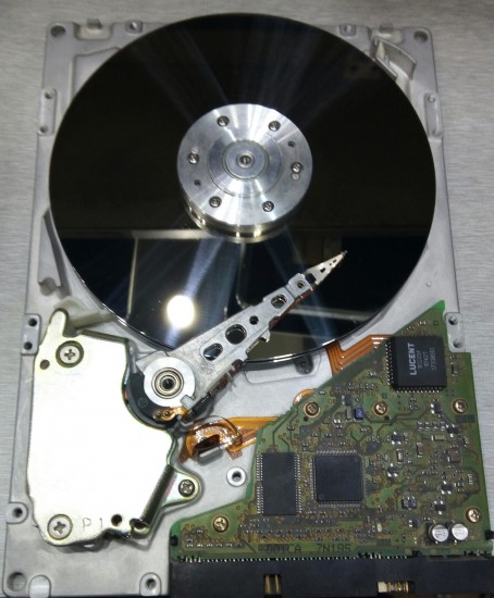

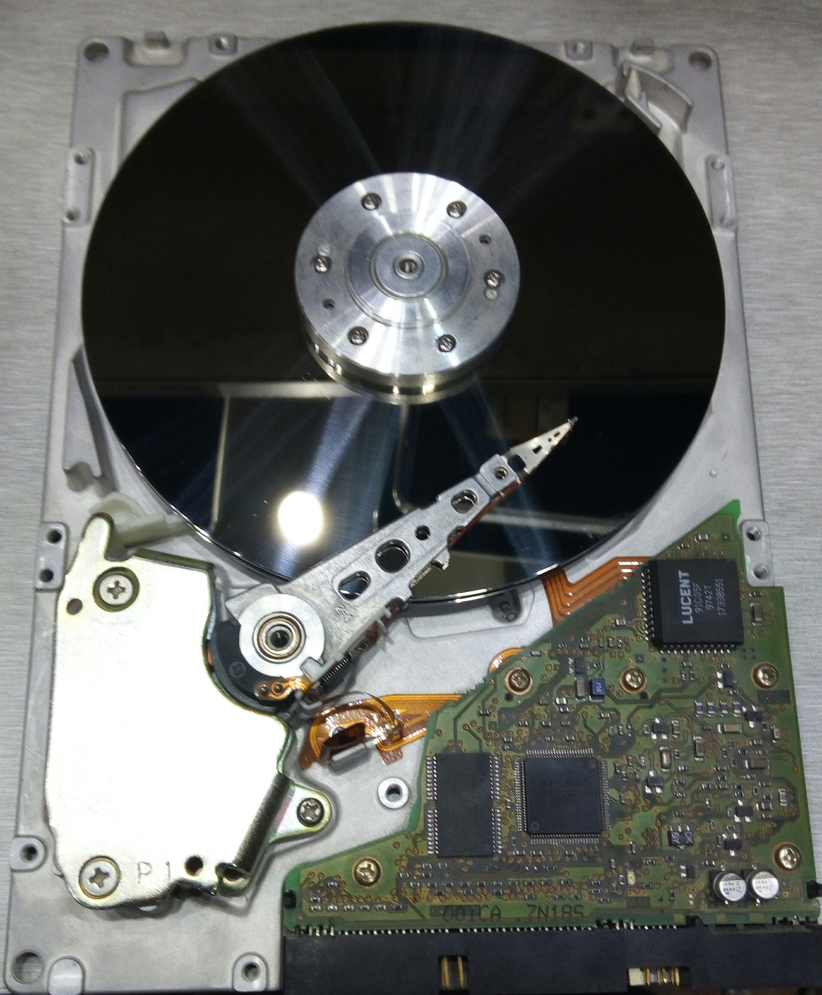

I like those drives. :D

Really? i tried almost everything with both drives DDI ID the drive slow but did not read/access any sector no matter what i do
data-medics wrote:
PC-3000 works fine with old C/H/S drives in my experience. I've gone as low as 400Mb drives.
You just have to know how to set up the CHS for it to work. And, for awhile the menu was a bit hidden and not obvious to find. The first time I had to do it, it took hours to figure out how to configure it for CHS. Now they've made it much more obvious where to set it up.
Tried that did not work in fact did not read ID in DE (would u like to try it here?)
My Quantom am sure its working 4gb, i used it long time for me and 100% works,
the client hdd is giving the same symptoms as mine (so am assuming both are OK) its just the PIO reading more
btw, for you Luke & data-medics, i was able to access sectors (but no data at all) not even raw, looks like data been shifted or something or reading wrong/errors i dono
never had similar case before.

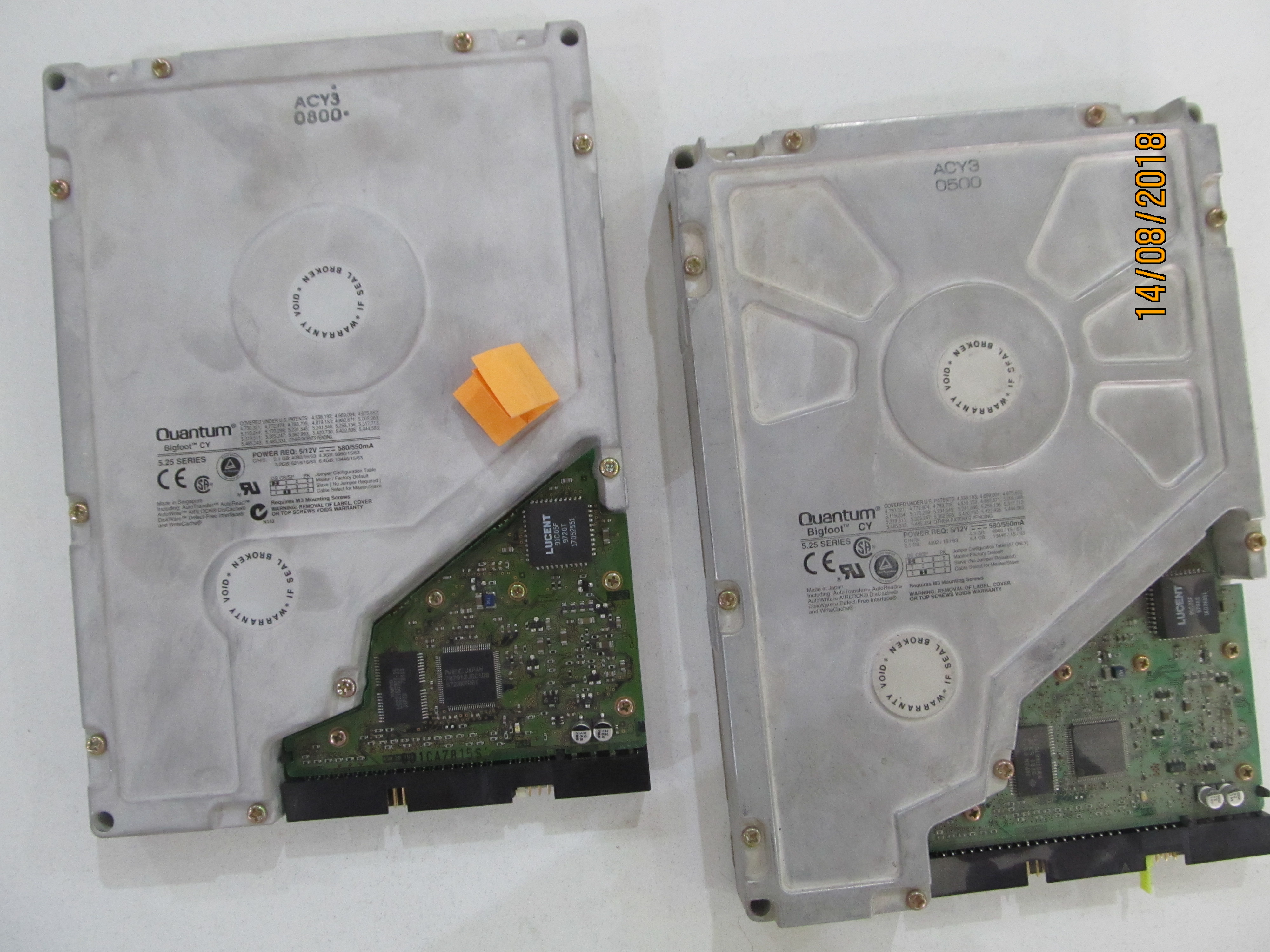

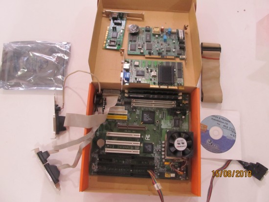

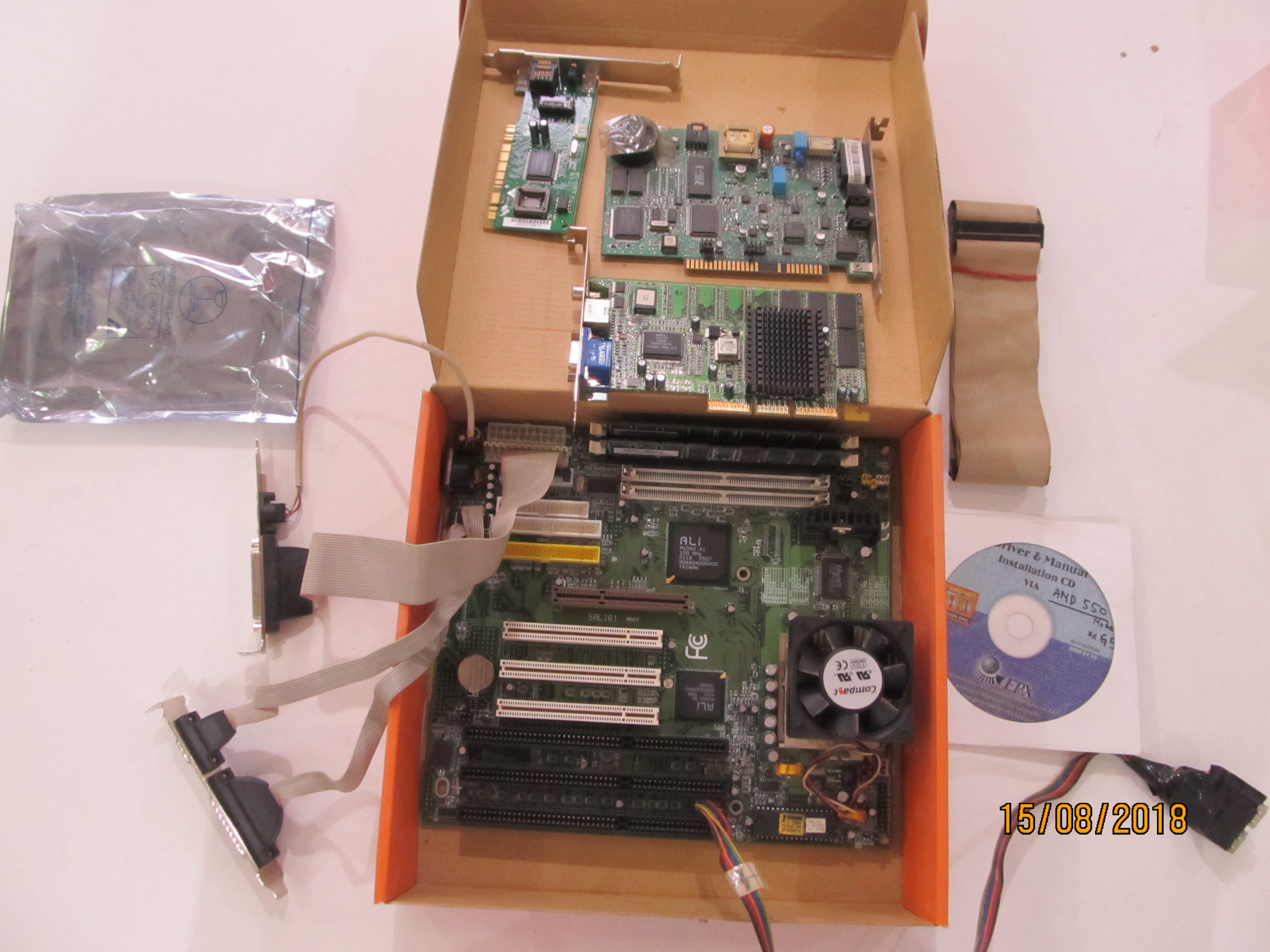

forgot to add, Believe it or not i had to try my very old pc with those drives just to verify and know where the hell is the problem
do not feel shocked while looking @ this..
Am keeping my lovely 486 DX AST PC (https://www.instagram.com/p/BN2qbw_lVQY ... tarecovery)
just to remember those old days...
:mrgreen:

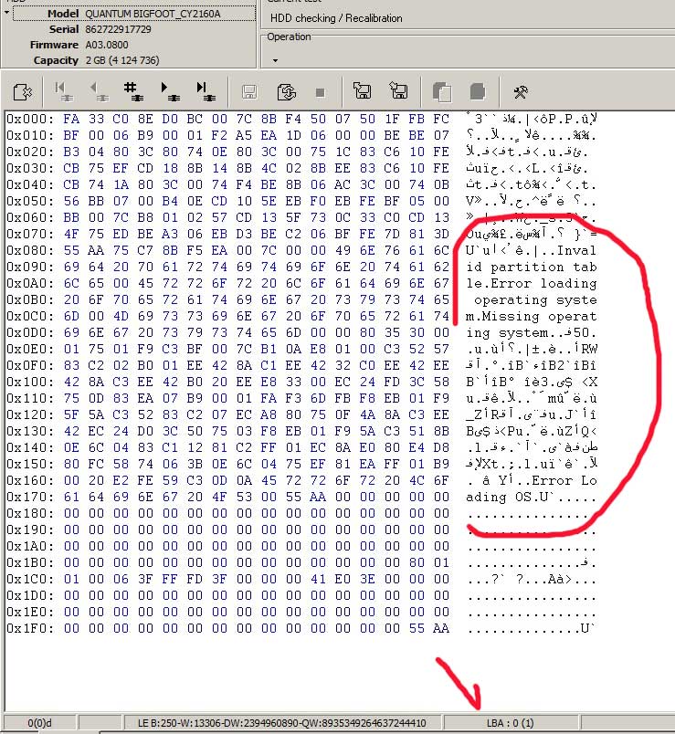

 Post subject: Re: Quantom Drives
PostPosted: August 15th, 2018, 18:40
Posts: 992
That is a sign that the software is trying to read LBA and not CHS. A dead giveaway would be that you can't read sector 0, but you can read sector 1 and it looks like it should be sector 0.
http://www.hddsuperclone.com
Home of HDDSuperClone
PostPosted: August 16th, 2018, 2:38
Posts: 2857
I can
the Q is why universal and not DE?

einstein9 wrote:
I can
That would be a question to ask of the manufacturer support of the tool(s) that are unable to properly read the drives. You paid good money for those tools, so hopefully their support would be able to answer. All I can do is offer a working alternative solution, as shown in the successful case links I provided.
According to the data that fzabkar provided, it would seem the drives should support LBA access, so that makes it even more confusing as to why there is an issue.
PostPosted: September 6th, 2018, 9:57
Posts: 456
How we can not to feel shocked, when you show us a 486 DX with AGP support? :mrgreen:
