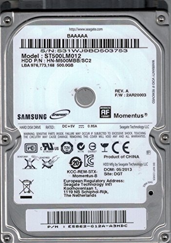

Guys, I have a SAMSUNG ST500lm012 HD that is not recognized by the BIOS.
Notebook FIC DIAMOND PCA46
Could someone help?
The HD runs on another notebook perfectly.

https://http2.mlstatic.com/hd-sata-2-500gb-samsung-5400rpm-st500lm012-notebook-dell-D_NQ_NP_844901-MLB27363027081_052018-F.webp
This is SATA 2!
 Post subject: Re: SAMSUNG ST500lm012 HD that is not recognized by the BIOS
PostPosted: October 4th, 2018, 16:46
Joined: October 3rd, 2018, 23:25
Posts: 5
Location: Brazil
https://http2.mlstatic.com/hd-500gb-gb-samsung-st500lm012-notebook-ps3-xbox-seagate-D_NQ_NP_710639-MLB25694830375_062017-O.webp
