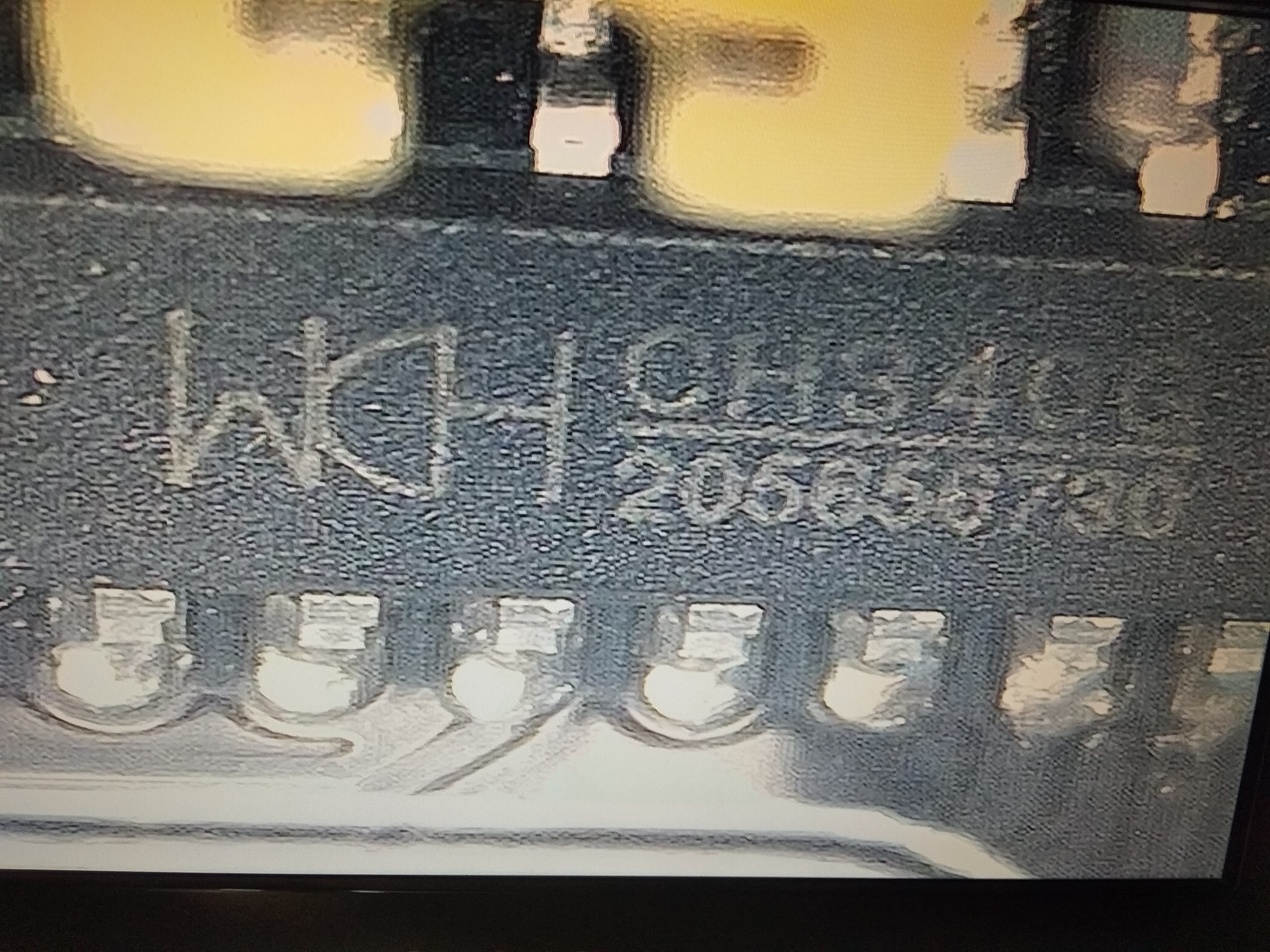

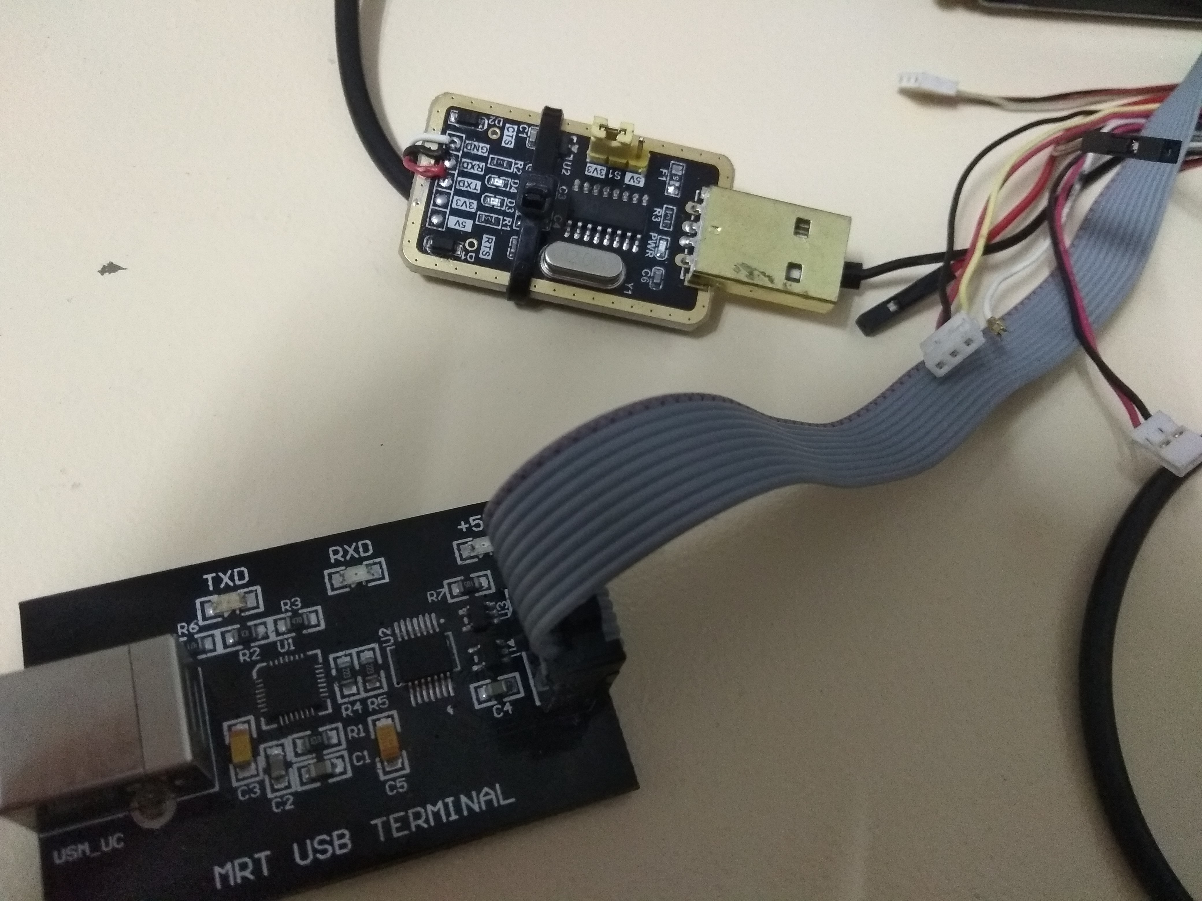

With the adapter of the MRTLAB I connect with all the hard drives, but with this family I have had problems.
I have tried with an adapter that buys (it is very economical € 2) and has 5v and 3.3v selection and with this configured to 3.3v works perfectly.
I thought that all the discs worked at 3.3v.

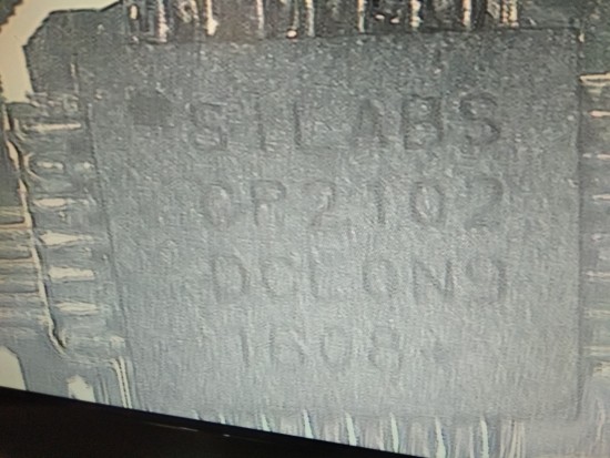

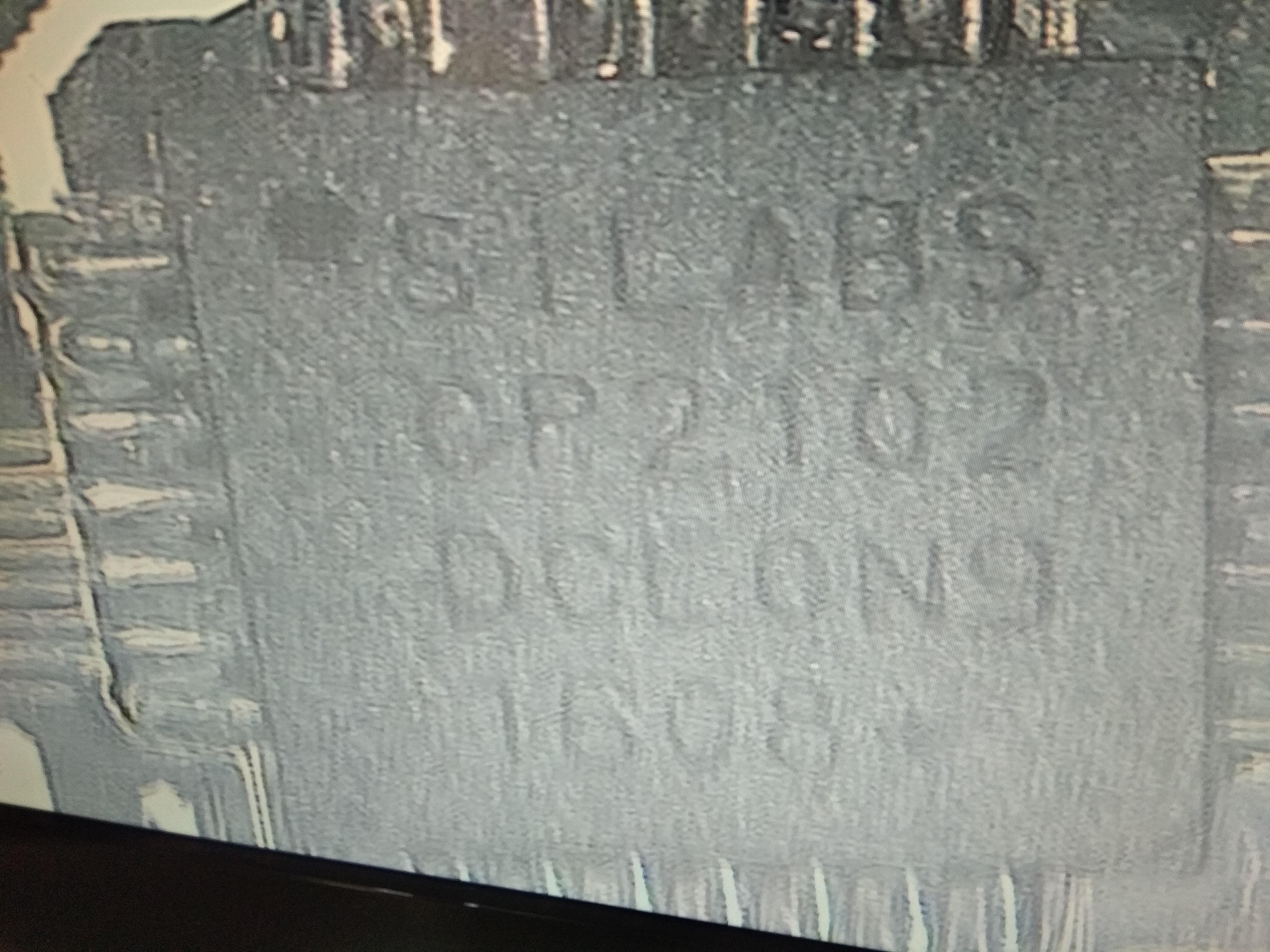

 Post subject: Re: ST1000DM003-1ER162-301 , NOT BOOTCODE
PostPosted: August 20th, 2018, 17:08
Posts: 17326
I think you will find that MRT's adapter uses the CP2102 chip whereas the other adapter is based on some other IC. The former is limited to 1Mbps baud rates. Perhaps the latter can handle 6Mbps (as does the PL-2303HX)?
Can you can upload detailed photos (or CCD scans) of both PCBs (both sides)?

Location: spain
The voltages of the economical adapter gives me 3.3v between GND-tx / rx
The MRTLAB gives me one of the voltages at 2.75v, the other 3.3v

I'm talking about the voltage levels at the HDD.
BTW, the CH340G chip supports 3Mbps.

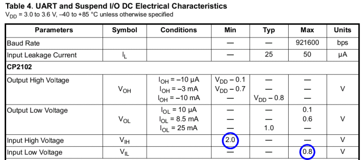

All the problem I had is with the terminal adapter of the MRTLAB.
The CP2102 chip's VIH threshold (2.0V) exceeds the output of the HDD UART (1.8V). I believe that MRT has a new adapter that can handle the lower voltages.
The CH340G chip has the same VIH threshold (2.0V) and a VIL threshold of 0.7V.

Ace Lab's new adapter supports 3.3V, 2.5V and 1.8V I/O levels.
PC USB Terminal 3 adapter:
http://www.hddoracle.com/viewtopic.php?f=12&t=2437
It wouldn't be hard, or expensive, to modify a generic 3.3V adapter based on the CP2104 or PL-2303HX chips.
