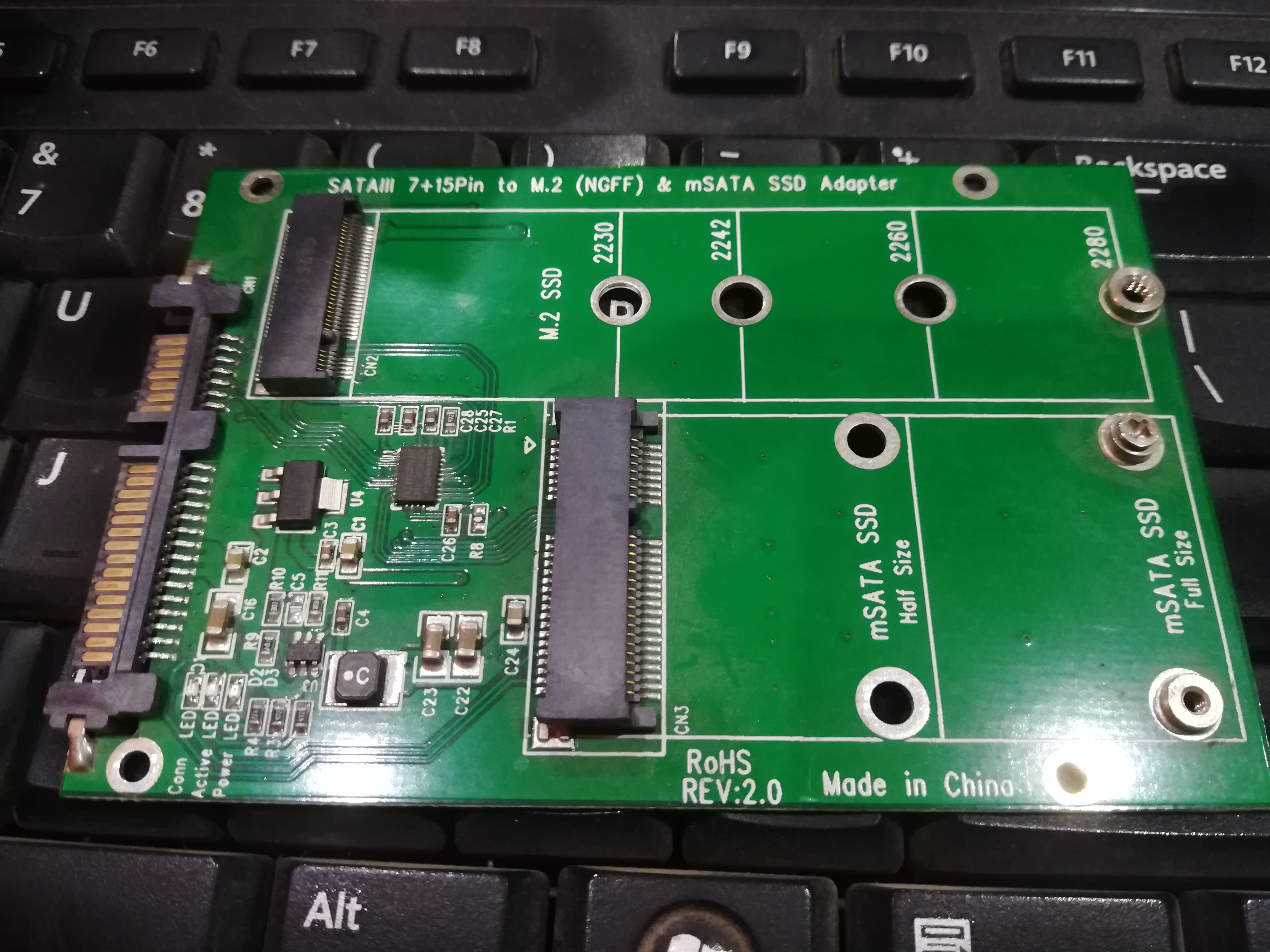

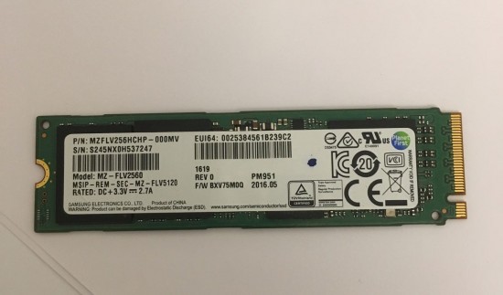

Any one tried working converter for Samsung mz-flv2560 comes out of Microsoft surface 2 . i have may converters for m2 . but all it's socket are shorter about 2 mm than the device

mr_spokk wrote:
It's a Form Factor M.2 2280 NVMe...some ordinary adapters won't take them.
Check if your motherboard has a M.2 slot...if so, it will probably fit.
thanks for replay
the microsoft surface main pcb is died .and even ACE m.2 adapter is not fit to the drive . the 2mm larger than the adapter soket

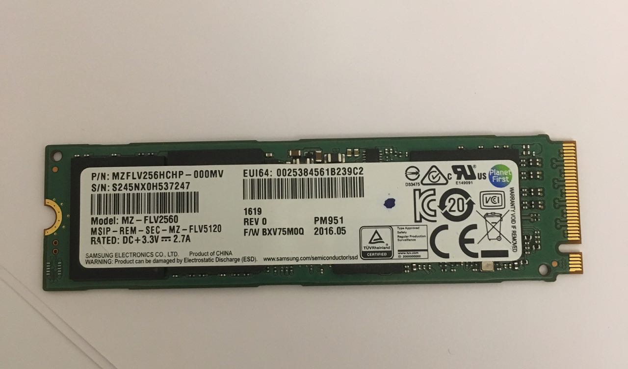

 Post subject: Re: Sata converter for mz-flv2560 !
PostPosted: September 16th, 2018, 9:34
Posts: 464
Location: Egypt
HaQue wrote:
aren't these mSATA? not M.2? pretty sure they are standard
i think it's m.2 NGFF but not sure . i attached the drive picture .

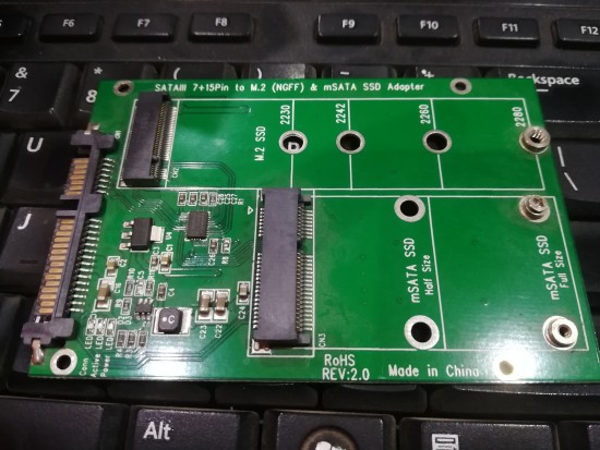

PostPosted: September 16th, 2018, 10:32
Posts: 842
Location: Pakistan
here is one, it should be fine.
have bought this and 10 more from China.
will search the contact info.
Data Recovery Pakistan

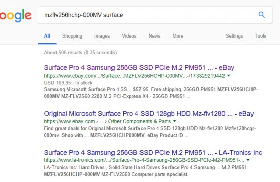

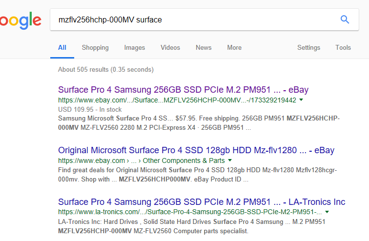

PostPosted: September 16th, 2018, 11:16
Posts: 3975
Are you sure it is a surface 2? even surface 3 had mSATA. I am thinking a surface Pro 4..?
PostPosted: September 16th, 2018, 17:01
Posts: 17230
All my Google searches for PM951 or MZ-FLV2560 identify the SSD as PCIe x4.
PostPosted: September 17th, 2018, 0:10
Posts: 3975
if that is the SSD, datecode of 2016 implies that maybe not a surface 2. they stopped production in 2015 of them.
Model :MZFLV256HCHP
Capacity(GB) : 256GB
Interface Type: M.2 NGFF PCIe x4
also:
and it would be the M.2 with "M" key in the slot
https://www.pugetsystems.com/labs/articles/Overview-of-M-2-SSDs-586/
PostPosted: September 18th, 2018, 8:39
Posts: 2848
This adapter will never work with this model
I had a similar cases, Thnx to Michal (Arvika) for his tips... case closed.
