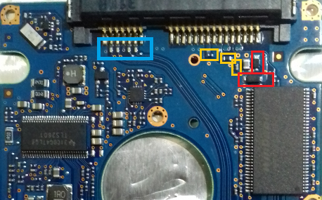

Hi guys,
Got a electric surge on a laptop having this drive, it doesn't power up at all, hope it's a PCB problem?
checked 2-3 fuses (yellow) & 2 TVS diodes (red), which I assume they are, looks good. 2 fuses passes current and 2 diodes read as ~600 ohm (on reverse 111 ohm - got this reading when they are on circuit).
Also checked, 4 diodes near SATA connector (blue), they do not seem working! not sure what they are?
Can someone please confirm if my observation is correct?
Many Thanks,
-JS

If the drive doesn't power up at all, then you are looking in the wrong place examining components on the SATA lanes.
The readings you get on the diodes sounds pretty normal for good diodes.
The best method here is probably going to be just replacing the PCB along with transferring the IC602 chip.
What makes you assume it's a "power surge" on the laptop? That's pretty rare given that laptops run on batteries.

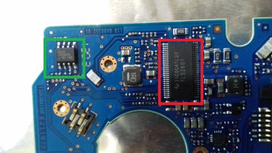

Thought of switching with a exact same PCB board, the spec on the drive matches following:
PC Board sticker: OJ14451, DA4740D
P/N: 0J26252
MLC: DA5112
Rev: 220 OA90351 01, 110 OA90351 01 (as per PCB)
Chip: 88i9305-TLA2
e.g. like this one - https://www.ebay.com/itm/HTS541075A9E680-0J14451-DA4740D-0J26252-DA5112-Hitachi-SATA-2-5-PCB/162085081926?hash=item25bd061346:g:4HwAAOSwY0lXSPTM

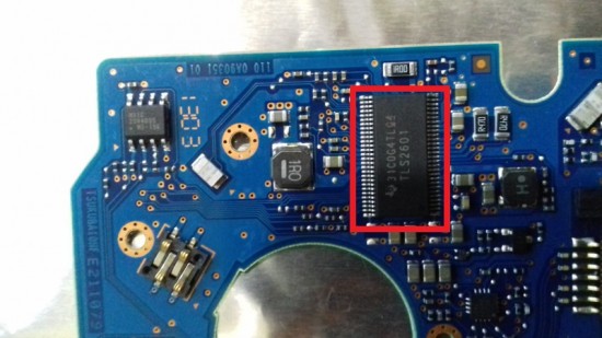

Does this still need transferring firmware chip from original board? is it correct chip I marked in red?
Many Thanks
-JS

The "diodes" in the blue box are capacitors.
If you place your ear against the drive, can you hear any sound at all?

See https://www.hdd-parts.com/14062934.html
They will transfer the correct chip (you have picked out the motor controller - wrong chip) for no additional fee.
What voltages do you measure at the "1R0" and "H" coils?
Look for 8-pin chip.
And you are wrong, too!!! This is the DRAM chip.
I'm looking at the red box. Where are you looking?

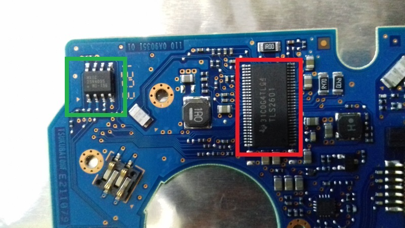

Thanks for the guidelines. so it must be the one marked green?
will check the voltage across "1R0" and "H" coils tomorrow.
Many Thanks
-JS

Possibly yes, but what are the markings on the chip ?
 Post subject: Re: Fuse & TVS Diode for HTS541075A9E680
PostPosted: April 18th, 2018, 18:20
Yes, that's the one. And yes, you'll pretty much always need to transfer that.

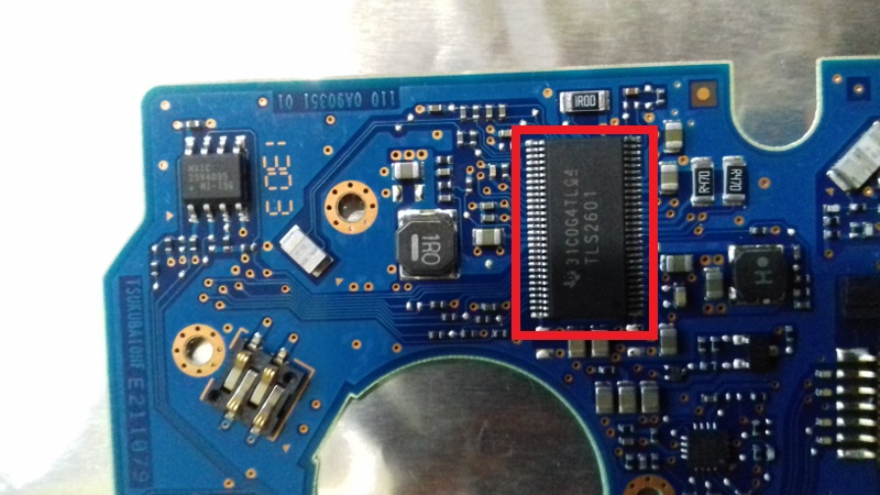

Are the motor controller (TLS2601) or MCU (88i9305-TLA2) hot to touch?
