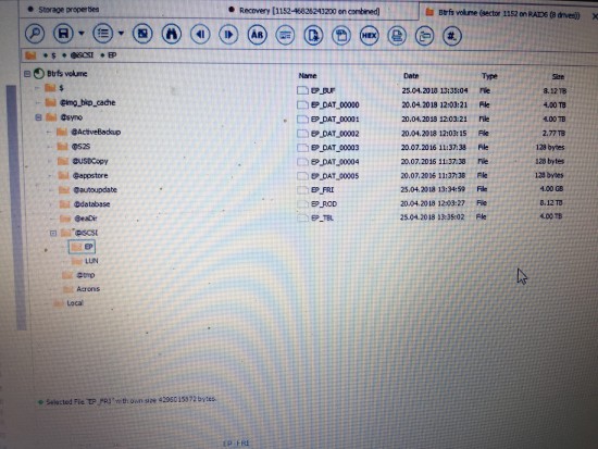

Hi all.
I have a NAS Synology 8 disks. Was assembled as Raid6.
Due of hardware issue 2 disks failed and completely unrecoverable. I was able to reconstruct array , using original parametres. I see BTRFS in there and many strange files with abnormal sizes (more than allocated space) . There was couple of VMs wich i dont see as files and scan didnt help me to find them. Using google search i found that Synology has own system to populate space for virtual mashines. I am wondering, do someone know how to get access the data in order to restore everything need to my client? Any advice or software i can use for that?
Thanks in advance.

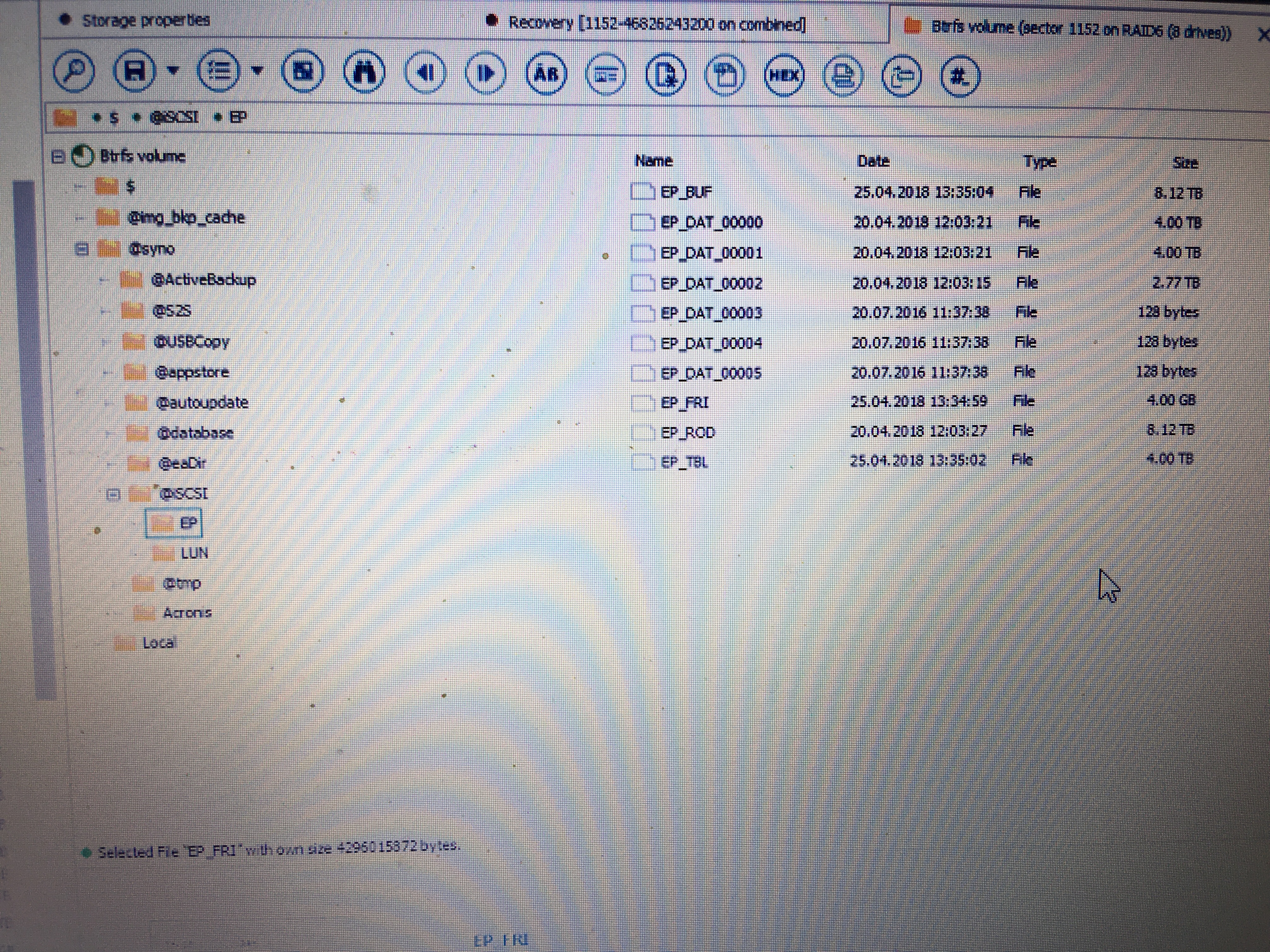

Tomset wrote:
Linuх (Ubunta) + mdadm + lvm2
How does it help? I don’t have problem accessing file system, and it is not lvm2 configured. There is some synology metadata has been used to operate with VMs

Looks like those may be disk images in that folder. I'm assuming they were using it as a iSCSI target for the VM's? Most likely it's just thin provisioning and you'll need to stitch some of those files together to get a complete image.
Thanks for advice. Yeah, i've thought so and researched those EP files. What i found , there is NTFS structures like in a regular VM files but data distributed with 4K cluster size across all of them with unknown for me mechanism. And it is not RAID type sheme nor JBOD :( All of them contain some unique header block at the beginning.

Yes, this was an iSCSI target and you need to handle those files as images.
And you'll need to assemble the ones with the numbers manually.

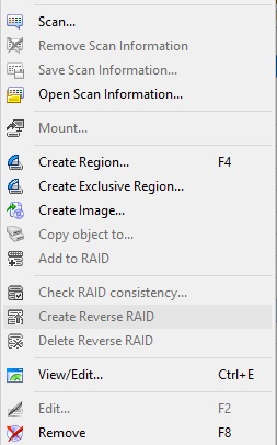

Based on my experience to deal with many Synology Nas, you have two options.
1) Use R-studio to create same Raid6 without 2 disks.
In such an occasion very useful option to make reverse raid from the one you have just created. Make images of those two skipped drives.
Than, find log files and find identifiers of two failed disks and write them to proper place in meta data sections to a new clones.
Put all drives back to Synology enclosure and try to run it.
2) About Synology unique system.
In a separate folder, there is should be big file (many Gb size) with a translation table. Where mentioned identifiers in a header and layout of clusters distributing across EP... files.
Try to decode that table in order to create VM based on EP_Dat files.
It is a bit complex work, i have done that before successfully. Feels free to contact me, i can try to help remotely.
Since, you cant recieve/send PM messages. Contact me via skype: vladimirgintov or via whatsApp +971552737521
Cheers.
