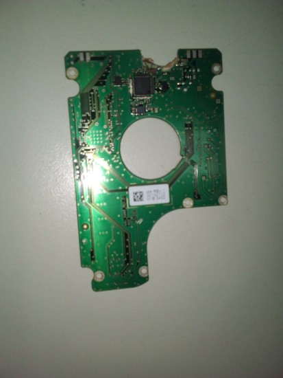

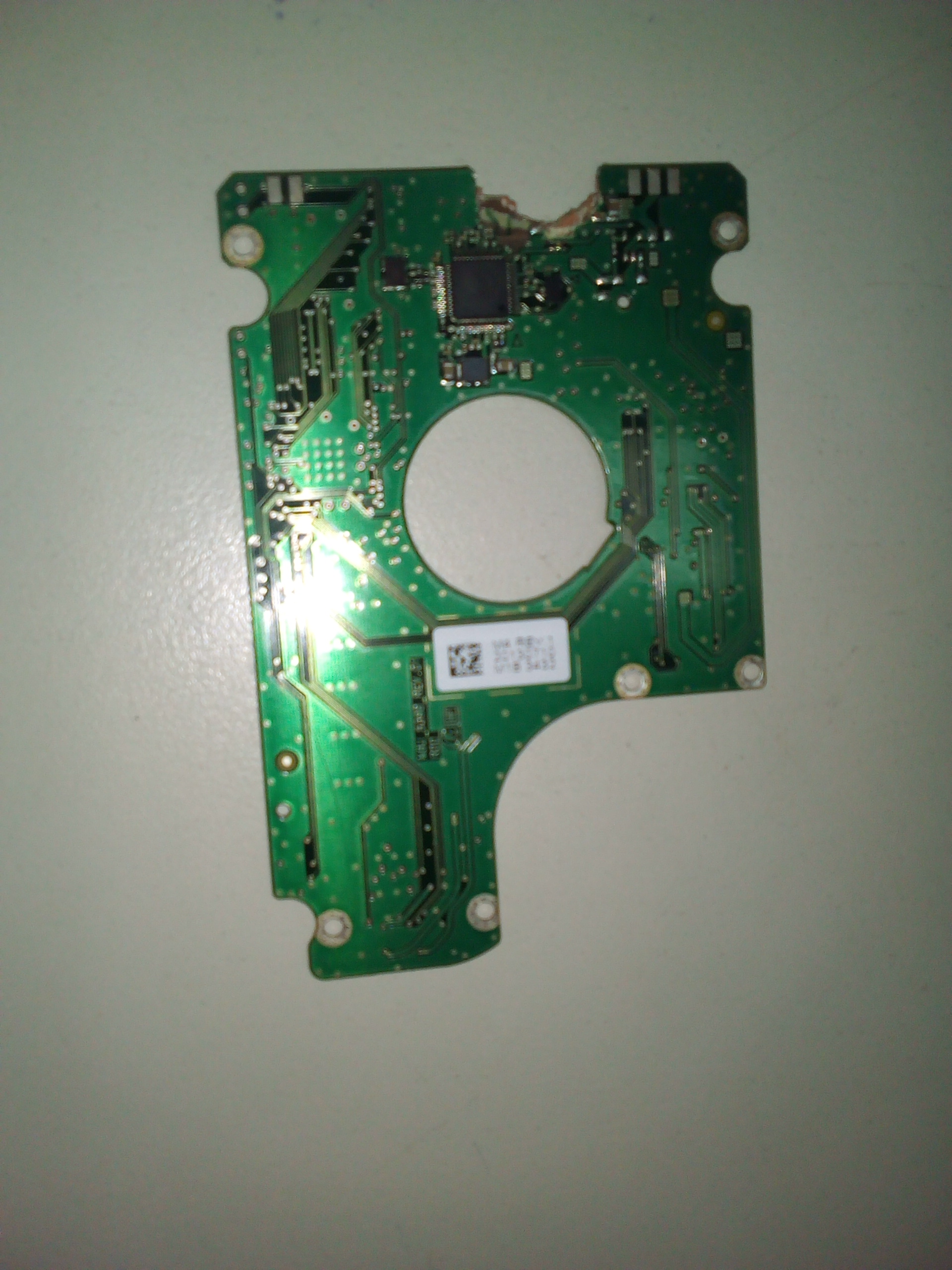

HELLO !!!
my hdd had the input ripped and I wonder if it has any solution.
I saw some comments about it here in the forum and I would like someone to suggest a way to solve this problem because I have a lot of information inside the HD.
by chance if I change the logic board will work I found in ALIEXPRESS some with the same serial number if I change will it work?
MODEL: ST1000LM025
HDD / PN: HN-M101ABB
M8U_539B_REV.01R00
BF41-00373A00
88I9322-TFU2
TLS 2602
sorry my bad english

You may need to transfer the ROM ("BIOS"):
https://www.hdd-parts.com/14060103.html

Thank you, I imagined this because I saw that the bios is not the same as my plate plus the rest and identical, thanks for the attention.
