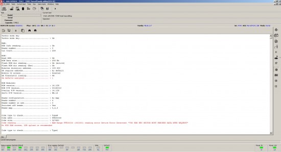

I am looking for ROM/LDR combination that I can try to attempt to gain access to the SA on this case I have. Any help is appreciated!
Drive model is WD5000BMVW-11AJGS3
firmware is 0016001C
family FBLite 2.5"
I hope someone can share it

You cannot access SA with non-original ROM on this - do you have original ROM?

Thank you for your answer.
I have this situation :(

Upload LDR from here:
http://files.hddguru.com/index.php?acti ... ty/Fblite&

Thank you very much for your precious help :D :D
