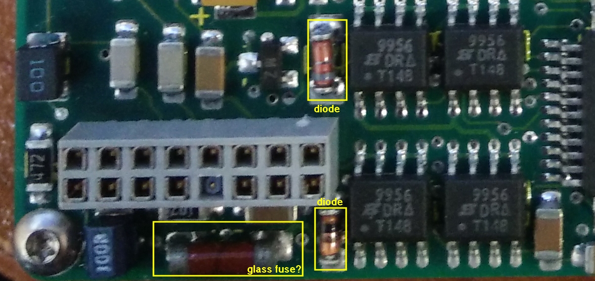

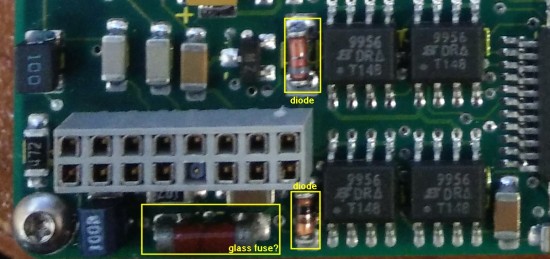

Does your PCB have these components?
I don't know the baud rate settings. You'll need to discover those for yourself. Sorry.

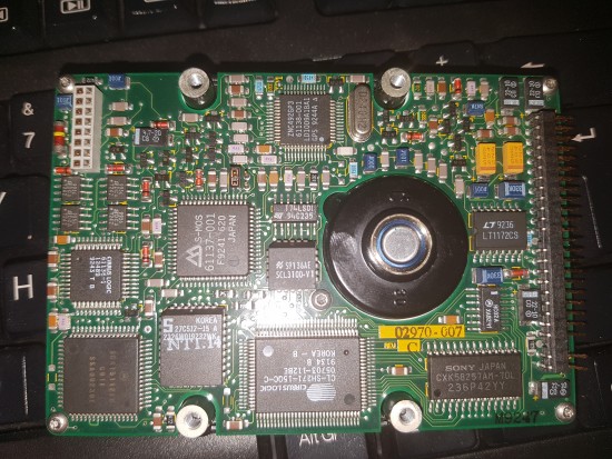

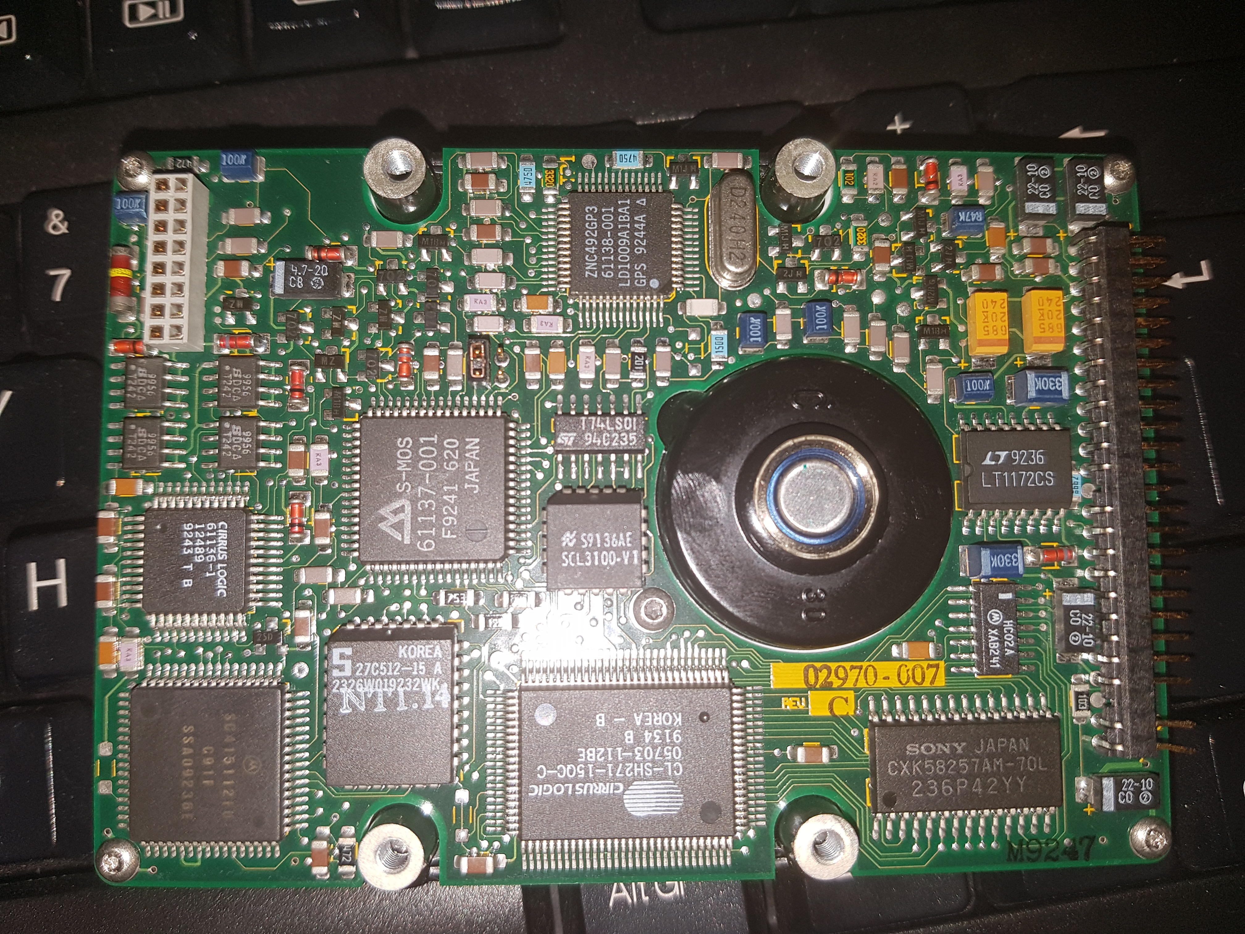

It does have those components (see attachment) but the "fuse" seems to be fine. One of the diodes, however seems broken, it measures at ~47KOhms in both directions.
I've been experimenting with different pin configurations and baudrates but no dice (yet).
What's strange to me is that the drive works fine when the actuator is "helped" on startup. If you just leave it the chip marked ZNC492GP3 gets really hot, haven't checked just how hot yet.
I'll try some more tomorrow, as it is getting late here.

In current HDDs the motor controller is a "combo" chip that controls the spindle, voice coil and power supplies. Therefore one might expect this chip to heat up when the spindle is seized or if there is a problem with the VCM. That said, in your case there are 4 discrete MOSFET drivers (Si9956DY), so my observation would probably not apply to your drive.
The Cirrus Logic 61136-1 chip would be either the spindle motor controller or VCM controller, or both. I don't know if the S-MOS chip (61137-001) is also a controller of some kind. If I were attacking this problem, I would trace the circuit involving those 4 chips and the HDA connector, and I would determine which pins of the Cirrus Logic chip drive the gates of the MOSFETs. The functions of the diodes might be important as well, especially if one of them is leaky.
