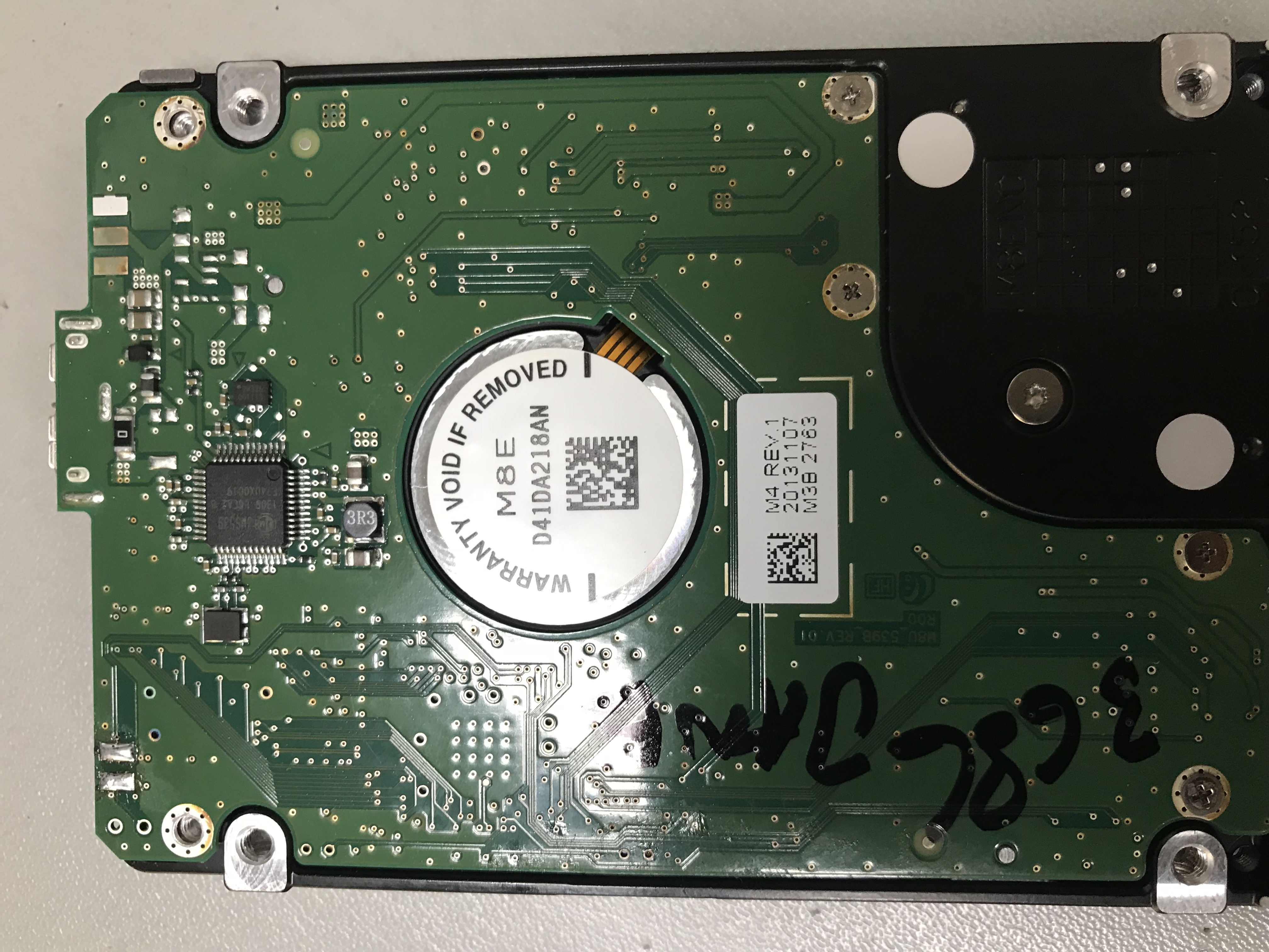

is it possible to recover the damage ROM on ST1000LM025 ?
thank you

Should be possible. Just need FW version to match, no unique adaptives in these.
What's happened to the original ROM?

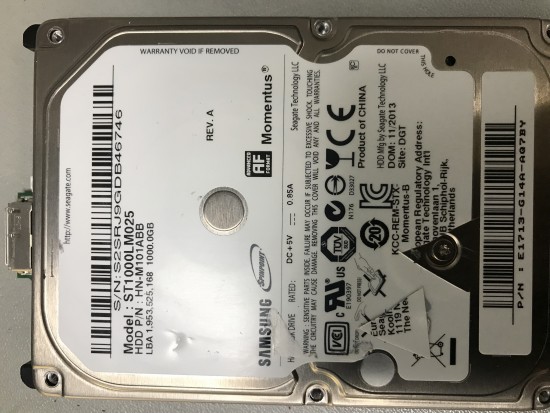

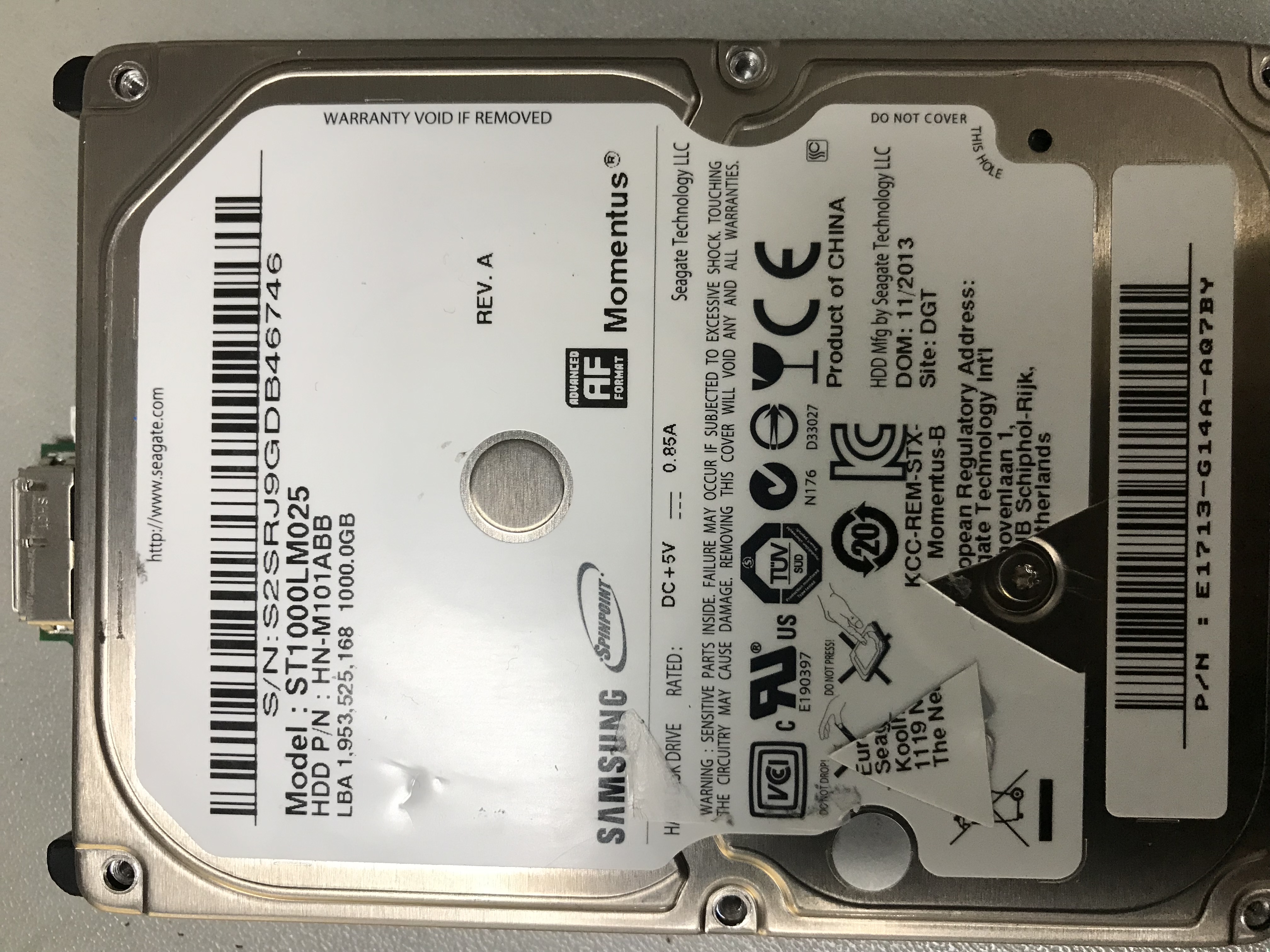

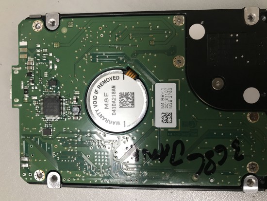

third party damaged the ROM, possibly overheating it.
Is there any firmware version on the label? i could not see any.

Hotswap with good donor, write donor overlays, then use donor PCB
