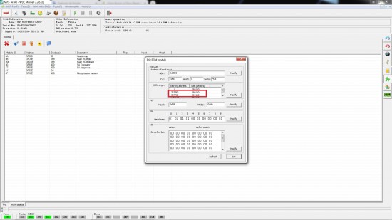

It does not let me format tracks of the SA or write modules in HEAD 1.
When reading the SA in the head 1 gave failures.
I format the sa of the head 2 and I record the tracks of the SA of the copy 0.
In the ROM (0B / 2B) I modify the ABA range so that the second value points to the copy I made with the head 2.
I activate the 411 and it detects everything correct but as it is expected the head 1 is weak and it reads very slowly and with some defective sectors.
I make a copy of everything I can and then I'll change the heads
I correct, the heads are fine, it is the surface of the disk of the head 1. I do not change heads.
Thanks to everyone for your inconveniences and especially to @fzabkar, for their always selfless help towards everyone.

00000050                          54 52 41 4E 53 4F 56 4C          TRANSOVL
I don't understand the MRT screenshot. It shows module 0x411 at ROM address 0x3F03E with a size of 0xD0 bytes. That's module 0x0D, not 0x411. :?
0003F030                                            52 4F                RO

Re: WD10JMVW-11AJGS2 BUSY
September 22nd, 2018, 18:58
This screen capture occurs when the 0x411 module is deactivated.
The MRT shows that there is a 0x411 module in the ROM. But that is not correct, it happens due to the fact of deactivating in the ROM the access to the module 0x411, I do not know the reason.
It would be interesting to know what implementations the 0x411 module performs, I suppose they have removed part of the 0x11 module to make it lighter and better manage the RAM (It's a guess, I have no idea).
I did a test in case it was a problem of the load of the translator and modify the size directly in the module of directions, and since from one direction they were all zeros the checksum remained the same and I loaded it in the RAM with the new size .
When I finish copying data I will make the test to point the 2 ABA of the head 1 and 2 towards the same address in the head 1 and if it works, when a HDD of these has a bad copy of the SA, it could be solved simply by changing the address of the ABA.
