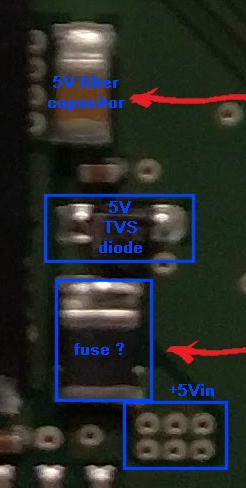

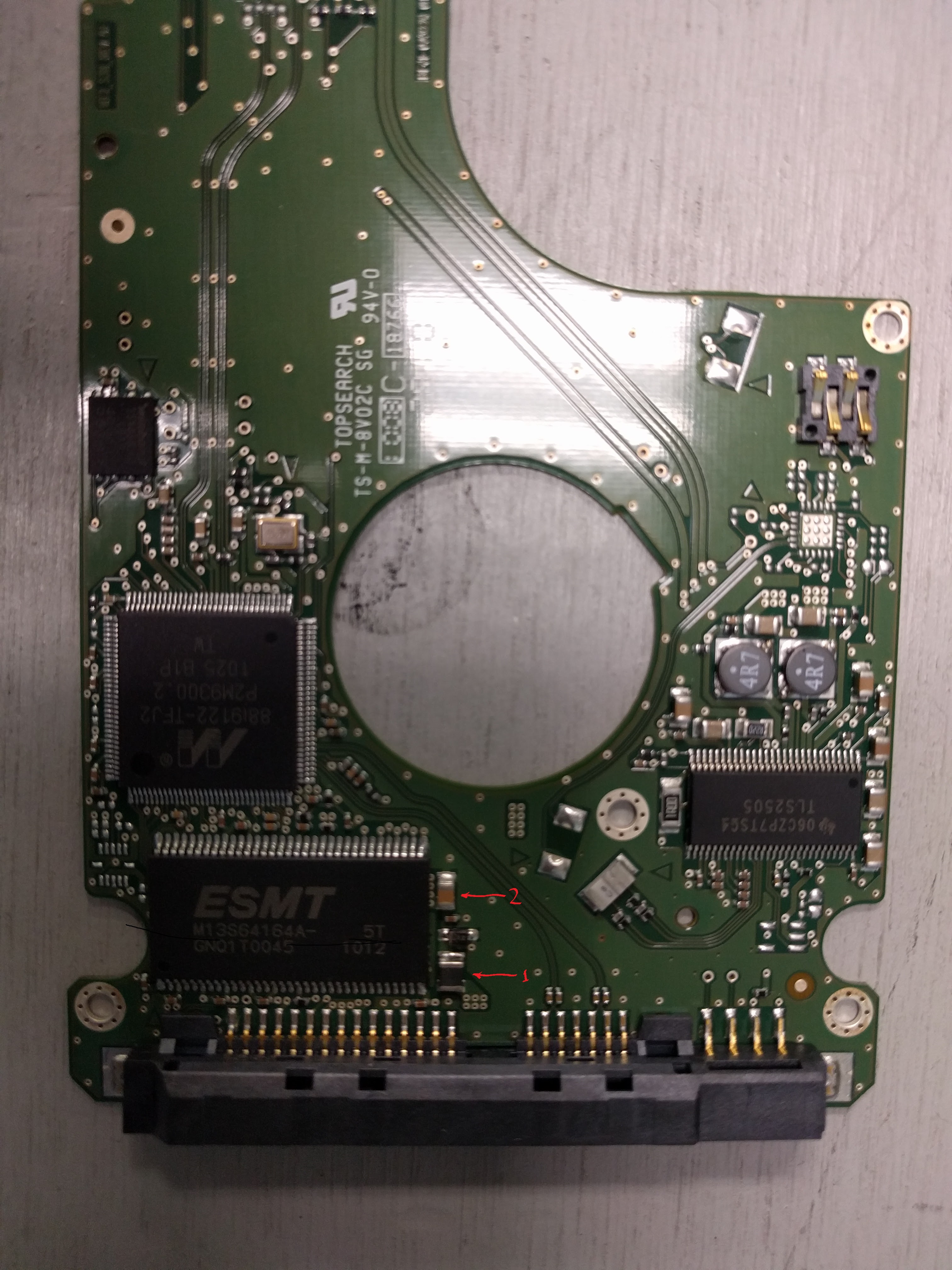

I have a samsung drive I pulled from an enclosure. It is not spinning at all. My limited expertise told me to check if it has a blown tvs diode. When I check for continuity between the 5 volt and ground I do not get any. To me that means the tvs diode is good. Actually I am not sure this drive even has one. I labeled two parts "1" and "2" by the power connector, Here is what I know
-no continuity or an ohm reading of 1 when I put my meter on bother sides of part "2"
-one side of part "2" goes to ground and the other side goes to the 5 volt
-part "1" has continuity and both sides go to the 5 volt
Any help an giving me direction would be great
Does this drive have a tvs diode? If I was to guess, I would say no.

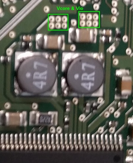

Measure Vcore and Vio.
Does the drive attempt to spin up? Can you hear any sound, however faint?

no sound at all. I am embarrassed, I did not even barely notice that small tvs diode. How do I measure the vcore and vio?
I have an ohm reading of about .5ohm between vcore and 5volt and also the same with vio

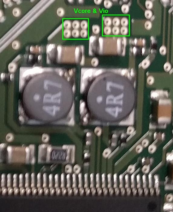

Measure the voltages between ground and each of Vcore and Vio.
vcore = 2.5
vio = 1

Those voltages are OK.
Try to obtain a terminal log.
How to connect a terminal adaptor on a Samsung drive ?
http://www.hddoracle.com/viewtopic.php?f=116&t=189
BTW, did you test the drive in a PC? Some drives are configured to power up in standby (PUIS). Also, some enclosures won't spin up a drive unless they detect a USB host.
