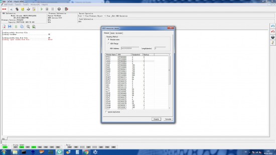

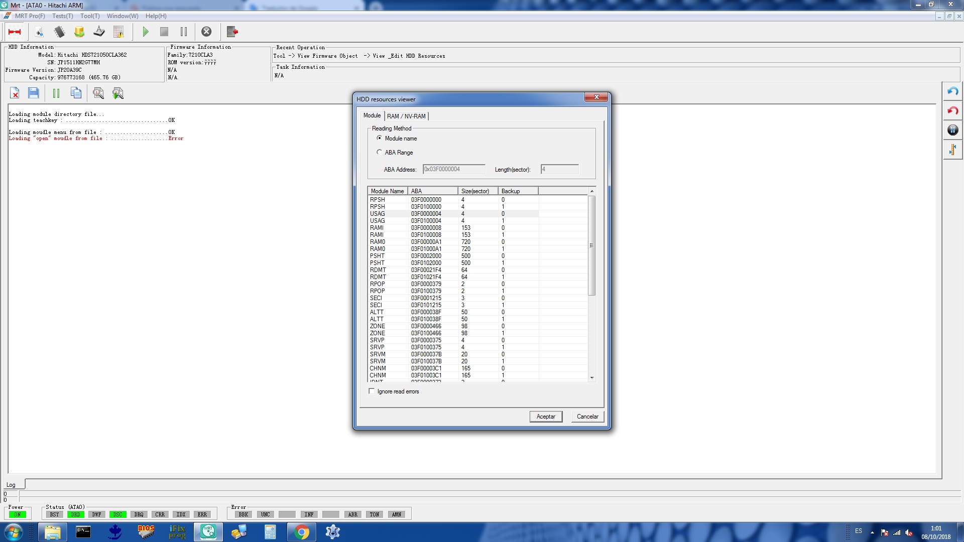

I'm going to put a screenshot of the mrtlab and the USAG module.
THE MRTLAB talks ABA address, but it has a lot of logic what is said in the link.
tomorrow I will try to understand something else.
Greetings.
