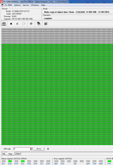

Hi Mike, thanks for the reply. I'm managing to work with it, albeit slowly, without patching ROM, so I'll see how I go. Cheers.

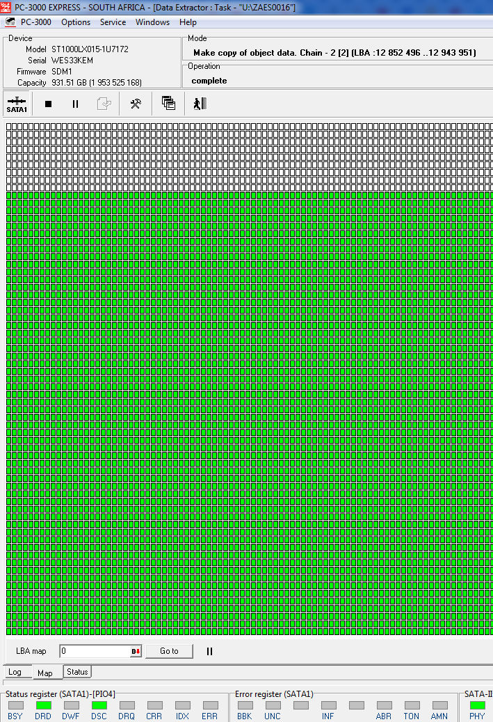

Managed to get a good recovery of his user profile after a bit of fiddling with timeouts etc. Hoping for a solution for the rest of us plebs to patching these ROMs.
