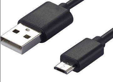

totofb wrote:
Those pictures are not helpful. You need to remove the PCB from the drive with a torx driver and take a clear picture of the component side of the PCB. You could also try a micro USB cable plugged into part of the USB connector. Sometimes that will allow access to the data, all other things being okay.

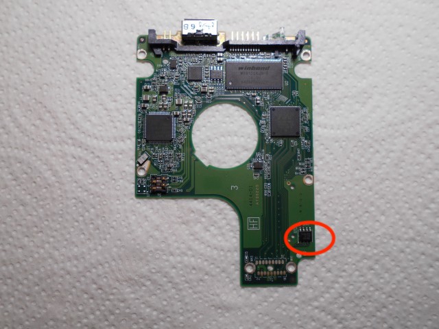

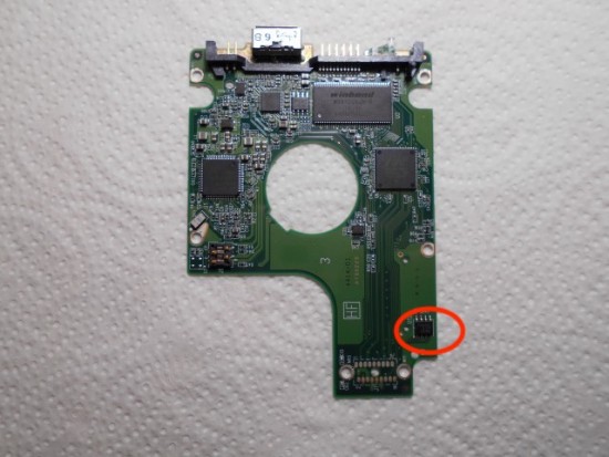

Why not buy a good usb pub from eBay or similar, swap the ROM chip and use the drive as normal?
What is the pub number? Take a pic of the backside of the drive and post it.
=> For micro usb cable, how can I plug power ?

Buy a pcb 771960...and move marked komponent.

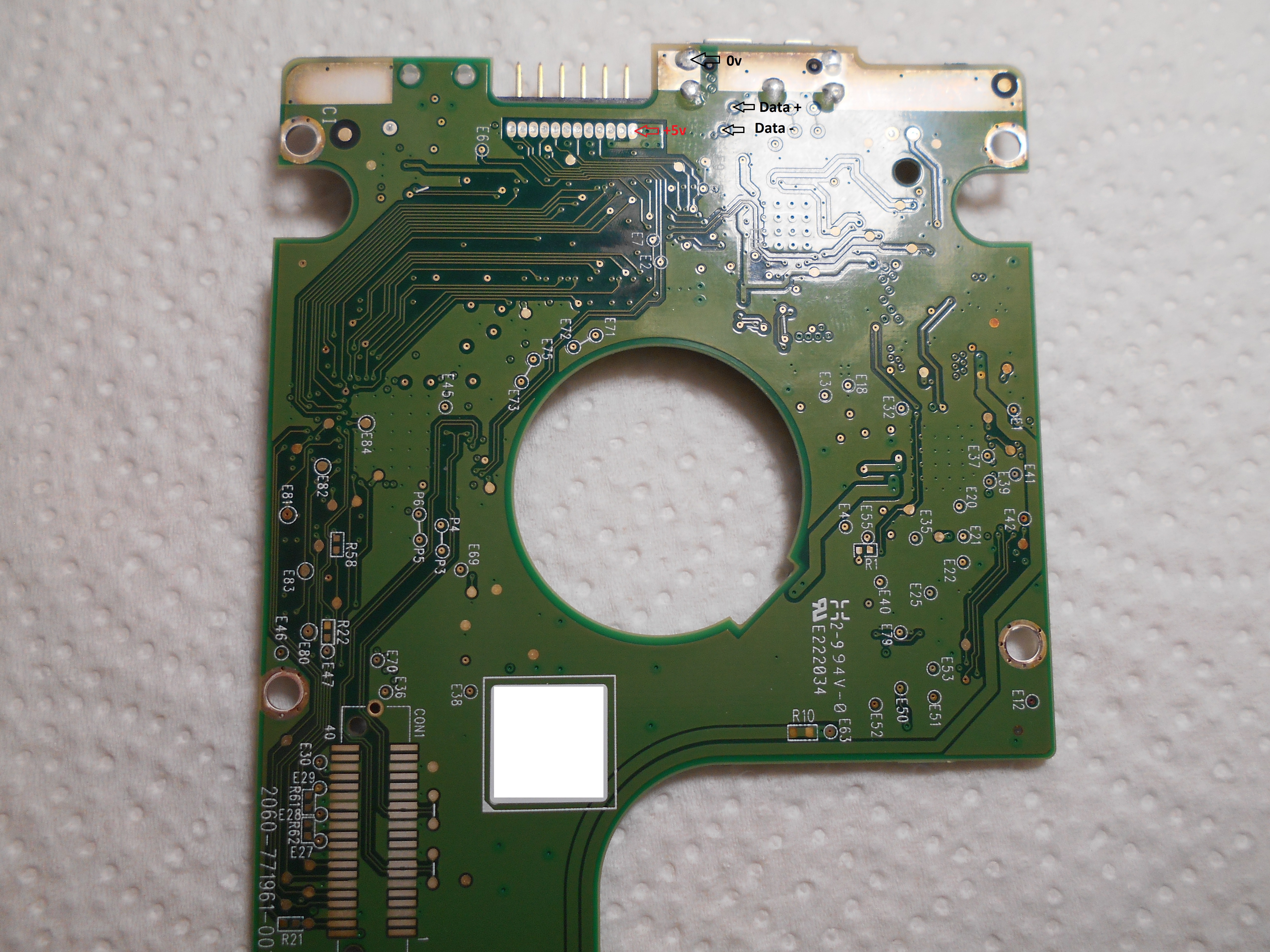

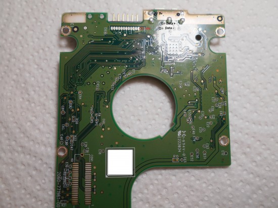

PostPosted: October 7th, 2018, 9:34
Posts: 927
Location: uk
So I would prepare a spare usb cable and solder the four connections as indicated in the edited photo.

I soldering many times pins but the soldering did not hold and pin with a part of the card board snapped.
Pcb seems to be a very poor quality.
The picture :
https://ibb.co/nJkLyp
I think the pcb is out
A short-circuit is now present between the 2 pins D+ and D-. :(
How to solve this problem ?
 Post subject: Re: Usb pin out
PostPosted: October 9th, 2018, 14:36
Posts: 927
Location: uk
Sorry to say but your soldering skills and probably your equipment is not up to the job!
To remove the short might be difficult as it appears you have poked the two little solder pads to death.
It might be possible to remove the short circuit and connect to the other side of the pcb?
Now a really easy job has been made harder and probably your best move is to buy in a new pcb and swap the chip as suggested by mr_spokk.
My best advice is to get somebody with the required knowledge, tools and skills to do it for you.
