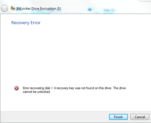

Hello everyone,
I need help with regards to recovering deleted data from bitlocker enabled HDD. I made couple of clones, leaving original intact.
When i connect drive to my Win10 machine, it can access the partitions without problem. So i assume that access from OS level is ok. When i try to scan with R-Studio, File Scavenger, it does not recognize the OS partition. If i try connecting the drive to Win7 machine, i can't access partition because it's locked. (picture in attachment)
I enabled Bitlocker on the drive (through Win10), and then performed decryption, however, no deleted data is visible after scan.
When i compare the sectors on the original and decrypted hdd, there is difference, since some targeted sectors on the decrypted clone are empty, and on original drive are not.
Is there a way to make a bit-to-bit image/clone of the drive through Windows10 (since the drive is normally accessible from OS), or any other suggestions how to solve this problem?
Apologies if my question is not 100% correctly written, but i would appreciate any help with regards to the problem above.
Thank you!

When i took out the drive from the laptop, and plugged it in first time on Win7 machine, i got initial error (look at my 1st post).
Then, i plugged it on Win10 and i accessed the drive/letter without any problem.
