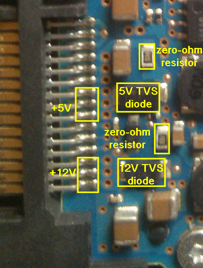

Hello, I'm new here. I accidentally shorted my PC HARD DISK. It accidentally touched a metal surface and burned a capacitor on the logic board.
It is no more detecting and also not spinning.
I checked the board for any short circuit near the OA56511 IC ( may be a voltage regulator) and the only thing shorted is that the burned capacitor. I think there may be two possible damages either the IC OA56511 itself or both the IC & CAP, I may be wrong on this(I am not a computer professional). Also, I checked the 12v and the 5v supply and they are not shorted.
It will be very helpful if someone can provide any information and guidance on troubleshooting and fixing the logic board.

very likely that capacitor is shorted due to damaged VCM (IC OA56511).
I would change the pcb, because everytime i see shorts components near VCM i was never able to fix just by replacing those components, the reason was always due to faulty VCM.
You might try to pull off the capacitor, if you still see short on its pads then you know that vcm is shorted, if you don't see short once you remove the capacitor then you could solder new capacitor (but in my opinion it will notwork).

Spildit wrote:
I was NEVER able to "fix" Hitachi/HGST PCBs ... Once they are shorted even if some fuse does blow and you bridge it the PCB will burn on another place ...
In this particular case Hitachi uses the same stupid design philosophy as WD, ie the zero-ohm resistors are in the wrong place.
Catastrophic failures in Western Digital PCBs:
http://www.hddoracle.com/viewtopic.php?f=59&t=1119
