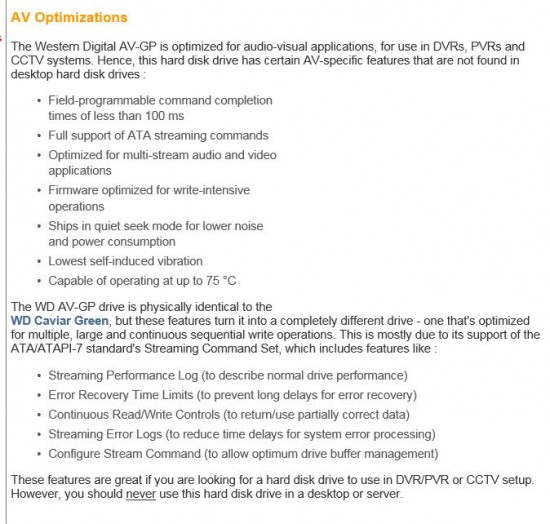

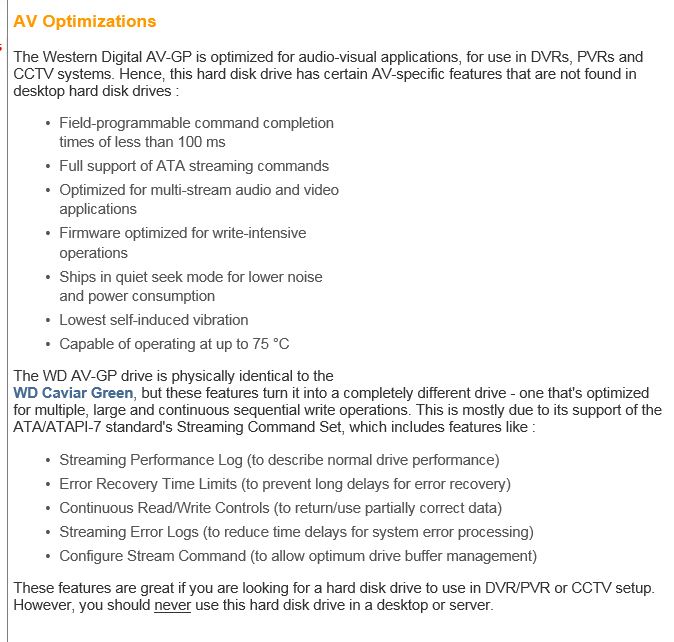

AV hdds (video) are having specific firmware optimized for continuous writing , such drives have low rpm & low read speed.
ecc error correct mechanisam is altogether removed .
These disks are not supposed to be used in desktop pc applications.
https://www.seagate.com/files/www-content/product-content/skyhawk/files/image-perfect-smart-safe-solution-cb4-tp694-1-1701us.pdf
Built In Powerful Error Correction Code
Powerful error correction and data recovery algorithms are built in to ImagePerfect, providing the highest assurance against video frame losses while intensive multiple video streams are recording. Its high speed on-the-fly error correction coding1 also helps to ensure no video freeze frames during live playback. These significantly reduce the chances of unrecoverable data error or video intermission in surveillance applications.
1 Higher data error (sector/ bits) correction on-the-fly will reduce the number of drive retries.
 Post subject: Re: Using HDDs recovered from video recorders.
PostPosted: October 22nd, 2018, 9:33
Posts: 196
Hi
Pls. note "Powerful Error Correction " code is specific to writing video streams only.
There is technical difference between 2 ( ECC error correction for normal Desktop / enterprise disks and Error correction implemented in video hard disks.
Don't mix both things as they are different optimized for particular type of disk only.
Hope it is clear now.
