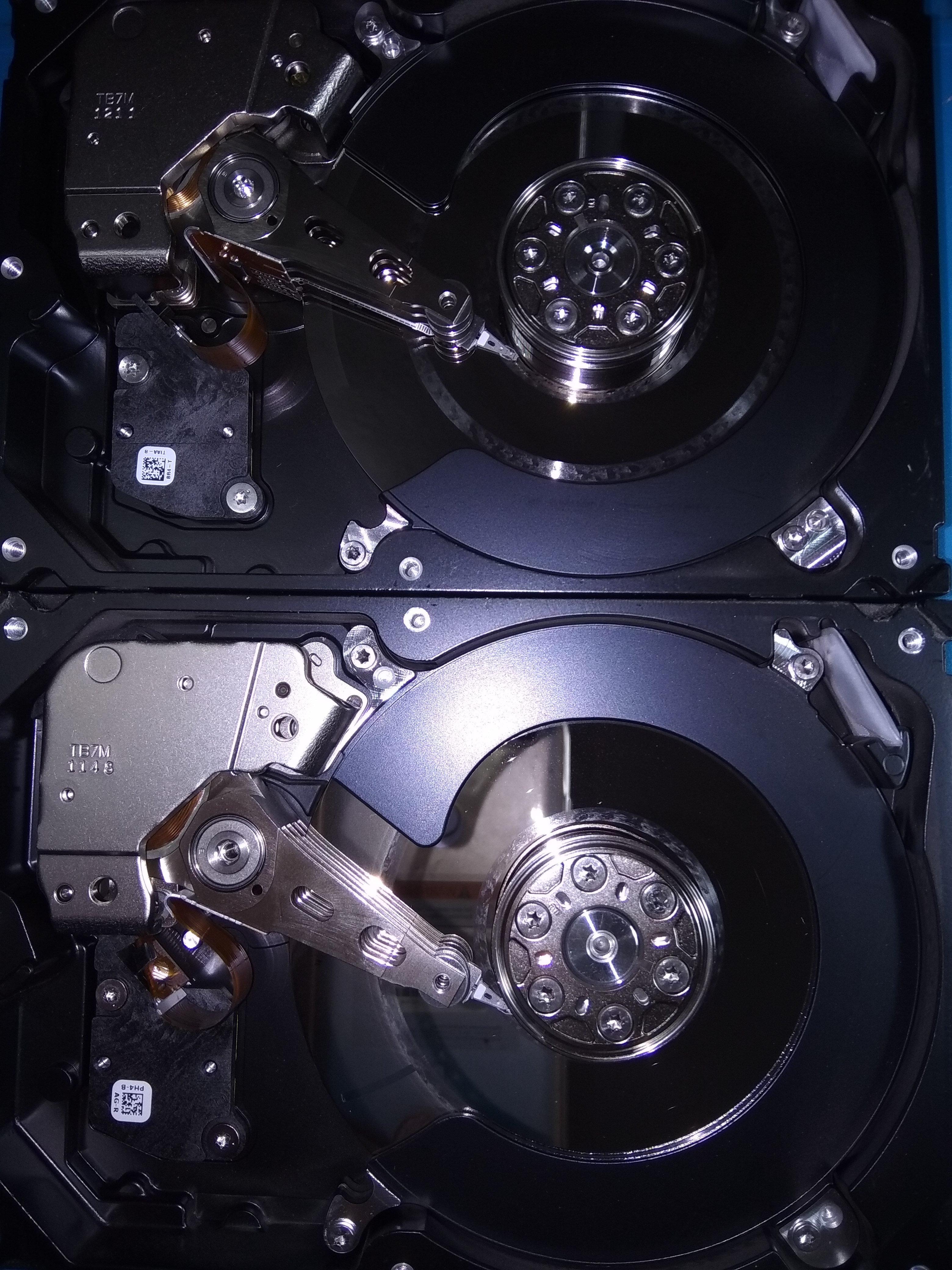

PCB : 100574451 REV B
I have 3 hd of this model and in principle with the same symptom. it hits the head and the engine stops.
It does not give me output per terminal. I have another with another plate model and if it gives me output per terminal.
I could try loading the virtualloader and the loader but I can not find them.
Any ideas. Thank you.

 Post subject: Re: SEAGATE ST31000524AS - JC4A
PostPosted: October 17th, 2018, 10:12
Joined: December 12th, 2017, 4:27
Posts: 48
Location: Poland, Warsaw
Check PCB first
Backup is Your best friend. Still learning English. Sorry for language bugs. My websites: Centrum Odzyskiwania Danych
PostPosted: October 17th, 2018, 10:18
Posts: 474
Location: spain
COD wrote:
Check PCB first
I've thought about it because it does not give a terminal and the engine speeds up a lot.
I have another 2 more broken with the same symptom in principle.
Do you know if the breakage of the PCB is typical of this model?

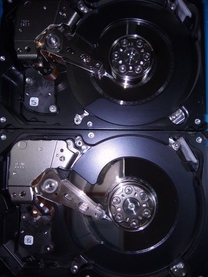

PostPosted: October 18th, 2018, 17:54
Posts: 474
Location: spain
I give up the case.
The three disc has the same symptom, the engine accelerates more than the account, the problem; I put the photo.
The four surfaces are scratched.
Anyway, I'm going to see the theme of this plate model that does not give me a terminal when it's isolated. I will speak with MRTLAB.
If I take something out of the terminal with this model plate I mention it.
Thank you.
PostPosted: October 18th, 2018, 20:18
Posts: 738
Location: Ottawa, Canada
With these Seagates, it pays to listen to them before spending much time on them. If you hear scraping noises, they usually have platters that look like yours. Rather than open the drive in a cleanroom environment, I remove just one of the screws that secure the magnets and if it's covered in data dust, it's obviously a goner and would make a hell of a mess of your laminar flow bench.
PostPosted: October 18th, 2018, 20:19
Posts: 738
With these Seagates, it pays to listen to them before spending much time on them. If you hear scraping noises, they usually have platters that look like yours. I remove just one of the screws that secure the magnets and if it's covered in data dust, it's obviously a goner.
PostPosted: October 19th, 2018, 2:14
Posts: 474
Location: spain
I'll remember that for next time.
I miss the noise that made, it seemed that the engine was faster than normal, but it seems that the noise was due to friction.
