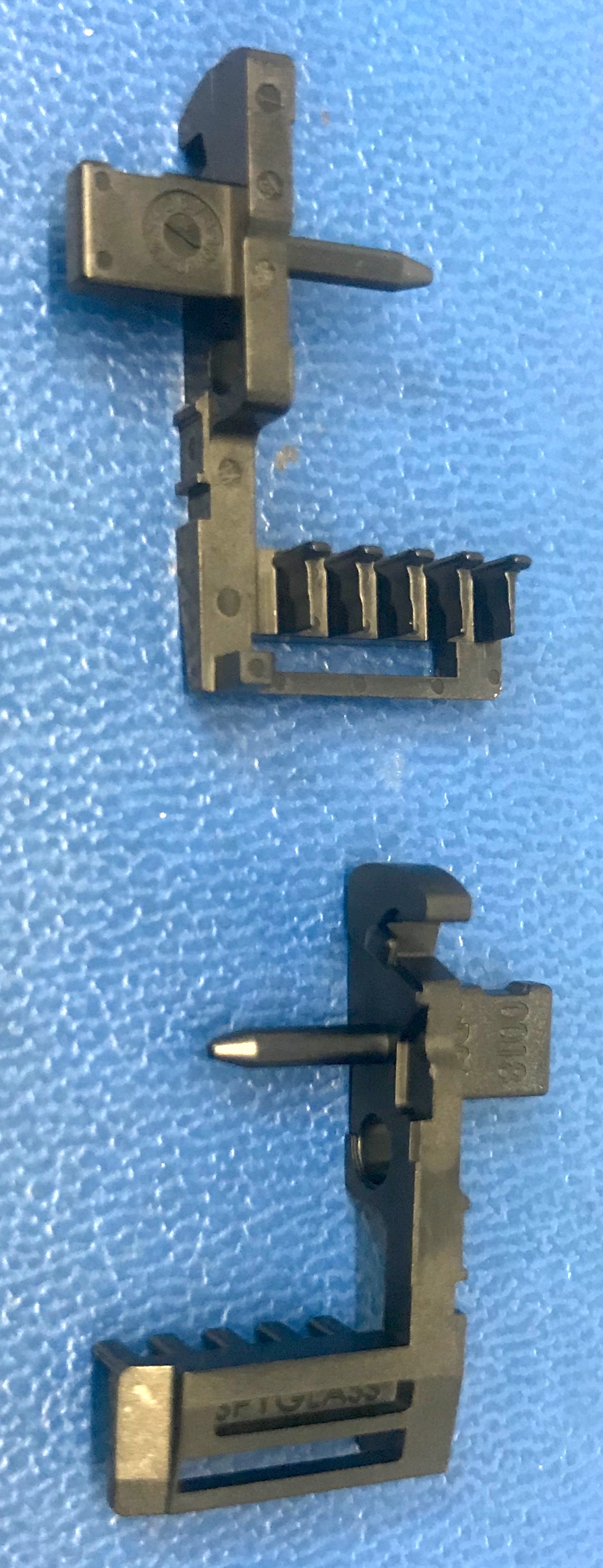

I've got Spyglass & Pebble Beach combs for $25 each.
These lock in place and are really nice -- they won't slide off.
