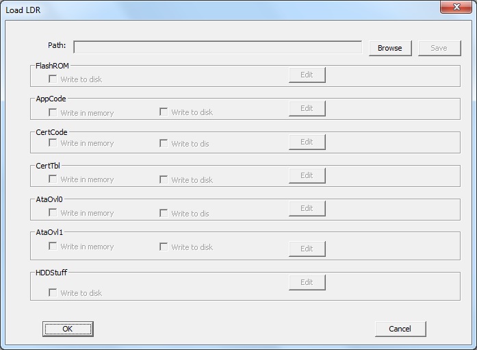

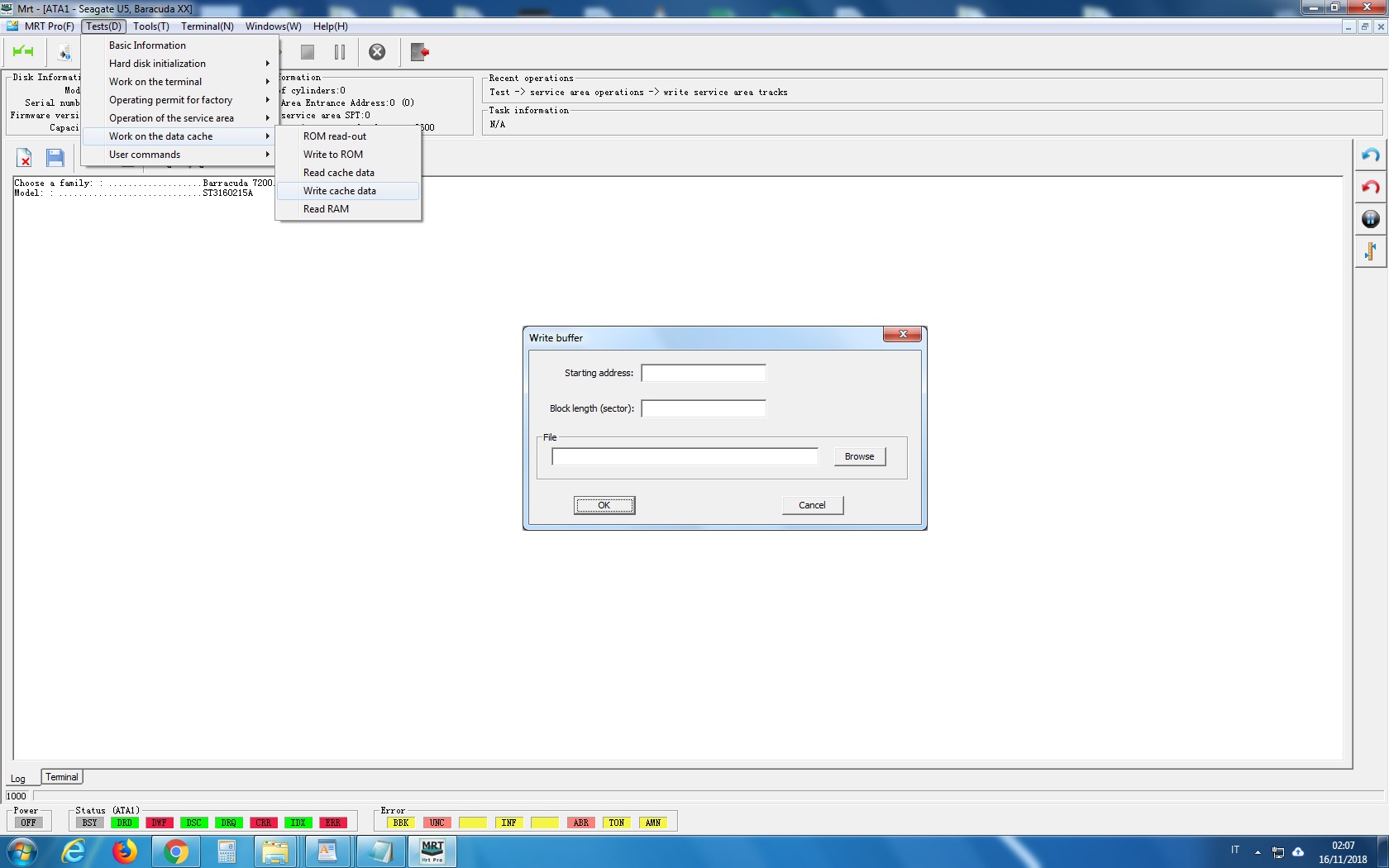

Spildit wrote:
Can't you simply load by SDLD the required "tracks" from a PC-3000 dump using MRT ?
Like for example using SeDiv you do SDLD to the drives the relevant portion of firmware code on tracks ...
Not possible, it's possible only to load LDR (only from pc3000 database because those one created with mrt won't work) and buffer.

Spildit wrote:
Could it be that PC3K's classic LDR is decompressed and executed by the drive??
I'm sure this is not the case.
F3 loaders are like "overlay" that you send to the drive, for example like Module 11 on WD. Overlay on F3 arch can be send by ATA download microcode standard command. Some tools do have loaders "encrypted" for them. SeDiv do use this method. This is to prevent files for SeDiv to be used with other tools. SeDiv decrypts the files and send them to the drive.
On ST-10 / classic the drive have no way to decompress the loader in PC3K format (or MRT). Also you are not sending by ATA, you are SDLD (Seagate Protocol) by terminal the "components" so the tool itself have to decode the loader file and send individual components to the drive. You can also chose what components to send. You might want for example send only ATA + APP and don't send CERT, etc ... The drive doesn't understand "loader" and you are not sending it by ATA. Those loaders do have to be "decoded" by the firmware tool and when you use the SDLD protocol by terminal you need to send the code directly.
This is of course a MRT bug. It can decode the PC3K loader but can't decode it's own loader.
That make sense. :)
