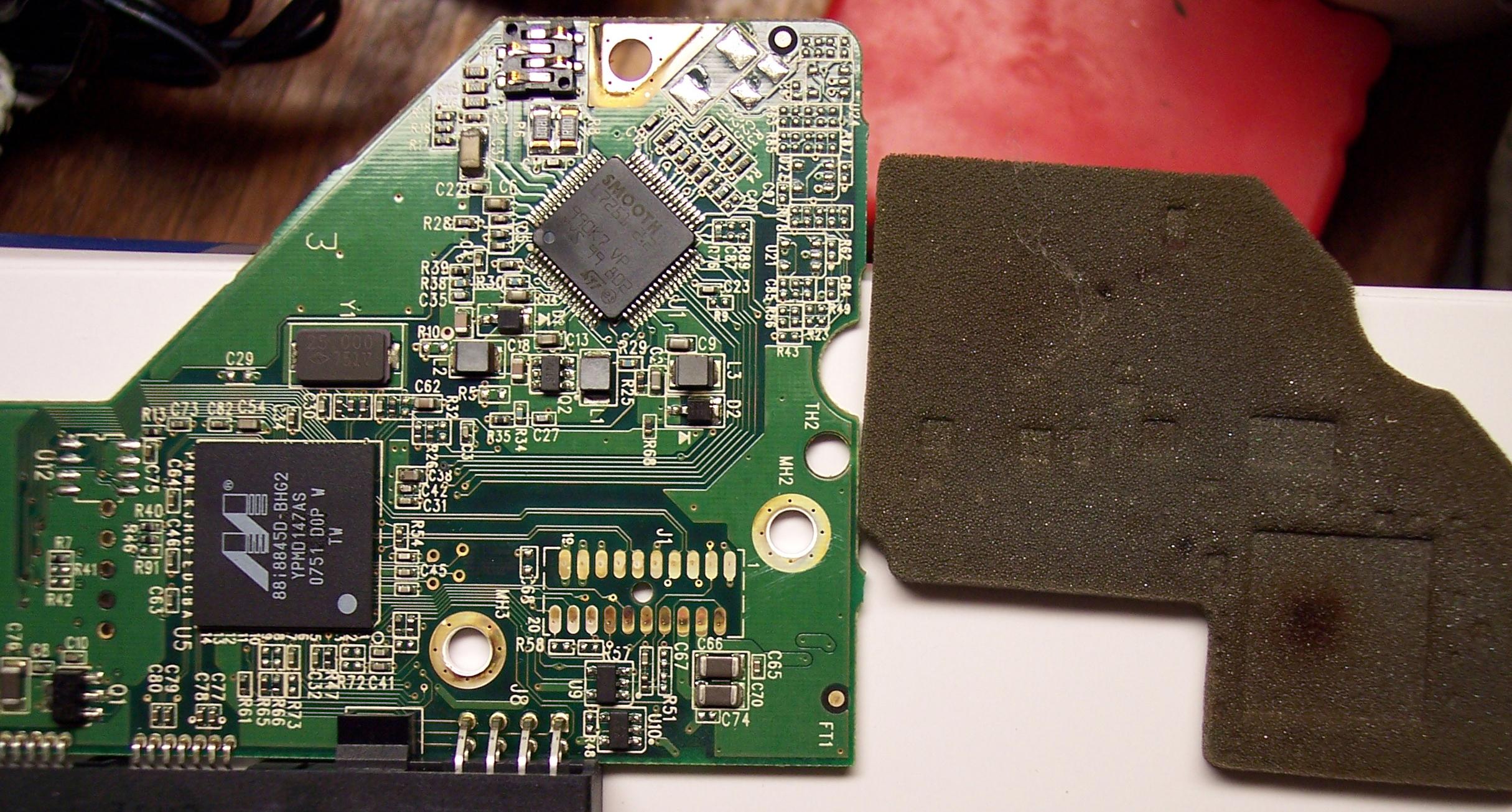

Well, the would-be donor drive showed up yesterday and it's probably the wrong PCB. It looks about the same from the bottom, but it's a 2060-771590-001 rev P2, where the dead drive needs a 2060-701537-002 rev P1 (or at least most of that number). If transferring the firmware is the only way to try a working PCB, I guess I'd have been dead there anyhow, since it sounds like on this generation of WDs it's all trapped in a giant BGA chip that I couldn't have worked with regardless.
I've included a picture where you can see a bit of charring if you guys know what areas a surge usually hits. I did notice some on the pin1 corner of the motor IC, which fzabkar pointed out as a 12v surge over at the HDD Oracle. Some of it didn't show up well in the pictures, but you can see it in the imprints in the foam. I don't know how much of it is just from normal long term heat though. That dark area in the center of the main processor for instance, just looks like some old foam residue, but the print in the foam looks horrible.
Is there any point in trying to check or swap any of the components which are usually damaged in these sort of events, or is a firmware transfer and full board swap what everyone typically does (or the safest solution)?
Assuming you guys are somehow reading and writing to that main chip rather than removing it, are there people who let you send them the two boards, or sell you a good one and perform the transfer for you?
If there's any other information, pictures, or sounds which might help, or anything I can do to narrow things down any further on my end, I'll gladly provide what I can.

I'd say you've got about a 0.02% chance that the PCB has anything to do with anything here. No, that PCB isn't going to work. And, even if you did have the right PCB board number there's still only about a 1% chance that the ROM code stored on the PCB would be close enough to work with your drive. What you probably remember reading about was TVS diodes that sometimes blow on PCBs, however, if that were the case it wouldn't spin up and would short out (and turn off) your PC power supply.
The other 99.98% likelihood, is that the drive was running while you were messing around jostling things inside the computer and the motion caused the heads to crash against the platters. When that happened, it ruined the read/write heads. It's now clicking because it's trying to find the servo tracking tracks on the platters, failing to do so, sending a recalibration....click....attempt again to find servo...click.......attempt again to find servo.....click... and it probably eventually gives up and spins the platters back down. Hard drives can take a lot of movement when they're powered on, but less than a half-inch drop can ruin a desktop drive when it's powered on. They're designed to be fixed in place when operating and have virtually no tolerance to movement during use.
If the data is of value to you (worth $500+) then you should really consider professional recovery. If the heads are badly damaged, such as having missing sliders, then every time the drive is powered on it's sanding away the data more and more. I know you've got "personal" data on there, but let's be honest, so does every single other customer we ever deal with. Trust me, no one in this business cares enough or has enough time to be bothered looking through your pictures. Most of us try to keep our exposure to client data to an absolute minimum. We really don't care to know what sort of odd, kinky fetishes people are into.

Do the burns you see in the foam or the board look insignificant enough to be normal and not from any sort of electrical event? I don't believe I did anything to jostle it enough after the CD blew up, unless that itself caused enough physical shock. I was also trying the paper clip eject hole thing for a bit around that time which may actually have shorted something. I don't think I was looking at the screen at the exact instant the machine froze and threw the bluescreen.

I've seen plenty of drives where it looked a little cooked like that and the PCB was fine. You might want to try cleaning those corroded contacts next to where it's labeled "J1" with a pencil eraser though, as that can sometimes cause such an issue.
Unfortunately for you, that PCB doesn't have an external ROM chip that can even be transferred to another replacement board. If it did, the chip would be located at those solder pads where it's labeled U12. Yours has the ROM code embedded in the main IC chip. So it'll need to either be read using expensive data recovery equipment or rebuilt from the drive's internal firmware (which also requires expensive data recovery software/equipment).

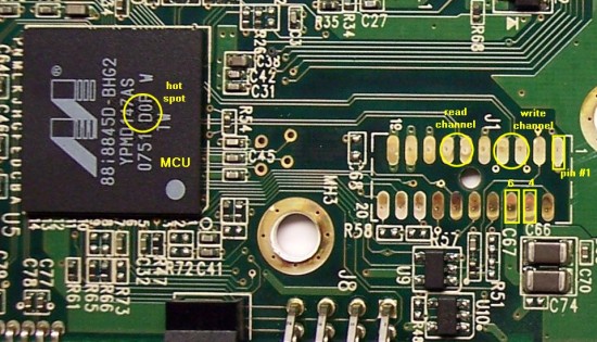

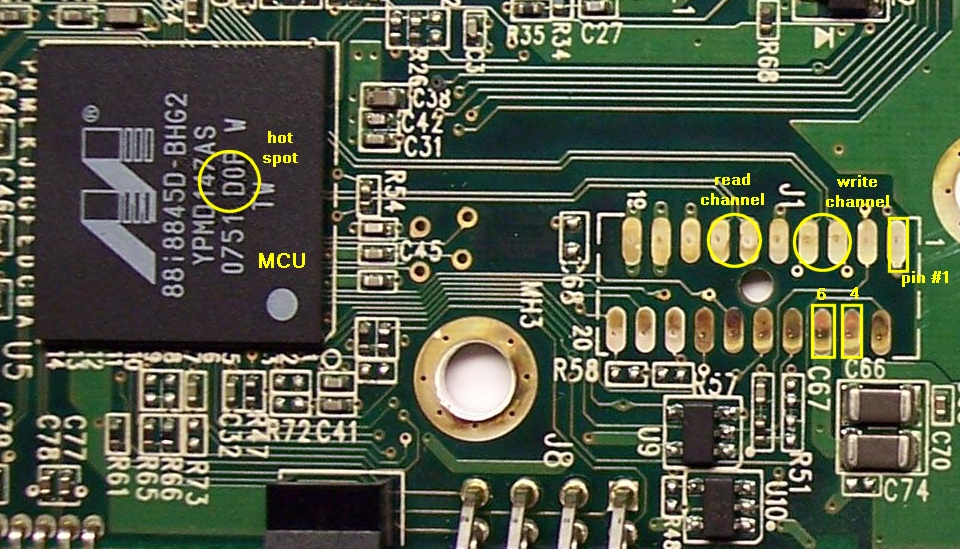

@Jidis, I was originally thinking along the same lines as Spildit. Tornado drives suffer from "head mimic" faults where a bad MCU produces the same symptoms as bad heads. However, in the Tornado case the MCU is an 88i6745-TFJ1 or 88i6545-TFJ1 whereas your Pinclite's MCU is an 88i8845D-BHG2. That other thread should give you some hope, though.
Best of luck.
 Post subject: Re: What am I up against (clicking drive with amnesia)?
PostPosted: October 27th, 2018, 1:13
Posts: 17230

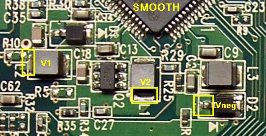

@Jidis, after you have safely backed up the embedded ROM, I wonder of you could measure the voltages in the following photoclips, namely V1, V2 and Vneg at the SMOOTH controller, and pins 1, 4, 6 and the read/write channel pins of the 20-pin HDA contacts. It would be interesting to compare these against a known good PCB.

Dumb question, but does all that stuff act the same and have the same voltages present with the mechanical half detached?

The Vneg voltage will probably come up and then immediately switch off, but that's normal when the PCB doesn't see the preamp (on the headstack). Otherwise V1 and V2 should be at their normal voltages. The read channel pins will not be at their usual level because they are driven by the preamp, but a comparison with a donor PCB may still be helpful. If you wish to measure the read channel voltages when the drive is running, then these are present at test points TV9 and TV10 on the underside of the PCB.

If there had been an overvoltage event, then the TVS diodes (D4 or D3) would have been shorted.

It could be a red herring, but the hot spot on the MCU is tantalisingly close to the R/W channel pins. It would be interesting to see whether working HDDs have the same hot spot in the foam. If so, then this might be indicative of thermal problems that result in progressive, rather than sudden, failure.
