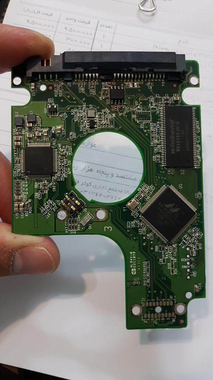

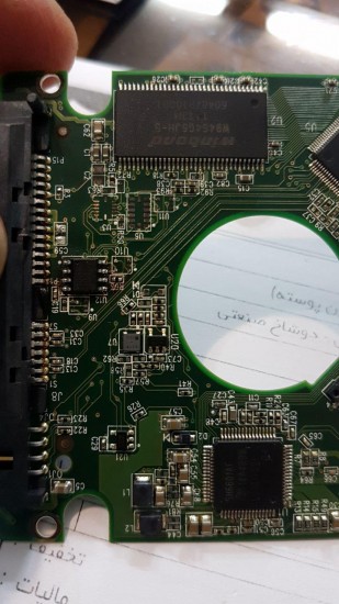

hi everybody:
HDD 320 PCB Western Digital Does not work .here are some pics about the PCB.
i change the PCB with a Correct one and change also the Bios but head click and does not run.MRT detect ROM but head already click.

Dear sir:
thanks for your reply .
We Checked everything with MRT machin,it doesn't seem a matter of firmware or something like this.
with a similar PCB head does not click,but stop after some moment.
thanks for your care.

thanks again:
on the original PCB ,can you give some advice about the path or if any damage that of high voltage happend ,where van i find it.
it doesn't start at all .at the first step ,there was a drive dead PCB.it is proven by the machine.
with the new board ROM is detected and ok , why is it clicking.

Heads are gone, need to change in cleanroom.
NOT a pcb problem.

It is convenient that when you put the case of the exact model of HDD. Also if you have the MRT you can put a screenshot when the MRT detects the HDD.
It seems that it is a problem of heads as the comrades say, but the more information more details you can help diagnose the case.
