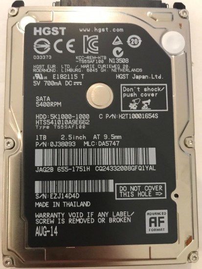

Hi All,

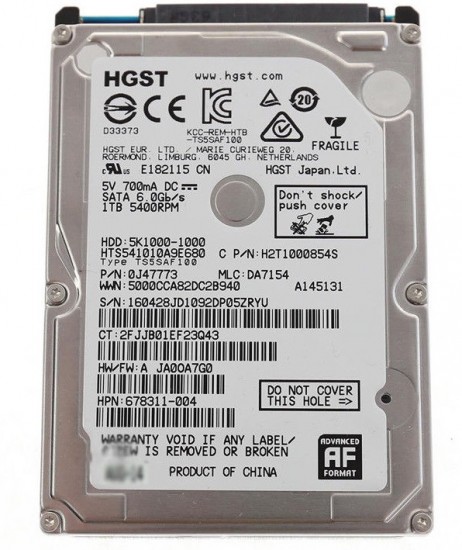

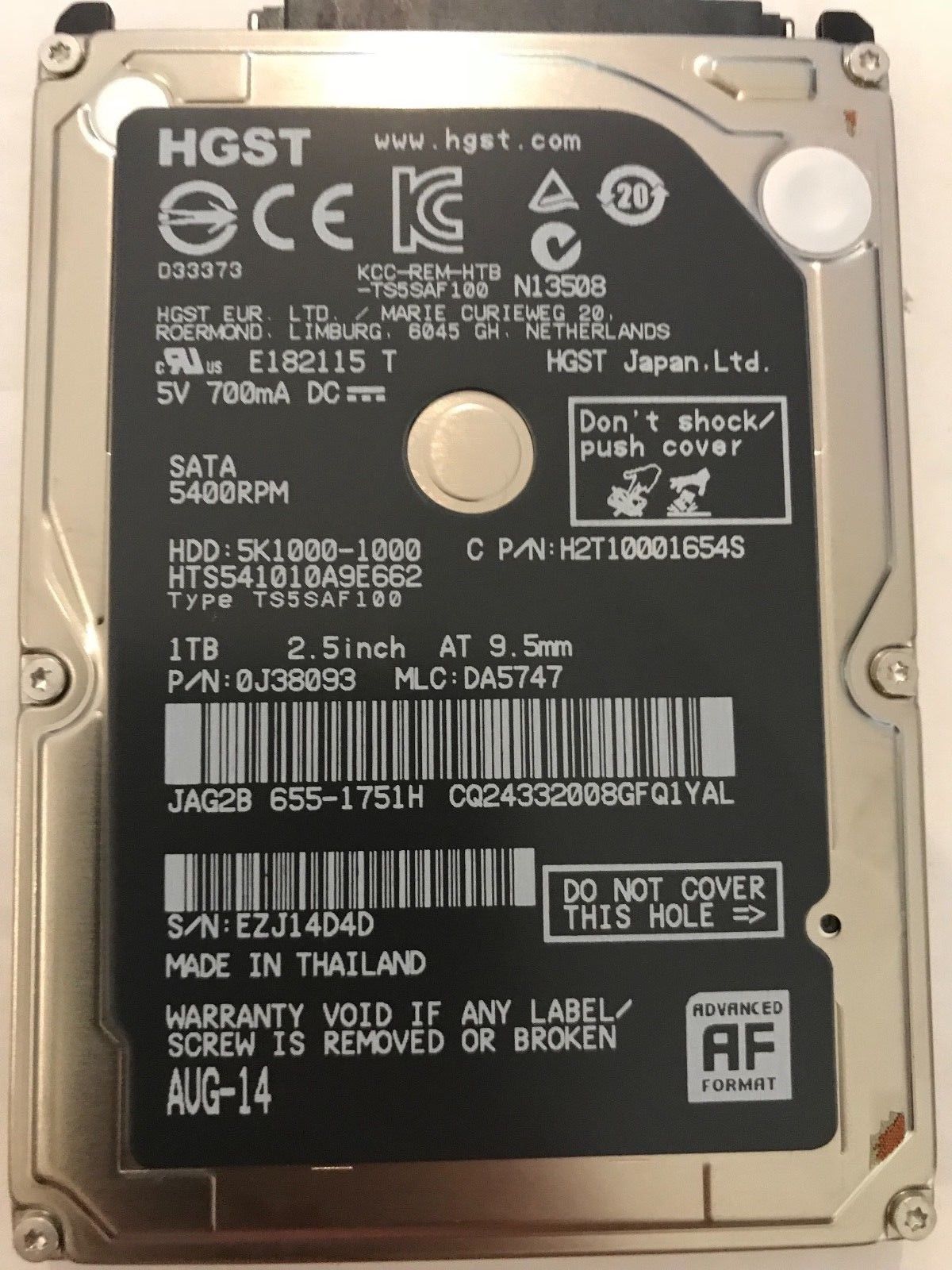

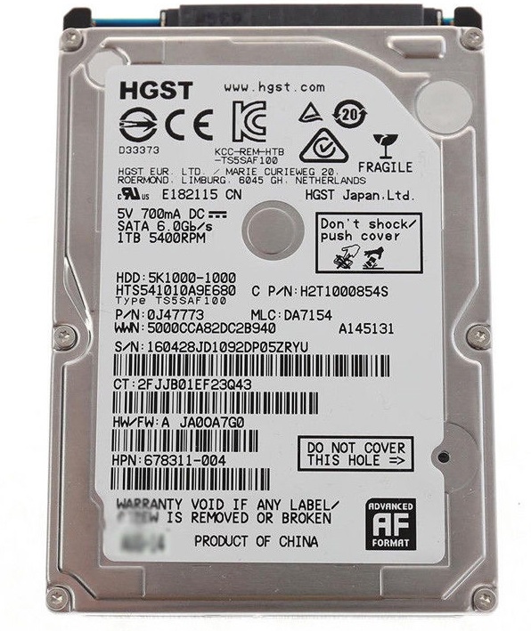

I've got one of these 2.5 5400rpm 1TB HGST HDDs:
HGST HDD 5K1000-1000 HTS541010A9E680 FW:560
Unfortunately the SATA speed restriction is not supported in FTOOL.
I would like to limit the auto-negotiated speeds to SATAII, instead of the current SATAIII as my 2011 Early Macbook Pro struggles with SATAIII in the optibay adapter (known issue https://forums.macrumors.com/threads/1tb-hdd-early-2011-macbook-pro.1584023/).
Since there is a reduced speed version of this under HTS541010A9E662 to SATAII, is there a way to restrict the controller on mine?
If so, please could you advise what equipment I would need to perform the changes necessary?
File comment: SATA2
File comment: SATA3

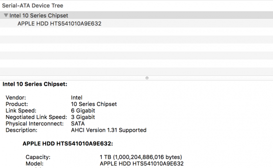

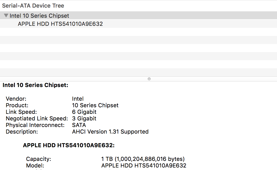

Perhaps could have uploaded a better image about the "black label" version of the 5K1000 1TB, here is a screen shot from MacOS showing that it only negotiates SATAII instead of SATAIII speeds within system info. This is HTS541010A9E632, while the one I have is HTS541010A9E680 (which negotiates SATAIII speeds instead causing an issue within the optibay).
Any help would be greatly appreciated.

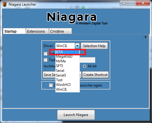

Dear Spildit,
Well spotted, that is exactly what the issue was here.
Unlike Snackmasterx's drives, mine (the bespoke HTS541010A9E680) gets recognized using STPI driver but do not communicate with the controller correctly.
In order to resolve this I had to try in "ATA drivers" instead when opening Niagara (screenshot attached) and all was good from that point.
Unsure if this is an outcome of the combination of my Mobo's controller/Intel and/or the HDD's controller itself though.
Please also see the log for further reference from Niagara:
autoloading package "Tk" ... OK
Starting CIL Base...CIL v4.3 Loaded
Creating UIL ata Driver...UIL creation success: 0: ata: v0.1.8: dev count=2
Creating serial driver...UIL creation success: 1: serial: v0.7.1: dev count=0
Creating serial3 driver...UIL creation success: 2: serial3: v0.7.1: dev count=0
Adding Serial Commands...INFO:: Devices found: 0Extension loaded successfully
Adding CDB Commands... File Parsed Successfully
Adding ATA Commands... File Parsed Successfully
Adding ATA VU Commands... File Parsed Successfully
Adding NVMe Commands... File Parsed Successfully
Adding NVMe Customer VU Commands... File Parsed Successfully
Loading startup files...
Loading tool files...
Loading pre-shasta serial files...
Loading custom Toolbelt configurations...
loading history file ... 1 events added
TCL console display active (Tcl8.6.5 / Tk8.6.5)
Loading pre-shasta files...
FE SC LL LM LH DH CM
CMD: 54 02 00 C7 A9 00 8F
RET: 00 00 00 00 00 00 50 Alt Status: 00
Success (153 ms) At 05:39:49 11/17/18
(uil=0:ata)(dev=0)>
Thank you for your help, now the drive's negotiating SATAII speeds only :) :lol: :lol: :lol:
