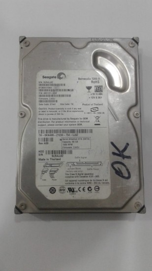

 Post subject: App Code incompatible SFL code
PostPosted: December 5th, 2018, 5:37
Joined: May 6th, 2013, 2:48
Posts: 84
Buzz - Interface task reset
4096k x 16 SDRAM
TONKA2 - 1_Disk M-31 03-22-06 10:53
4096k x 16 SDRAM
4096k x 16 SDRAM
4096k x 16 SDRAM
4096k x 16 SDRAM
Head Mask FFFF - Switch to full int.
Spin Ready
(P)SATA Reset
DiskAccess ReadSector EC=43 at ffffffff.00.0002
Read Ver Retrys
Read Ver Retrys
Read Ver Retrys
Read Ver Retrys
Read Ver Failure!
DiskAccess ReadSector EC=43 at ffffffff.00.022b
Failed sys sect. write! Nwt Er 00 RdWr 15d1c.00.022b
DiskAccess ReadSector EC=43 at ffffffff.00.0080
Unable To Load Overlay 01|000A
T>
Go to the Class F ......................OK
F>R1
R1
Buzz - Head Mask FFFF - Switch to full int.
Spin Ready
F>R2
R2
F>j,,22
ERR App Code incompatible SFL code
F>
