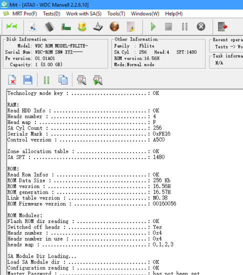

Are u sure ? so whats the other option for data recovery ? this is USB drive i changed board to SATA
In this drive i cant access data and without disable 411 I cant access to modules
I try to seek loader so module 411 and 1B successfully write but 11 with error and not helping.
this is the pic after disable 411

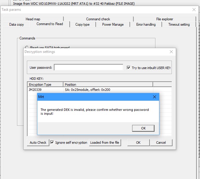

hi again when i try to decrypt in mrt this happened, I asked costumer and he say he didnt set password on hard, could it be for damaged module ?

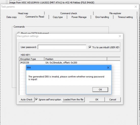

hi again when i try to decrypt in mrt this happened, I asked costumer and he say he didn't set password on hard, could it be for damaged module ?
