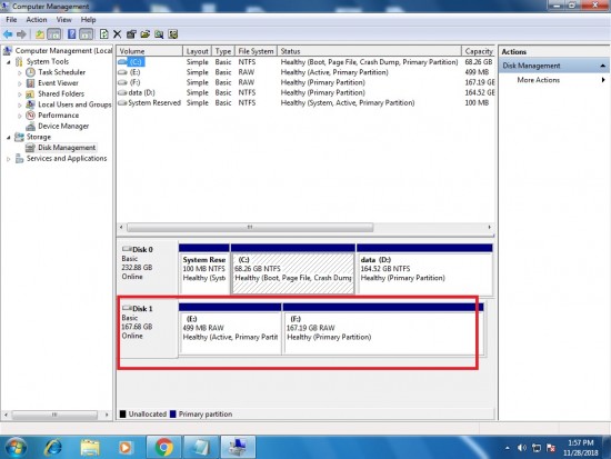

i have received a Think Pad T450 with Intel 180gb ssd original windows Corrupted & now the laptop contentiously restarting than i attach ssd to desktop computer . my computer show a raw partition.
please help how to recover a data.

Ask your client for the Key from AD without it forget it.
