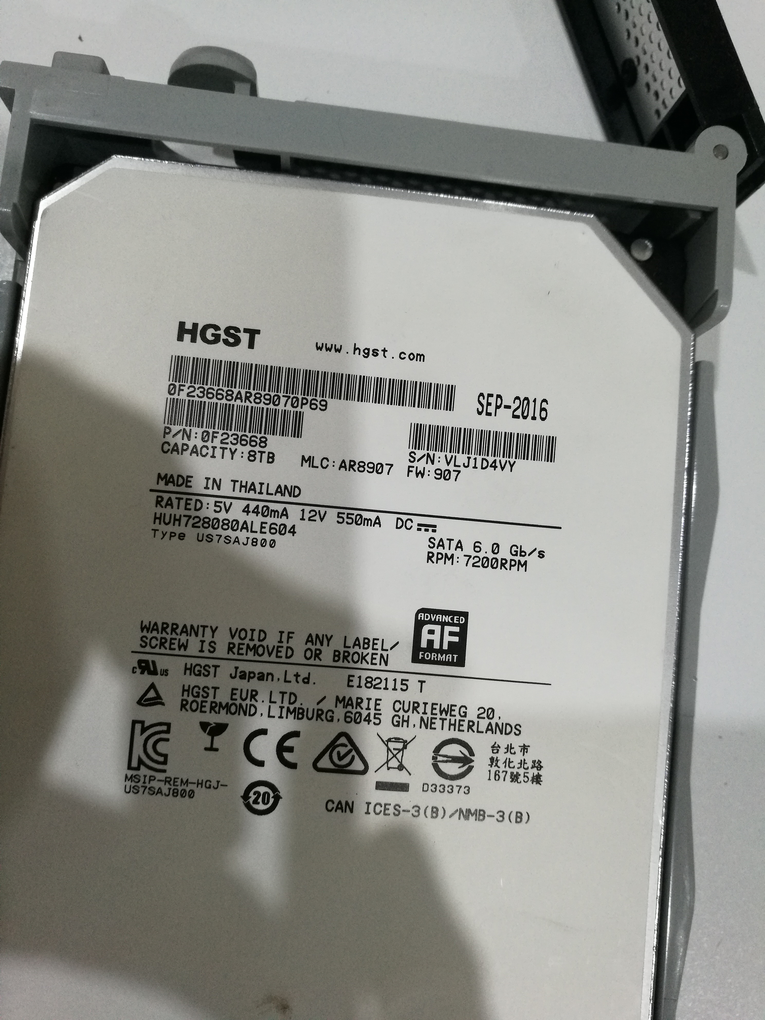

Dear experts,
I got a G-Speed Studio 32TB (4* 8TB) case with one drive issue (heads) typical mistake of RAID0
if anyone have an experience with such cases let me know by PM with the estimated time/cost for this case.
Hope someone here did work with those drives.
Thank you

More details about it just in case
