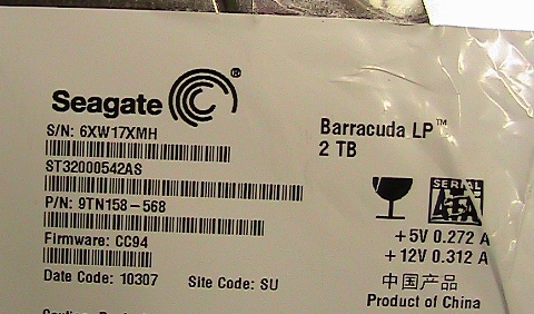

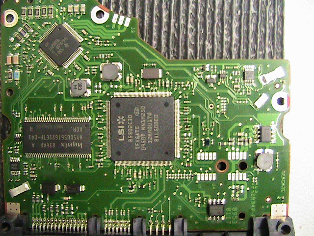

I have a problem with a Seagate Barracuda LP ST32000542AS firmware CC94,
I can not get into terminal mode with the command Crt + Z .. I think there is a short to do on the PCB ...
This disc seems to have problems with head ... But I tried to replace them with no positive results .... I think there are problems with firmware.
Can anyone help me?
Thank you and good day to all!

lulux69,
To answer your question about the shorting points:
If you look at the pre amp connection points on the PCB you will see a pair of tracks going to the right side of the LSI chip.
Follow the pair of tracks from the preamp connections & you will see 2 test points. You will need to see where they are on the otherside of the PCB.
Remember your accepting all the risks involved when trying DIY.
Loki

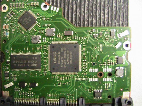

Hi Guys,
Can you help identify which one in the pic is the eeprom that needs to be transferred to the donor pcb?
Borrowing the pic of lulu69...

25XXXXX, maybe? cant's see clearly.
 Post subject: Re: roblems with Seagate Barracuda LP ST32000542AS.
PostPosted: September 7th, 2012, 1:56
Joined: September 7th, 2012, 1:40
Posts: 5
Location: Manila
the one on the right side has a 40113A number... the one at the bottom as winband 25xxxx
PostPosted: September 7th, 2012, 4:24
Posts: 1038
Location: South Africa
Winbond 25x
Data Recovery Cape Town
PostPosted: September 7th, 2012, 5:34
Joined: July 7th, 2010, 4:45
Posts: 924
Agreed
It's the (Winbond 25x) 8 legged chip near the bottom right on the photo.
Loki

Another question related to this.
I have an ST32000542AS which was working well, when one day it just suddenly died...no clicking... no spinning..nothing. I ordered a replacement PCB at donordrives.com ( I actually discovered this site through them) and then I replaced the pcb.
After replacing....Voila! it spinned, unfortunately, i then heard a clicking sound for a few seconds at the start up while it was spinning... the difference is that...it will click only on the start up then it will disappear...and the spinning will stop..
The same thing will happen if you power it off and on again...it will spin then click for a few seconds.....
Is this due to the incompatible ROM? or is the head already damaged?
PostPosted: September 7th, 2012, 12:25
Yes, incompatible ROM. Have to resolve PCB issue and then test the heads to find if heads are a problem as well.
PostPosted: September 7th, 2012, 12:28
Posts: 339
Did you order PCB with ROM transfer or without?
Edit: I see labtech was first.
PostPosted: September 7th, 2012, 12:39
Posts: 5
Location: Manila
without sir, i just ordered a donor pcb, I was hoping it would not need a ROM transfer anymore. Besides the site is US based while I am in Asia so it will take weeks or months if I will ship the hard drive back and forth
PostPosted: September 7th, 2012, 13:15
Joined: May 21st, 2007, 16:10
Posts: 1592
Location: Gothenburg/ Sweden
Then you need to transfer Rom aswell
http://www.rescue-it.se
PostPosted: September 9th, 2012, 0:58
Posts: 5
Location: Manila
Guys....i would like to say thank you all for the great help...you have just saved my ass....i was able to recover the whole 2TB HDD! thank you all!!
