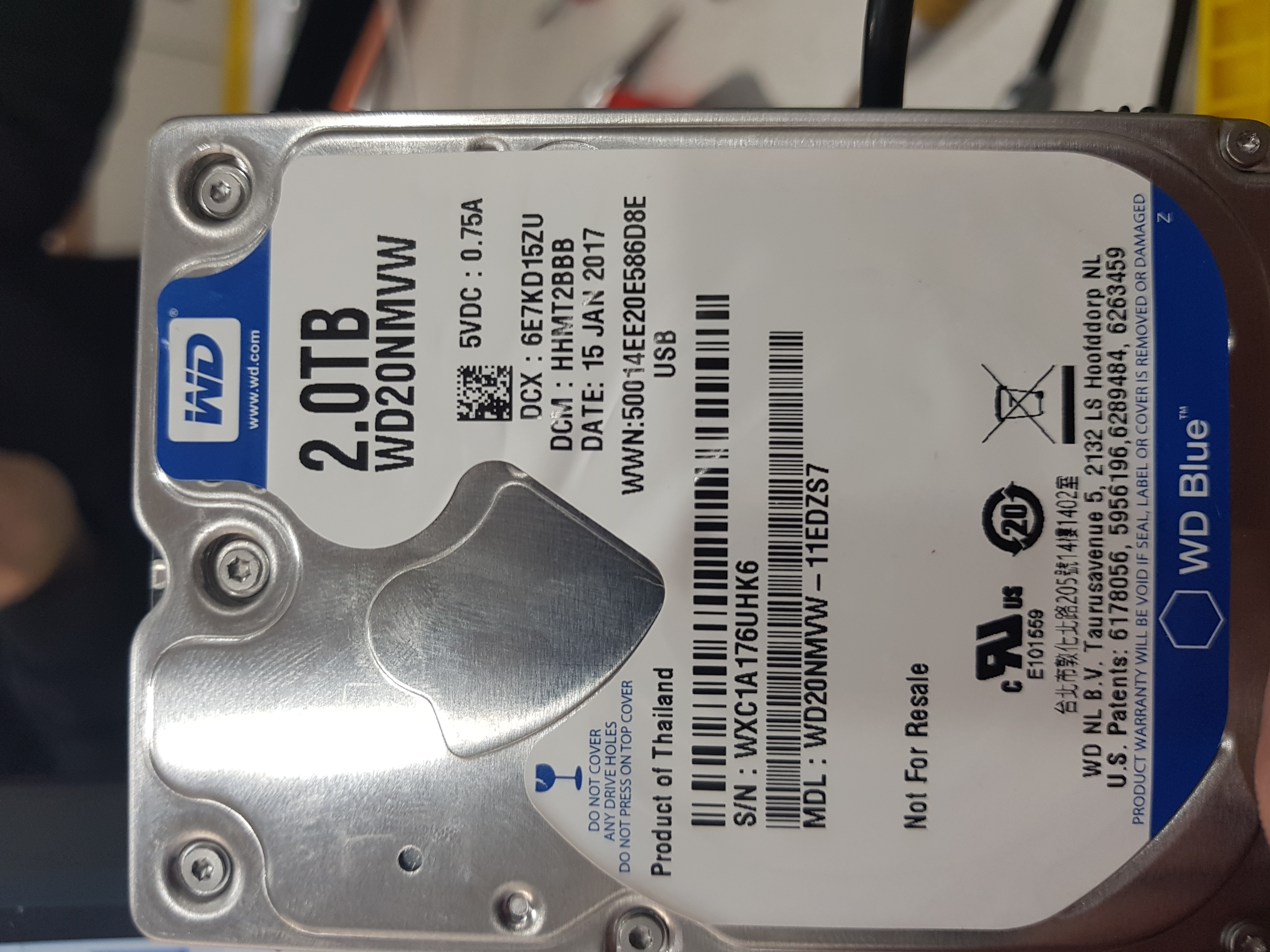

WD20nmvw 2tb drive has one click ever 15sec no plater damage can't get a read

Heads issue - very common. Possible firmware problems, as well.

Ha guys cheers na this was a board issue one of the caps was poopped I think it could have been little water damage cheers for help

Weird.. but glad it was sorted out. By the way, the suggestion above was obviously given based on the fact that the PCB had been ruled as good.
