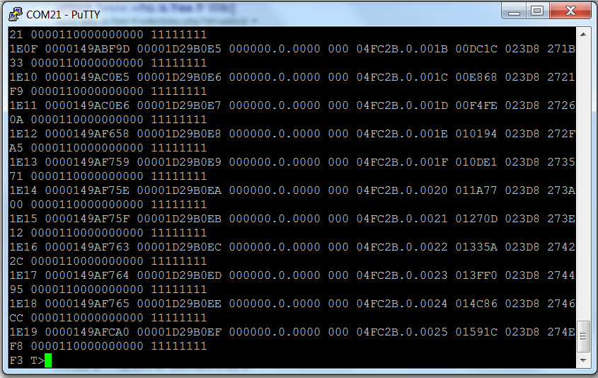

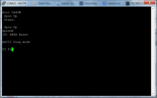

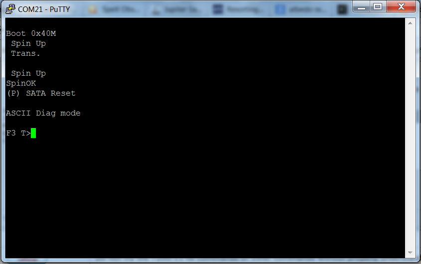

After extensively reading this forum and posting in various threads, I try to collect in this post what I have learned about a faulty Seagate 7200.14 HDDs so far:
- It has a low voltage TTL serial interface (1.8 V). A Silicon Labs CP2104 USB-UART converter works flawlessly. Alternative is a Prolific PL-2303H with a TTL level shifter (or modified accordingly).
- CTRL-Z gets me to the F3 T> command prompt. I found a list of commands for the F3 prompt of a 7200.12 HDD in this forum that I attach here. One user reported that the command library has not changed on the 7200.14, and another user started diagnosing the very same harddrive using these commands, so this encouraged me to do the same.

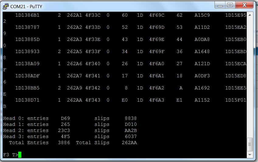

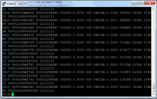

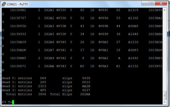

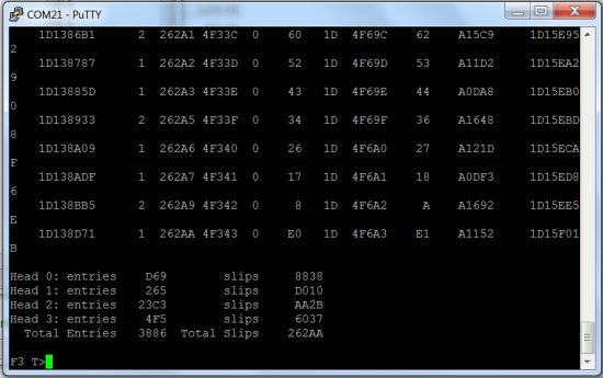

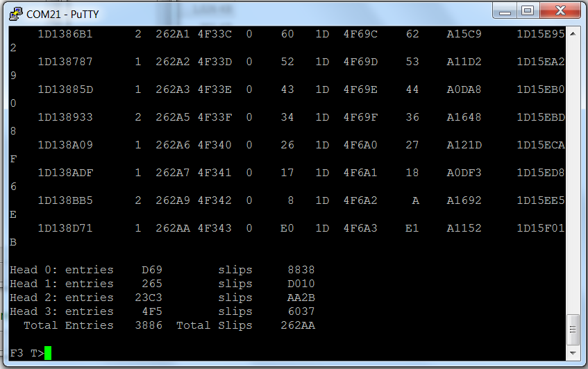

The only diagnostic commands that I used so far and that worked are (see screenshots of the terminal output attached):
Level T - V1, V3, V4, V40
Level 1 - N5
Level 2 - U, Z
Level 7 - X, D
I have not typed any other commands on the prompt yet.
The HDD reports extensive V1, V3 and V4 lists, but apparently no stored SMART data (all values are 0, except one that is 3). V40 gives an empty "non-resident G-List". X gives me the preamp head resistance, I can not assess if these values are healthy or not. D gives me a temperature of 35°C according to the resistance of the thermistor, neat but unuseful.
The HDD is not recognized by BIOS, which I do not understand. No strange sounds / clicking / etc.. Spins up / down just fine. No error messages on F3 prompt, terminal is responsive, does not hang up. If it is a bad sector problem why can I not get past BIOS?
