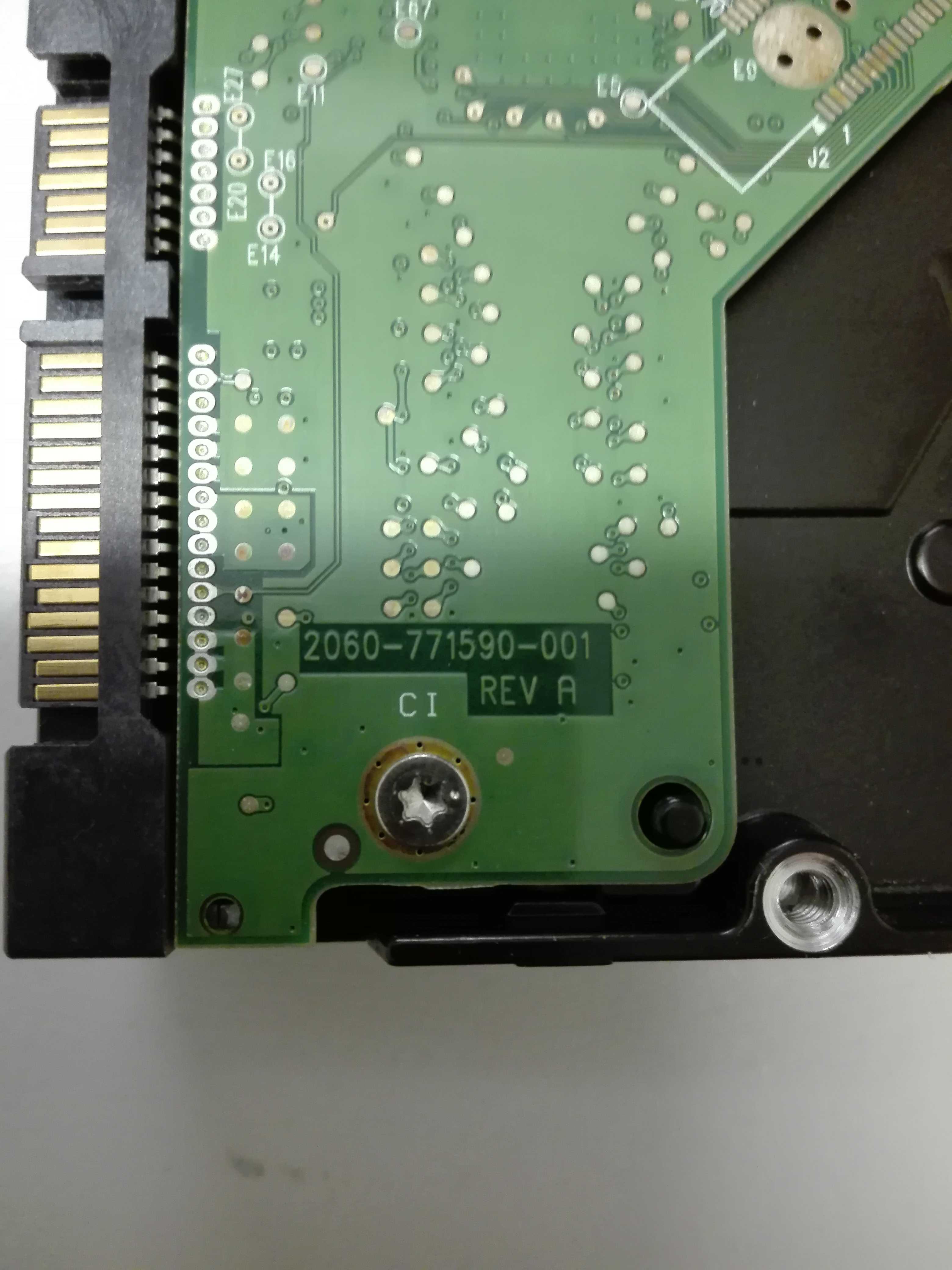

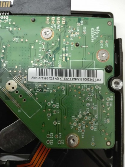

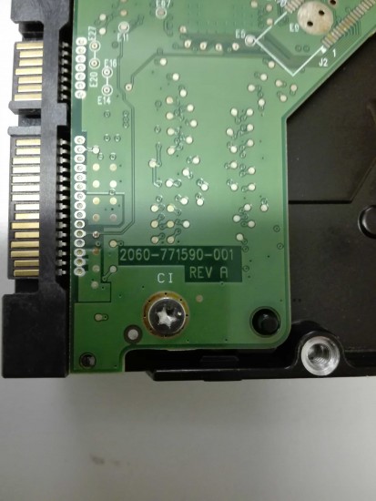

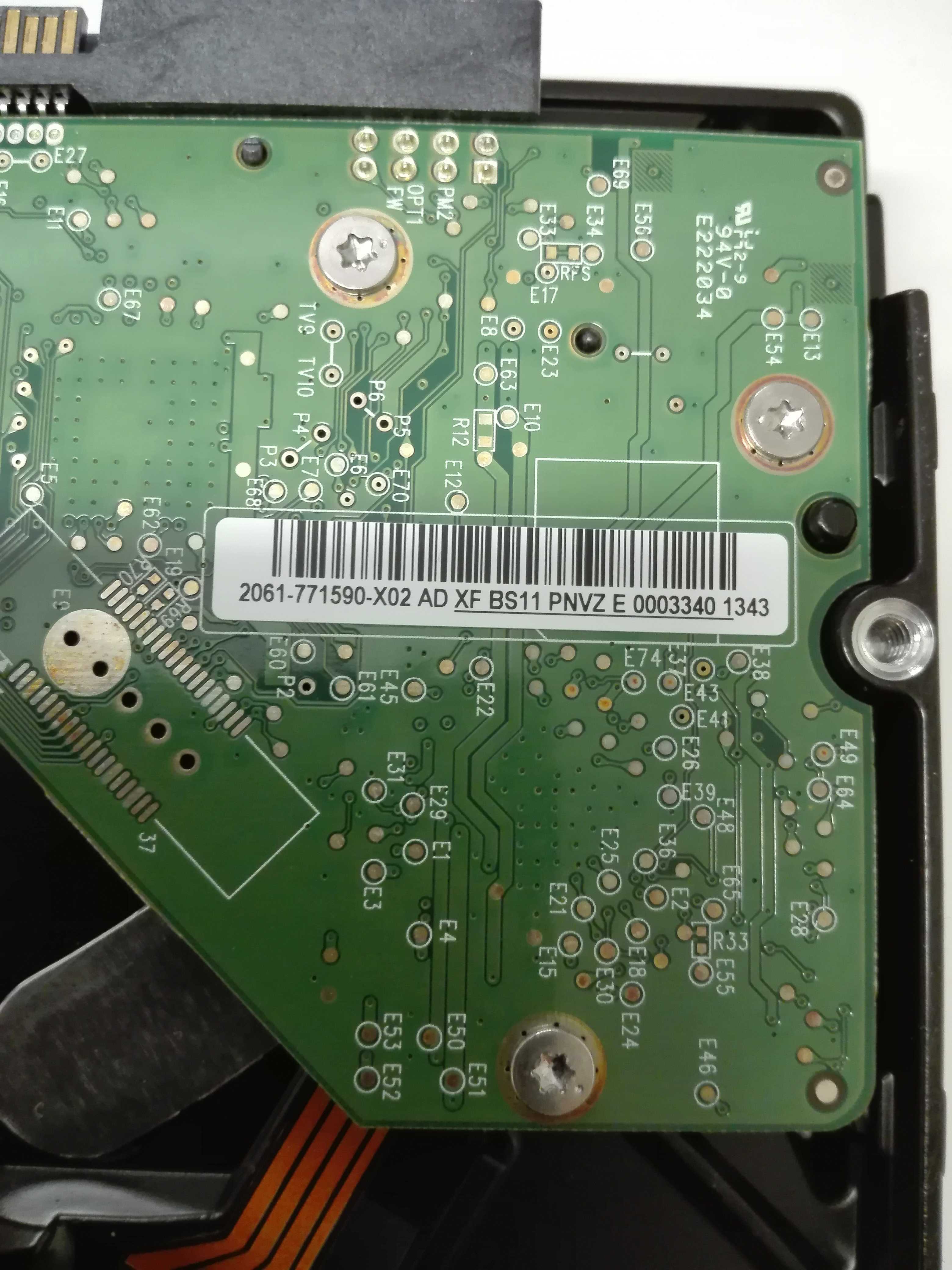

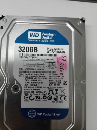

The HDD doesnt get recognized in OS.
When I apply power to the HDD without SATA Connection, the drive spins up and makes few clicking noises with pause, then again few clicking noises. Then drive spins down.
When I connect to PC it spins up, makes clicking noise, pause, clicking noise, pause, and so on... Doesnt spin down....
I already checked TVS Diodes and 0Ohm resistors. I can see no damages on PCB.
I also cleaned Oxidized connectors.
Next I want to try to swap PCBs, so I ordered donor PCB from Ebay:
https://www.ebay.de/itm/Hard-Disk-HDD-P ... 2749.l2649
It has exact same Partnumber, but comes from an WD2500AAJS drive.
Is it enough when I swap U12 ROM?
Is there anything else I can do?
The HDD already had a few bad sectors before it completely went dead... I checked with SMART Tool....
The Data isnt THAT important to me... I try it just for "fun". :)
Thanks!!!

 Post subject: Re: WD3200AAJS-00L7A0 Recovery
PostPosted: November 22nd, 2018, 16:17
Posts: 17266
Yes, but don't get your hopes up. :-(
PostPosted: November 22nd, 2018, 16:42
Spildit wrote:
Then most likely the PCB is ok and the problem is with bad head(s) and/or pre-amp.
The drive does need clean room service and it's not DO-IT-YOURSELF ...
Sorry.
Absolutely right, it’s less than 0.1% chance it’s PCB on this model.
Most of the time the heads are bad and/or damaged on these, and the more you power it up the more damage you are doing, letting the damaged heads scrape the platters.
We have seen loads of these with heads mangled and/or broken off, often after a power outage.
Normally damaged heads are caused by physical force, but we’ve seen so many of these from desktop PC’s with the clients swearing blind it’s not been knocked that we are of the opinion there’s some issue with the heads dismounting mechanism.
If your data is important then PLEASE STOP killing this drive and seek pro assistance.

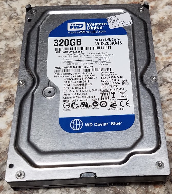

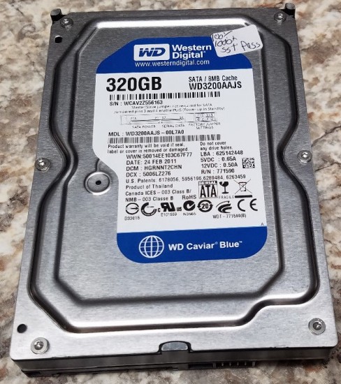

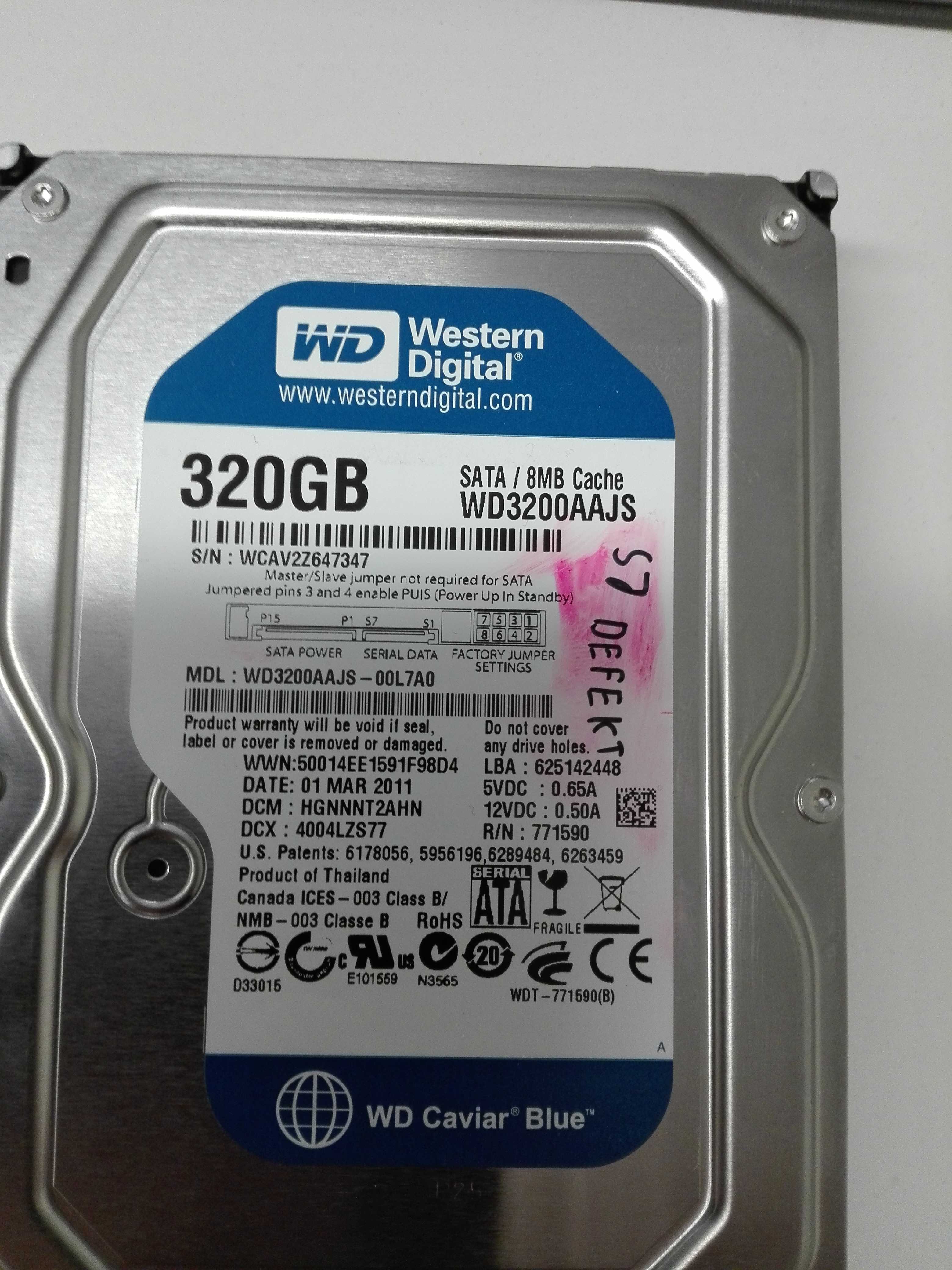

Then I will try Head Stack Swap for Fun. :P
I have access to an laminar flow box at work.
I think I already found a good donor on ebay.
