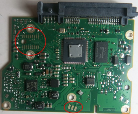

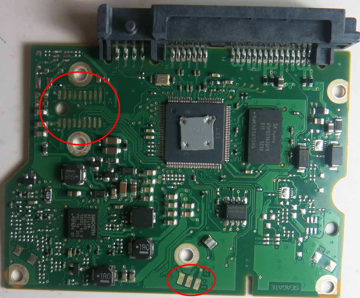

I used a picture from hddrecovery.com and circled the areas I blocked with a piece of card stock (not at the same time, obviously). In both cases, it still made the noise.
ETA: I decided to try the PCB off the assembly and darned if that sound isn't coming from the PCB itself. That's not normal, is it? I only tinker around with 2.5" drives and I've never heard that from the board. Blown circuit, maybe? But the good board does the same thing...
The board seems to send proper power. 12v and 5v at the diodes and 1.5v to the 3 motor connections.

If you hear high frequency sound coming from pcb, it might be due to some voice coils fault on the board.
My firmware database:
 Post subject: Re: ST1000DM003 Completely Dead
PostPosted: December 13th, 2018, 8:20
Posts: 1768
Location: Verona, Italy
If you hear some other kind of noise coming from pcb, then it might be some bad component near sata power connector as capacitors.
Can you post your real pcb pic in high definition?

I tried taking some photos with my phone. All I got was a poorly-lit, blurry mess. As I said in the OP, I managed to find a drive with the same PN and FW because I initially thought it was the PCB. It's a fully functional drive that I managed to get for the same price as people wanted for a PCB. The good board does the same thing. Other than the noise, the bad drive is completely dead. Not a beep, a click or a whir from the HDA, even with the good board.
I suspect the boards themselves are fine, but there are multiple problems with the HDA itself. It's the only thing I can think of. The motor is getting juice, but makes no attempt to spin. It doesn't seem to heat up if left powered for a length of time. The drive was fine when I put it away. I mean, I don't know. There has to be something up with the motor for it to be completely dead if it's getting power. Perhaps one of the leads is burnt off inside near the motor. That seems far-fetched but I'm at a loss.
