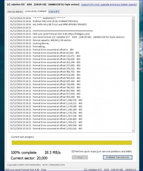

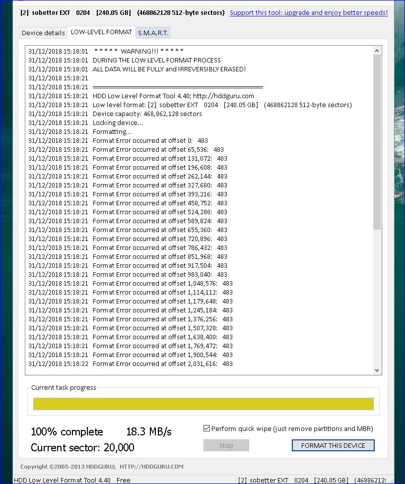

 Post subject: Re: Low level format problem with Transcend pHDD 2.5" 320GB
PostPosted: December 31st, 2018, 11:21
Joined: December 31st, 2018, 8:52
its a cyclic redundancy check error? causing HDD Low Level Format Tool to show Format error occurred at offset at *********** 483
