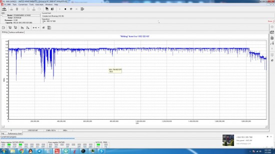

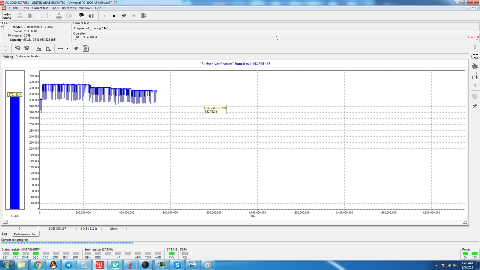

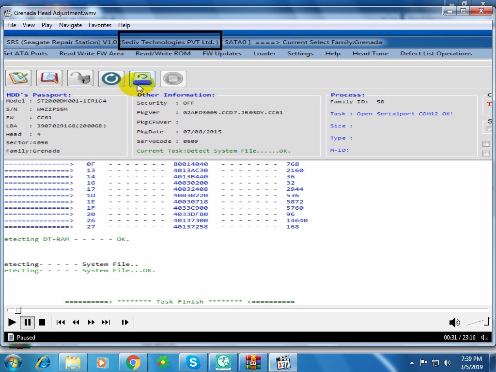

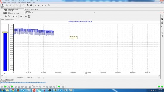

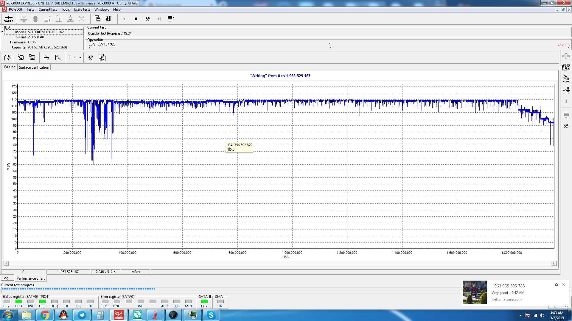

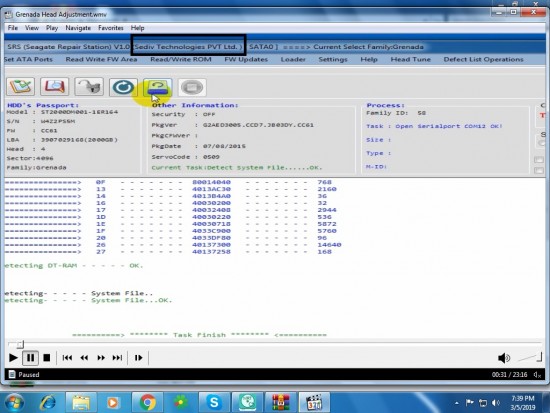

Hi Every body.
Grenada/ Bacall Moose, pharaoh, moose, and many more families Head adjustment for Repair in the video.
For Data Recovery the method is same, but the commands are different.
http://www.mediafire.com/file/67l4sdkla ... nt.7z/file
after write test finish.
Reading test is in process

Here is the condition, you can run AFH adjust only on the drives where 1 head is stop reading, or reading extremely slow like 1 MB or less then that.
its not only AFH. in video there is DAC, AFH ,RW. some hidden area cannot b visible in the screen, because size become big.
The video is related to repairing of Drive only.
If you wana see the Real Data recovery case, i can show you the case, with a video. and it works perfect.
Many poeple of forum already done this method on there DR Cases, and get good result.
This only work on drives having 1 or 2 head week, slow speed of reading like less then 1 MB.
If some one thinking it work on clicking drive, he is a fool.
Hi fzabkar
"Do Seagate's helium drives still use F3 architecture? If so, then this technique may be the only option in some cases (for some shops).
I wonder if anyone who has been successful with this procedure has reverted to the original adaptives and then retested the bad head. I'm wondering whether a "touchdown" on the platter may clean a dirty head."
Basically i am doing this on drives below , like Grenada, bacall, muskies, muskie plus, moose, pharaoh, brinks, yarrar_5400, yarrarX, etc families,
which we get in my lab for repair.
i have not saw a seagate helium filed drive in my lab for repair hehe.
Yes many person of the forum get success with this, i have done on remote for them.
but if an un-experience person touch AFH and DAC and RW, offcouse he will damage it. because there is certain limit of adjustment, once you cross that limit, after that Heads become Dead.
i am doing this by CHS mode, and its the real result.
i am set the timeout to minimum with Command. and then do a CHS test, for repair Write/ Read CHS test to compare the performance.
Once it repaired the task will stop, if it was not repair or left any zone no-repaired, then program automatic moved to Zone cutting, and cut the faulty zones of a drive in repairing process.
in the post i have written its a Repairing purpose video.
You can use this trick in Data Recovery but only by Reading CHS and adjust, again read and adjust. in software there is section for manually editing all Adaptives.
1. DAC
2. AFH
3. RW
any once can adjust manually. in all this what section have to adjust, its a question. every drive have different parameters.
There is always a formula to adjust the AFH, DAC, RW.

For Example you have Grenada drive with 2 heads. you fully clone its head 0 with a speed of 1230 MB/s , but when you start reading from head 1 the speed is less then 1 MB or show a lot of skip Sectors.
In that conditions you have to Adjust DAC, and don't touch AFH.
For Adjusting the Values , this is a limit , what to increase.
have 4 Sections
1. WrCur
2. WrDamp
3. WrDampDur
4. HtRng
these all 4 value's have there own means. what to increase and how many times. it depends. on the Read and Write value.
For Data Recovery just Increase it to Max value of first section .
1 by 4th value on second section
1 by 3rd value on third section
and max value to last section
this will work for Grenada drive.
