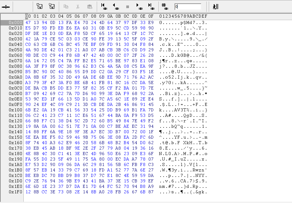

I got a Seagate constellation ES 2TB with board issue , i replaced the pcb with rom swap. now is the hdd is detected but it shows no partition . when tried scanning in R-studio no files were found.
When i see the 0 sector it shows as pic attached.
is it some sort of encryption ? i asked the customer whether he used any encyption he says no.
looking for suggestion

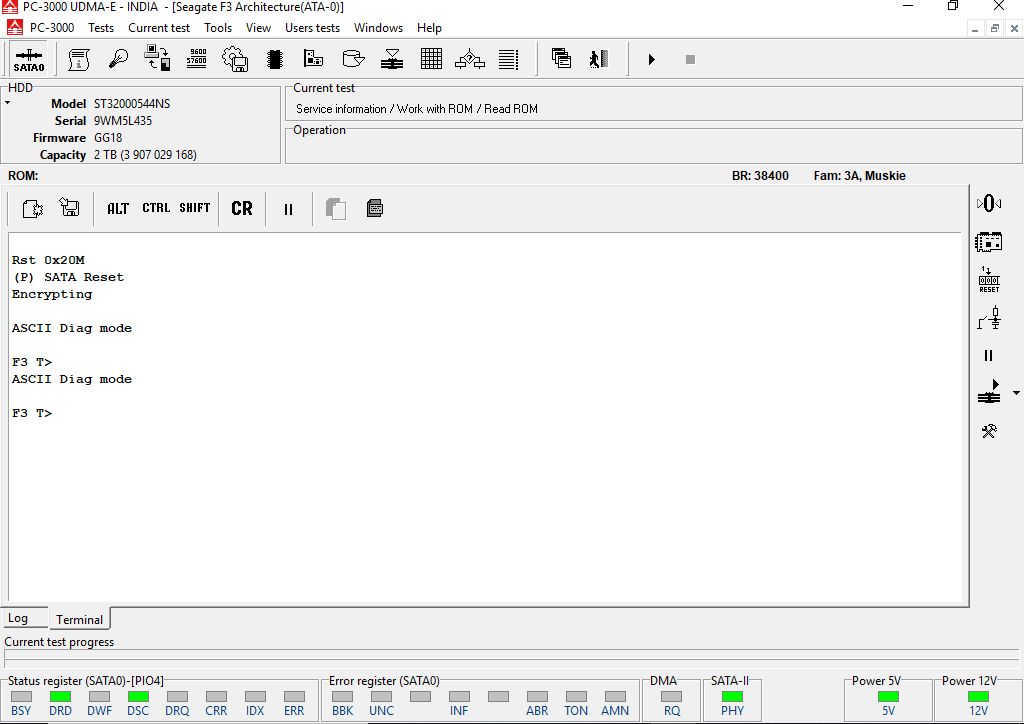

Maybe some clues, like what device the drive has been removed from?
 Post subject: Re: Seagate constellation ES 2TB
PostPosted: January 3rd, 2019, 4:14
Joined: June 6th, 2014, 11:19
Posts: 18
Drive was used in normal pc by photographer and when the drive is connected to the terminal it shows message encrypting in terminal.
pic attached below:
