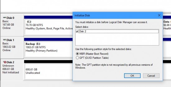

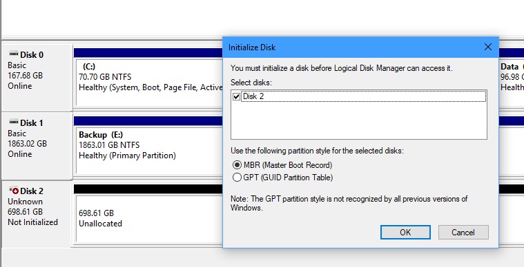

Hi
i have this drive with board# 771820 and i changed to 771814, now with MRT i can access to user area and SA and read and write modules, and in windows only recognized in device manager and partition management but its READ ONLY and can not create partitions,
any way to fix this problem ?
 Post subject: Re: Problem with turn change WD7500BVPT from SATA to USB
PostPosted: January 2nd, 2019, 5:24
Posts: 2857
Try from MRT to access any sector first then last sectors random check and see how it goes
if all OK and you don`t need your data inside, you may try:
from: Command prompt
diskpart
select disk 2 (as in your image example here)
clean
then try to open the disk manager and see
good luck

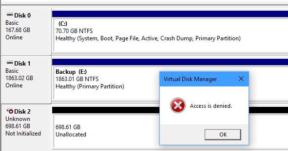

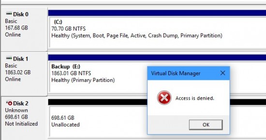

DiskPart succeeded in cleaning the disk.
but with this one has error :
create partition primary
DiskPart has encountered an error: Access is denied.
See the System Event Log for more information.
