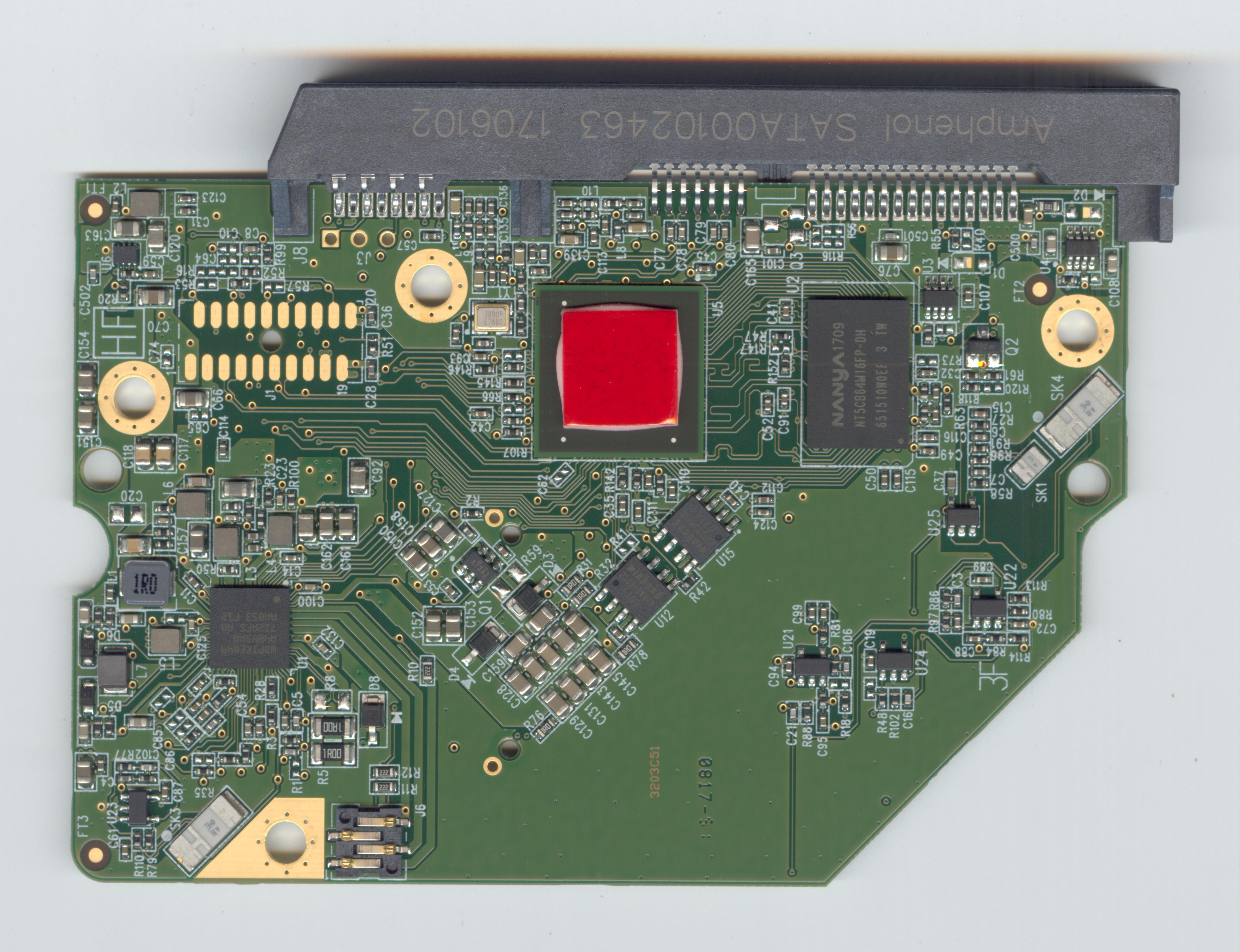

Anyone knows which fa,ily this WD gold belongs to
WD1005FBYZ-01YCBB2
thank you

Never saw those drives, could you upload the image of the PCB? (might be Hitachi)
I remember once i bought those "Enterprise" (Yellow/Black sticker) but because it was sealed pcb was not visible, it turns that the pcb was 701335 (i think) refub. drives
but were done very good (maybe by WD or others am not sure).
Thnx

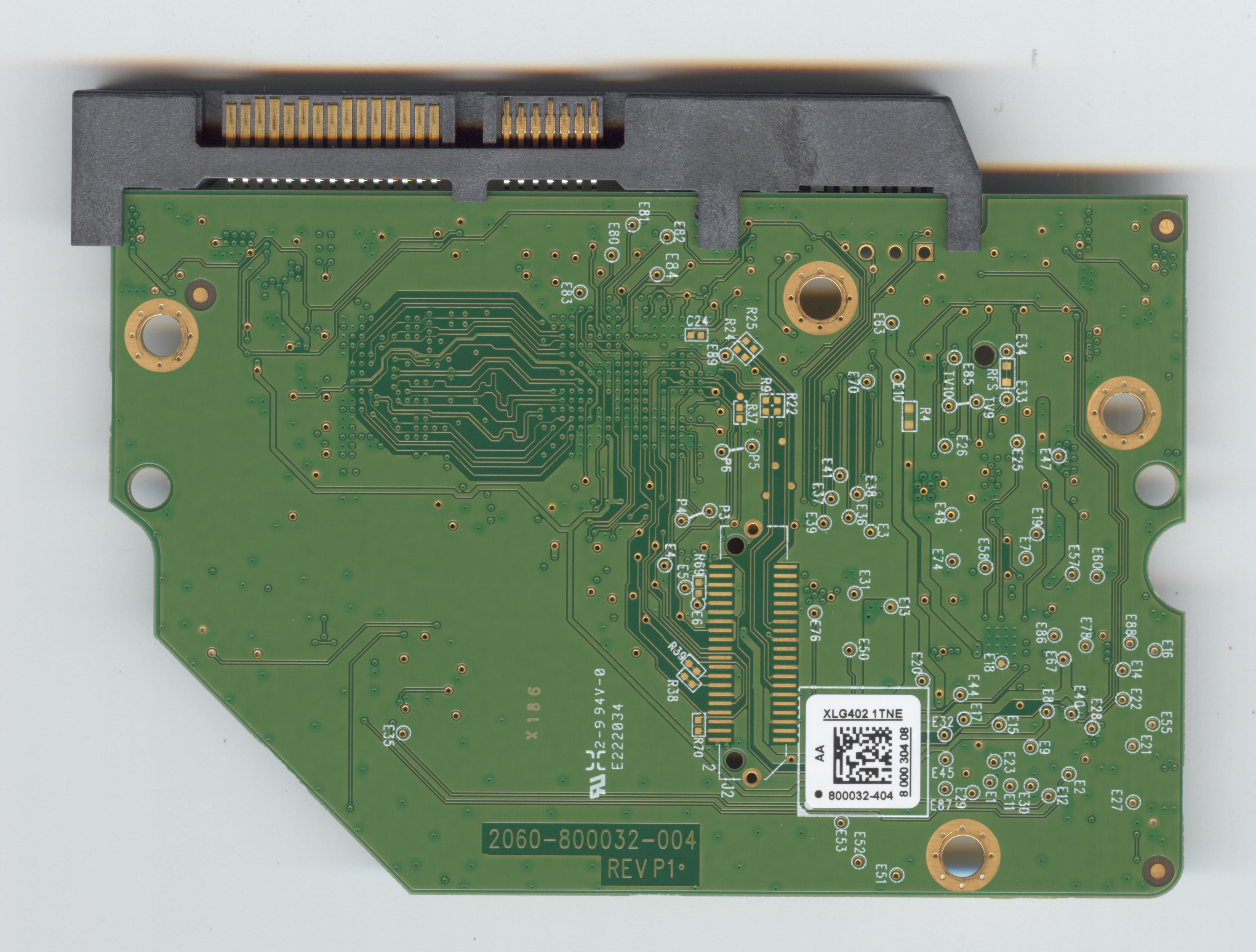

 Post subject: Re: WD1005FBYZ-01YCBB2 Fammily
PostPosted: January 2nd, 2019, 10:30
Joined: May 30th, 2005, 17:07
Posts: 550
This drive is not Apollo
https://wdmarvel.com/forum/ru/viewtopic ... 7c7#p16635
Mikippp
PostPosted: January 3rd, 2019, 9:29
Posts: 248
Location: SXSW
Mikippp wrote:
Thank you for the response, indeed is not Apollo, is a Rainier RE no support for this drives yet.
