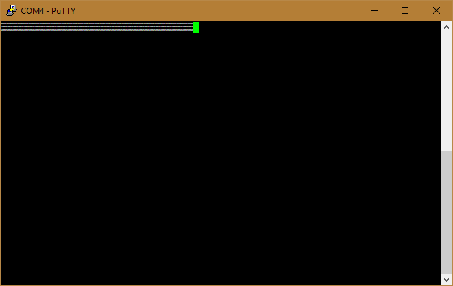

I have a ST1000DM003 (FW: CC47) that won't show up in BIOS or anywhere else it is plugged in.
I tried to connect it to my TTL adapter and if I wait 10-15 minutes when I press keys I then get odd garble for each key-press (CTRL+Z for example).
I tried another working ST1000DM003 (FW: CC62) I get the same behavior, no initial terminal output, then garble for each key-press.
File comment: One block of garble output per key-press.
When I try to connect these drives to a terminal, with a piece of paper blocking the head connector, both of them will spin up, then after 5-10 seconds the platters will stop receiving power.
Is there something with this model that needs to be done to get the terminal to work correctly?
I read somewhere that shorting the read channel can get the terminal to spring to life, would that apply in my particular case?
As a sanity check I tried a ST3250318AS (FW: CC6B) and the terminal, with the standard commands, works perfectly so I know it isn't my TTL adapter.
When I connect this working drive it will spin up and stay that way until I provide CTRL+Z, as expected.
This leads me to believe that the terminal for the ST1000DM003 is just broken/different in some way.
Thoughts?

Measure the voltages at the Tx & Rx pins of the HDD. If they are 1.8V LVTTL, then that could be the problem.

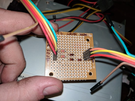

I am reading 1.8v between either TX/RX to GND.
Any ideas on how to work with this?
 Post subject: Re: Seagate ST1000DM003 No TTL Output
PostPosted: January 5th, 2019, 0:59
Posts: 17323
Try this Kindle level shifter:
https://www.mobileread.com/forums/showthread.php?p=1897643
PostPosted: January 5th, 2019, 4:27
Joined: January 4th, 2019, 21:30
Posts: 9
Location: Between my keyboard and chair

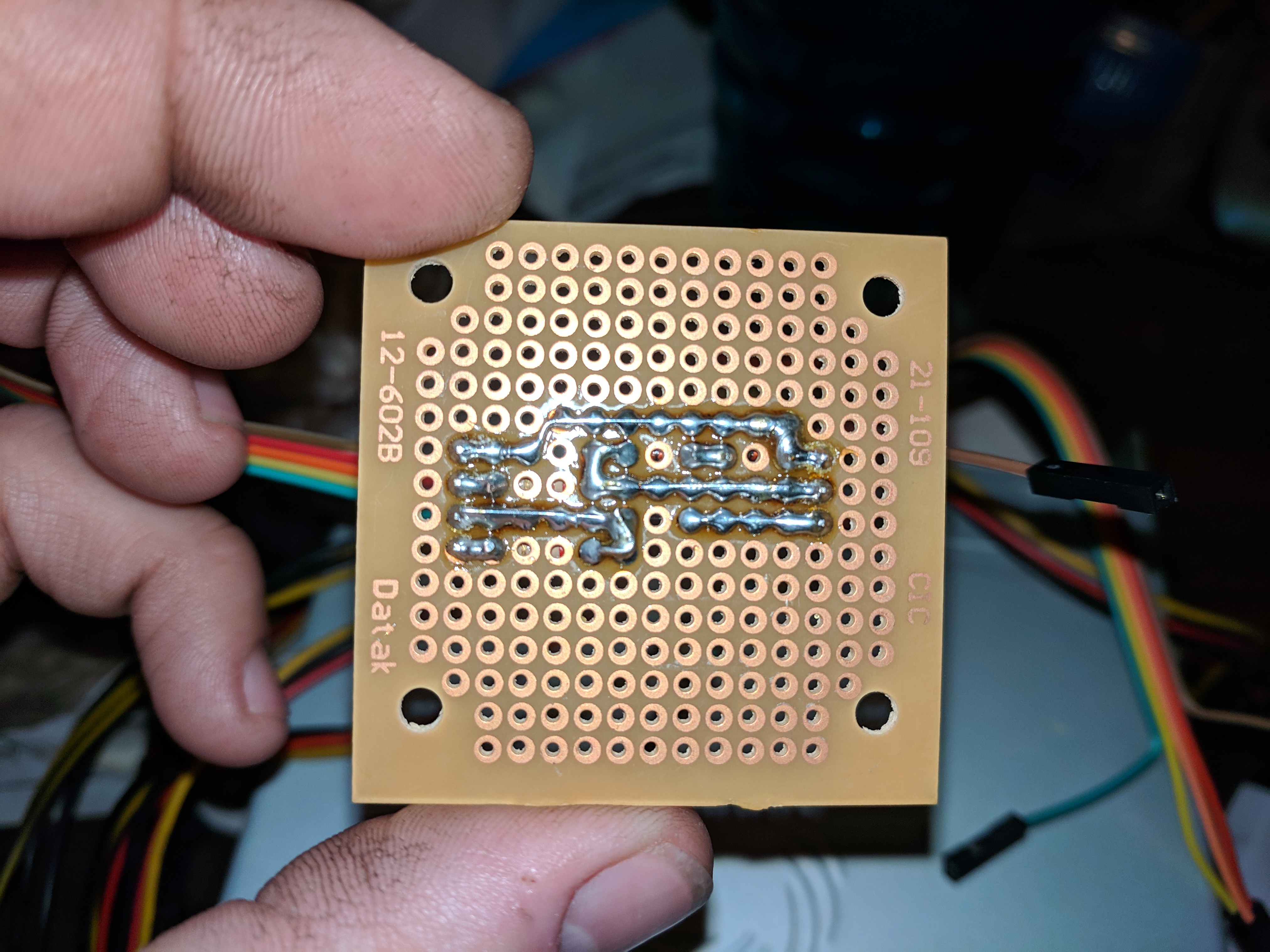

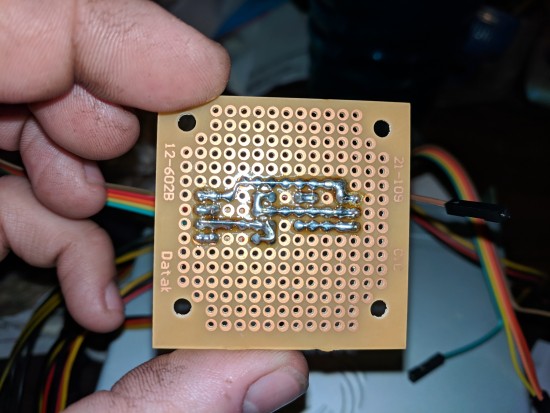

I made a level shifter from that link you provided and it works perfectly.
For reference I used 1N4148 diodes and 22K resisters.
File comment: Front side
File comment: Back side
Thanks!!
I will start another thread for the hard drive diagnostics should I have any trouble there.
