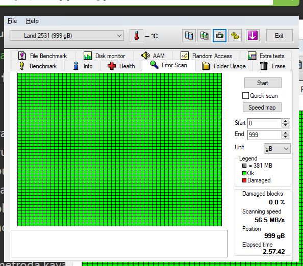

I've got continous I/O pop-up errors when I use this Toshiba HDD with qbittorrent. I quick-formatted the drive. It's the same.
I runned full scan with HD Tune. Its condition looks perfect. Zero Damaged red dots. It looks 381 mb grey dots. I don't know what it is.
Also another software Hard Disk Sentinel gives green arrows for healthy drives. But gives question marks for Toshiba.
I connected Seagate Drive and runned qbittorrent. I haven't got any errors.
Is that drive dead? What's the problem?

And what errors are you getting?

"An I/O Error occurred. Download is paused."
For all the torrents in the download list.

The problem was on the cable of the external HDD.
I replaced It. The problem solved.
