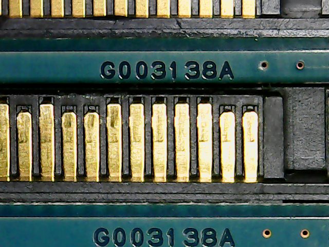

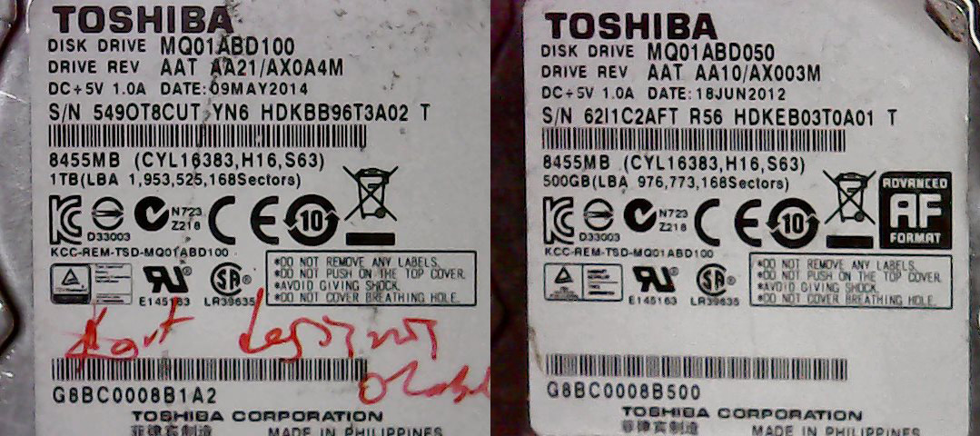

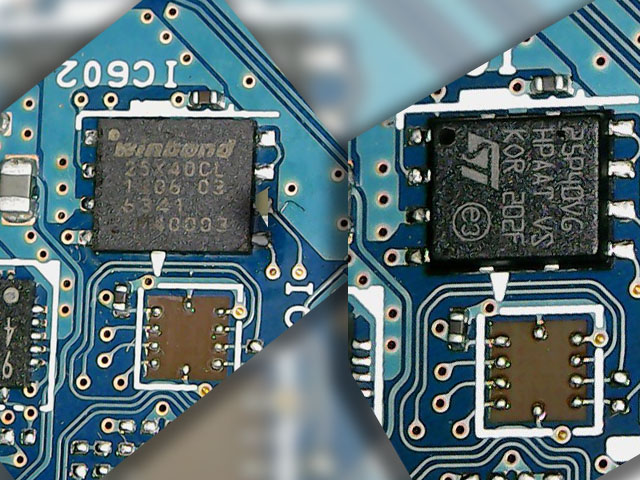

This PCB Hot Bios Swap working.
Tested
MQ1ABD050
MQ1ABD100
same PCB Number
diffrent brand Bios Chip .
Its compatable. Tested. Ok

I love Toshiba.
Allways nice 4 my recovery arrempt.
Toshiba hdd PCB match so eays . Don't look anything. Just match PCB number.
Mostly WD PCB also same.
