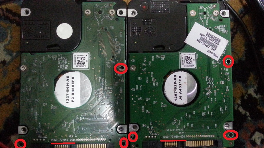

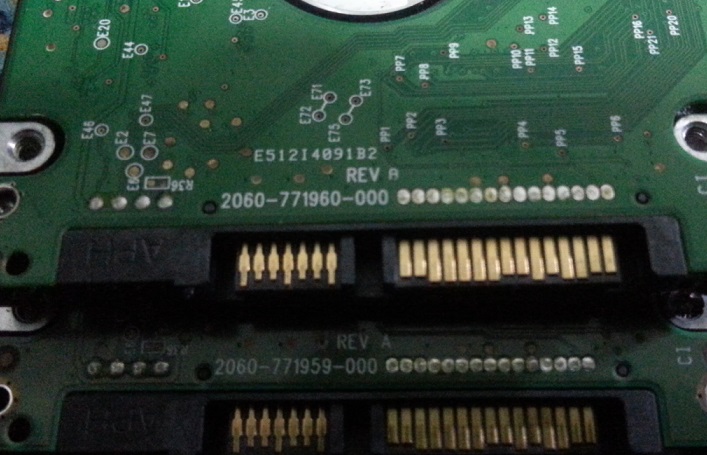

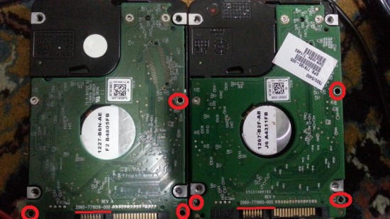

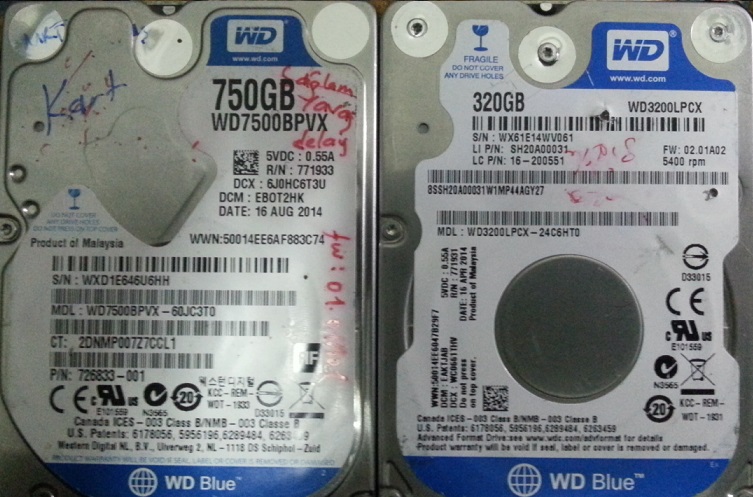

WD7500BPVX PCB match with WD3200LPCX LOL. Tested
Different PCB number.
:D :mrgreen: :mrgreen:
WD500BPVX PCB didn't work. I tested diods. Removed one. So it was died.
But pcb haven't work still.
I have swapped rom chip .
Now both working. Lol.
I have tested. Just 3 screw doesn't match ))
But it's working .
Hehee
I will add photos

I guess that's because the CPU's and motor controller chips are identical
